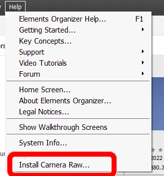

@cabat10_68, go to the Help menu and click on Install Camera Raw.  This will install ACR version 14.x which, as @John Waller has said, is sufficient to support your camera.
In an effort to reduce download file size, Elements 2023 now separates the components of the program and does a terrible job of letting users know about it.  I assume this is the case with you.
