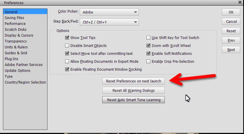

    I did not reset my preference from where they were pior to the retry. I will attach an image of the general page. These have not changed since install that I know of. They are different then the image you put up. Is one prferable to another ?
    As the name implies, preferences are a matter of personal preference.  Whenever I install a new version of Elements, I always enable Zoom with Scroll Wheel.  For me, that is the easiest way to zoom in and out of an image.  I also disable the default Enable Crop Pre-selection as I find it annoying.  But that's me!

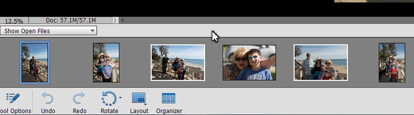

    I know nothing about Macs but hopefully, the following will help.  In the photo bin, the blue frame around a photo signifies the active image in the editing window.  You can select multiple photos in the bin by normal commands such as Cmd+Click or Shift+Click.  When a non-active image is selected, it will have a white frame around it.  In the following screenshot, the first, third and fifth images are selected with the first image being active in the editing window.

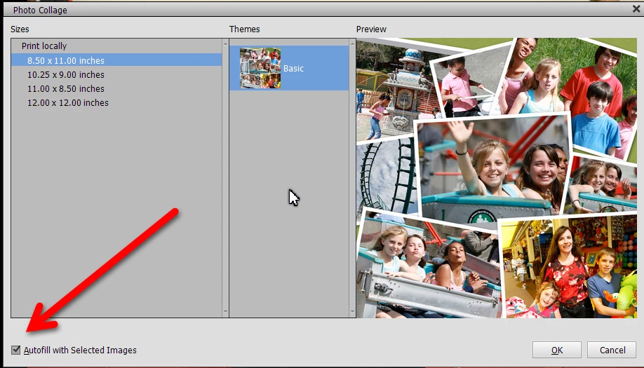

    If you want all of the photos in the bin to be included in the collage, make sure that in the Create>Photo Collage dialog, the box is checked to Autofill with selected images:
    If this does not populate the photo collage automatically for you, I would suggest resetting the preferences file.  (I'm assuming that Macs have a similar Preferences dialog as Windows):

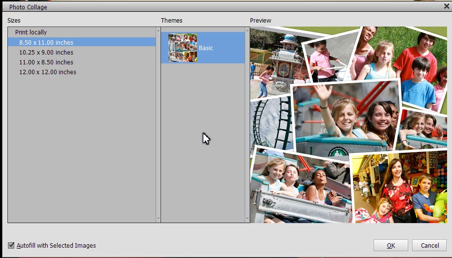

    When you have several photos in the photo bin and click create>photo collage, you should see a dialog something like this:

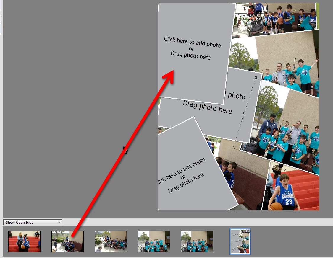

    Your installation should probably have more themes in it than the basic one that I have.  Not sure about that.  I haven't used Elements 15 in a while.  Once you click OK, the program will generate a collage using the photos in the bin.  If the theme has more images than are in the photo bin, there will be placeholders that you can click and browse for more photos.  If you want to replace a photo in the collage or add new photos from the bin, you can click and drag them to the placeholder:

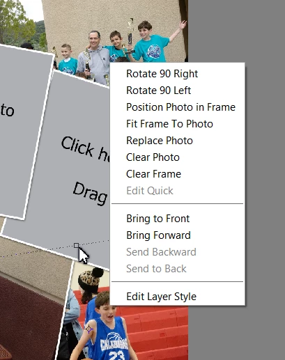

    If you right-click on an image in the collage, you will have several other context menu options:

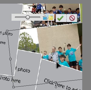

    Double-clicking an image in the collage also brings up a control for replacement of the image and also a zoom slider.
