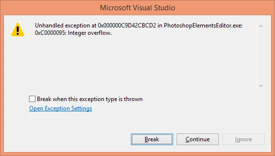

I happen to have VS2013 installed on my machine, so if I try to Debug it when it throws the Exception, I get:
Unhandled exception at 0x000000F61FCABCD2 in Adobe Photoshop Elements 15.0.exe: 0xC0000095: Integer overflow.
Which, in disassembly, looks like an integer division, most likely a division by zero?

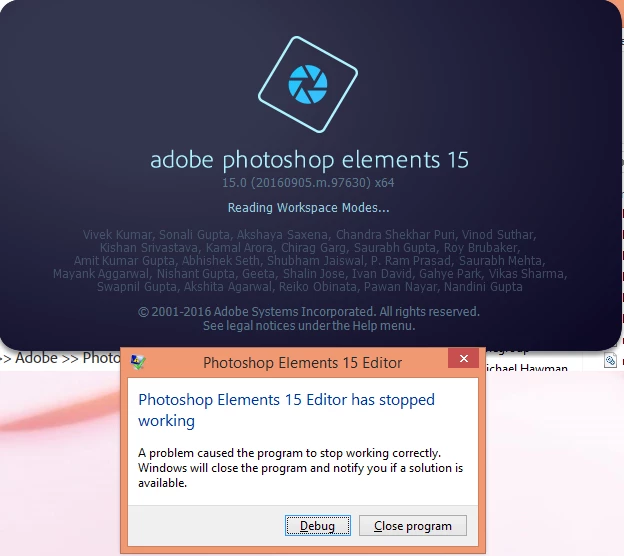

Since the faulting module is the welcome screen, I would try to open the editor directly.
Programmes >> Adobe >> Photoshop Elements 15 >> PhotoshopElementsEditor.exe
mikeh19924636
May 27, 2017
Thank you for the quick response!
That got a little further, I at least got a splash screen before it crashed, and the integer overflow happened in a different place
