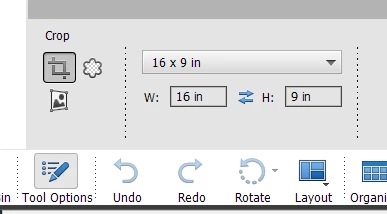

I'm going to disagree a little with Michel on this one, because the crop tool has a template size of 16x9 inches available.  Have you tried using it?
Michel's suggestion of using the rectangular marquee and the Crop command and his ingenious solution of using file templates are both worthy of consideration, but IMO take far more steps than the Crop tool.  And it is my understanding that using the Process Multiple Files tool does not suit your purposes.

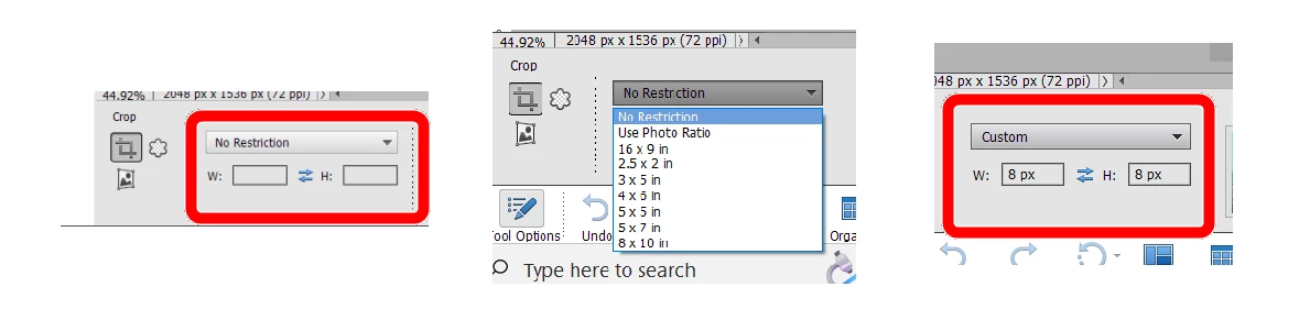

Dec 14, 2022 9:03 AM UTC
The Crop tool has various template ratios that are found in the dropdown list.  These include No Restriction, Photo Ratio and several other common photo sizes.
The Custom ratio will appear when you add your own set ratio to the Width and Height boxes.  The Custom setting should remain sticky until you choose another ratio, either from the template dropdowns or by changing the W and H boxes.
Dec 14, 2022 7:39 PM UTC
This sounds good, and it what I need, and after entering the desired W, H, and resolution, the drop down menu does change to "Custom." However, after clicking on the crop arrow button, the drop down selection turns to "Use Photo Ratio," and that setting remains when I load the next photo to be cropped.  There must be some setting that is causing this, but I don't know what it could be.  I have used the "reset tool," but all that seems to do is to clear the current settings.

Dec 14, 2022 2:13 AM UTC
@joe21846739hqkb, Elements should retain the same custom crop size until you change it. If it is not doing that, you can try resetting the Crop tool from the dropdown menu at the right side of the Tool Options bin.
Dec 14, 2022 6:17 AM UTC
Thanks for the reply.  I've tried that tool numerous times - in fact, I'm using the reset tool to clear the "Use Photo Rato" settings that continually pop in every time I load a new photo to crop. The whole tool function is really a mystery.  Sometimes (rarely) the previous settings will carry over to the next crop, sometimes I get a "Custom" setting (whatever that is), but almost always I get a "Use Photo Ratio" setting. BTW, I cannot find anything anywhere about what the Custom setting is or how to use it.  It does not appear in the drop down menu, and just it seems to pop in occassionally.   That being said, when I use one of the demensions in the drop down menu, such as a 4 x 6, it does seem to carry over to the next photo crop, however, many times I don't want to crop to that size .

Dec 14, 2022 1:09 AM UTC
I have exactly the same question, but I do not want to do a mass photo crop.  I want the same crop size and resolution for each photo with the ability to adjust the crop placement for each individual photo.  In earlier versions of PSE, I could enter a crop size and resolution in the crop tool, and it woud remain the same for each new photo until I changed it. I have PSE 19, and it wastes a huge amount of time entering the H,W, and resolution for hundreds of photos that I took during a vacation.
