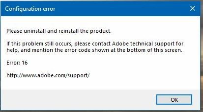

Okay, here are the basics:
1) Running windows 10, latest updates
2) Plenty of disc and RAM memory available
3) Attempted Adobe Photoshop Elements 2019 install from download link but had so many issues, returned it and bought off-the-shelf copy
4) Every install results in an Error: 16 message (uninstalled/reinstalled 20 times if I include the download copy attempts as well; 10-12 times just from DVD)
5) Adobe Customer Care logged in and we eventually managed to get Adobe running (changed permissions on Program Files, Program Files (86) and ProgramData files related to the Adobe product; eventually a creation of a SLStore folder in Program Files "fixed" the earlier problem)
6) An update for RAW files was downloaded and installed (should have known better than this)
7) Now have Error: 16 message dialog box again.
😎 Repeat of steps Adobe tech took has not gotten rid of the error.
Pop-up is attached.
Suggestions (other than just get rid of the product....which is coming closer to reality)?
99jon
January 1, 2019
January 2, 2019
Thank you for the quick response however this was one of the first things I and the tech did. The last successful running of the program occurred after he created the C:\Program Files\Adobe\Elements 2019 Organizer\SLStore folder. After the update, repeating the various folder permissions has not helped.
In searching the forum, I see this appears to be either a catch-all error or something that perhaps should have been addressed and/or understood by now.
Again, thank you for the response.
