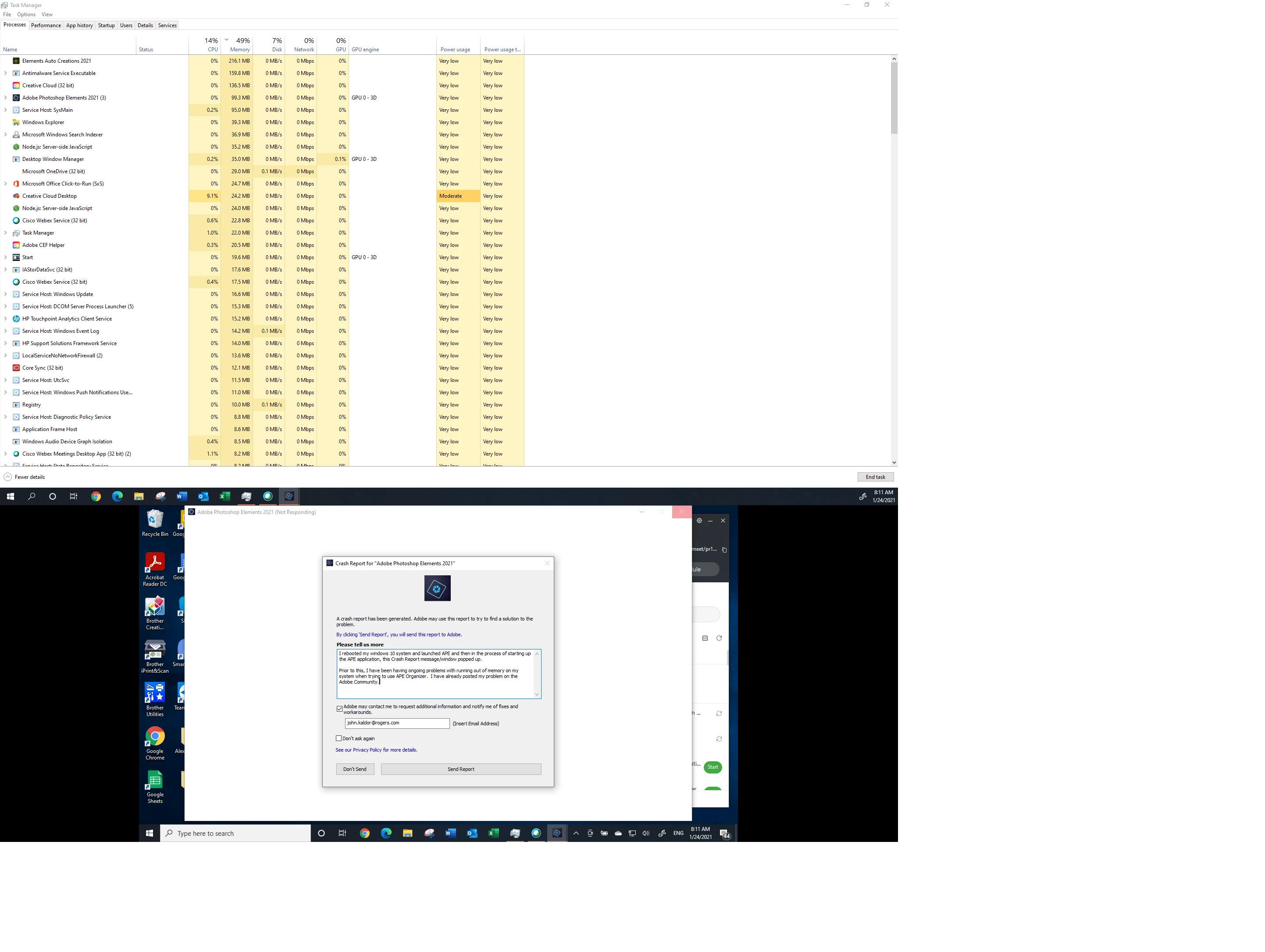

I uninstalled and successfully re-installed APE.  I successfully launched APE and encountered memory reaching 98% and then the system crashed.  I'm trying to relaunch APE to verify that the perferences set on media analysis but I now repeatedly get an APE Crash Report and can't launch APE.
See attachments.

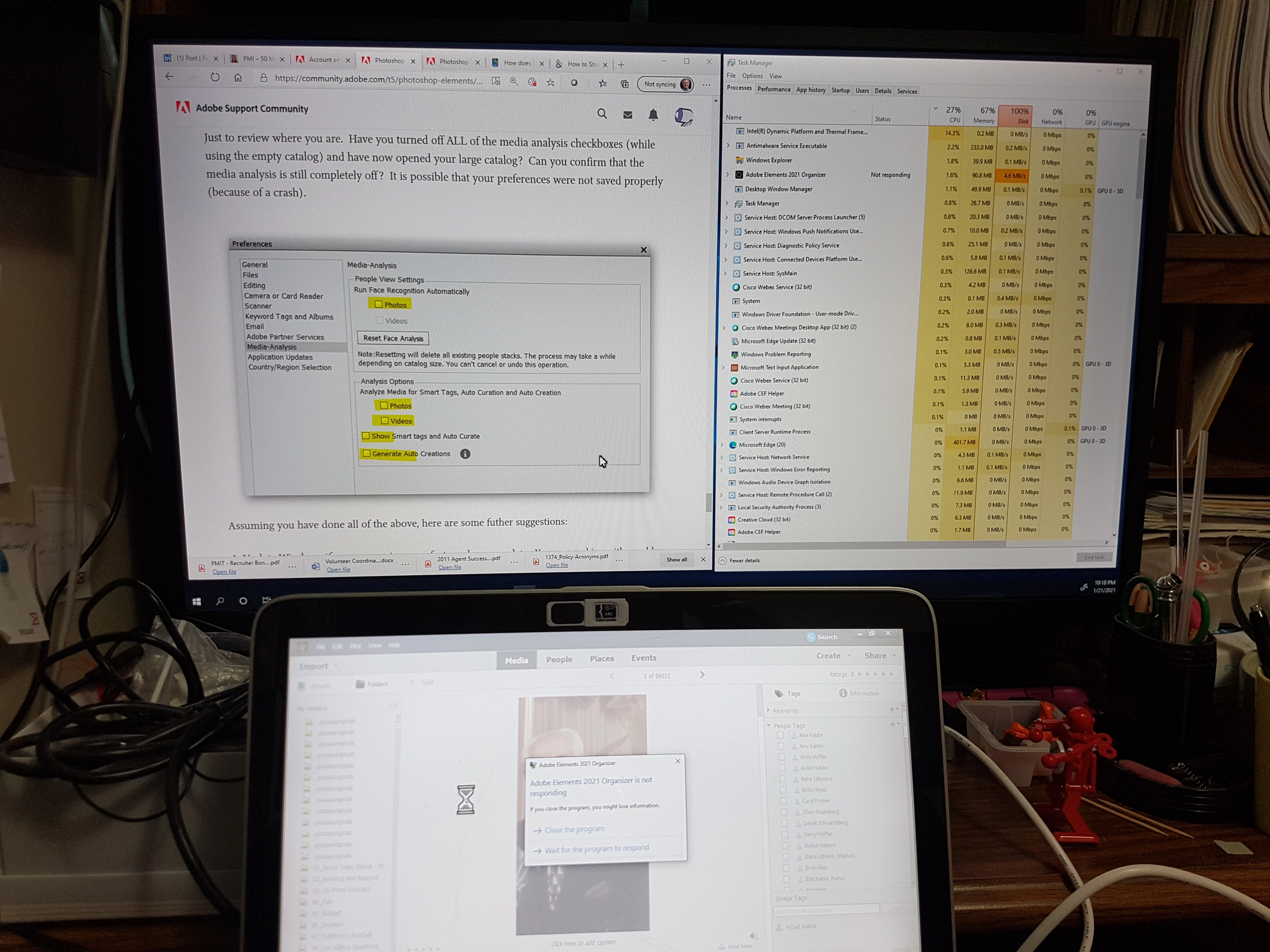

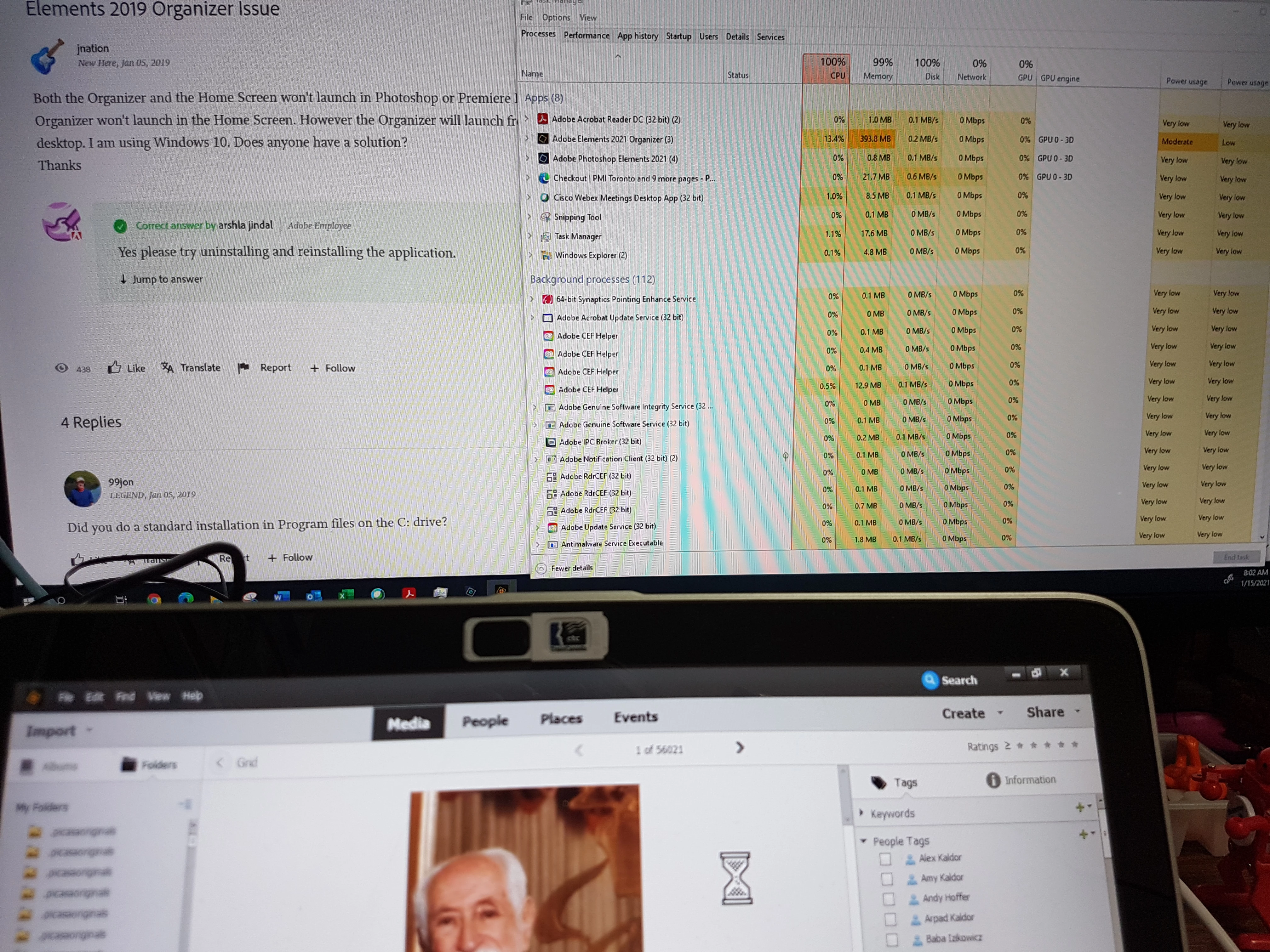

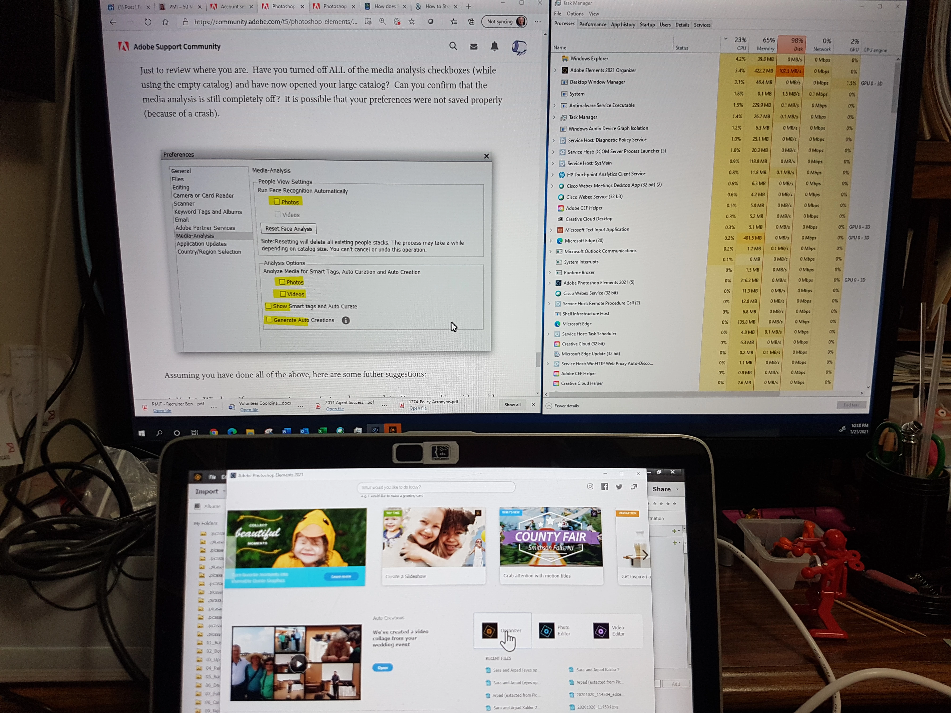

I tried to get a snapshot of the preferences media analysis but I was presented with the message Adobe Elements 2021 Organizer is not responding.  I was afraid that my system might crash again, so I closed the program.  I then decided to relaunch the Organizer application and a few seconds later my system crashed!
I then rebooted and am responding in this note.
I'm willing to uninstall and re-install, but I did spend many hours tagging the faces in my catalog prior to the application becoming unstable.  Is my catalog corrupted?  Can it still be saved and might it still be usable after the re-install of the application.
I captured some photos of the system performance just before the system creash for reference.

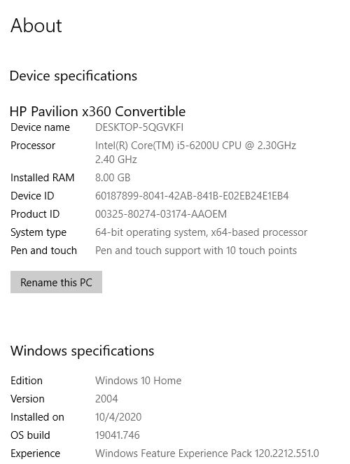

I guess I should have asked this earlier.  What hardware are you using - it looks like you are using a laptop with an attached monitor? But more specifically, how much RAM does your computer have and what CPU?  I didn't do the math, but clearly the computer is crashing when you reach 100% RAM usage and it seems like you do not have very much RAM to begin with.  And how much empty space do you have on your hard drive?
JohnK105Author
January 17, 2021
Hi Greg,
System Specs are attached.  I do have a laptop and a 2nd monitor.
Thanks.

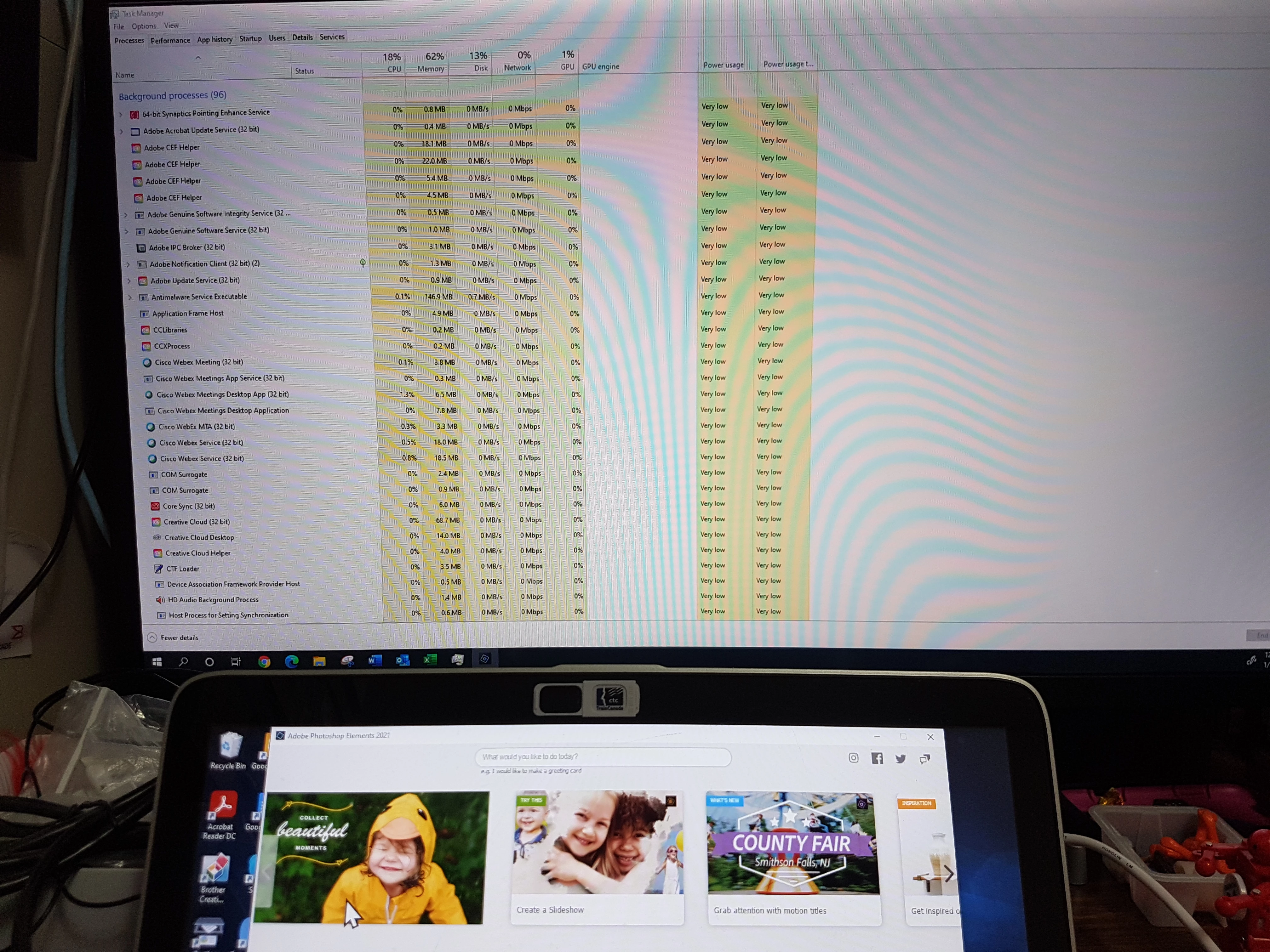

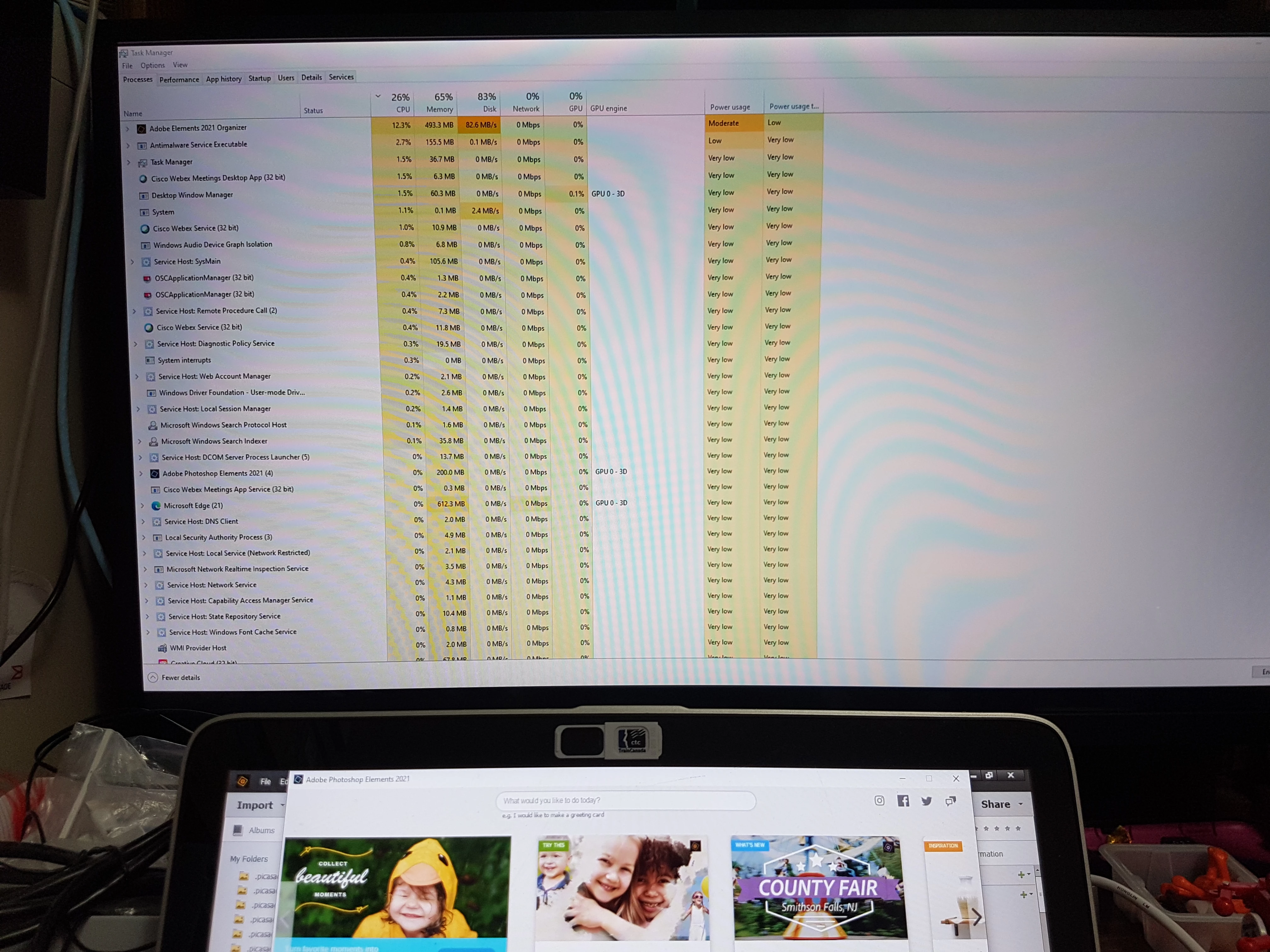

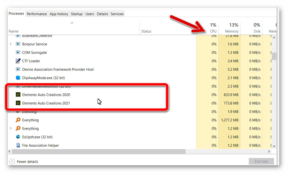

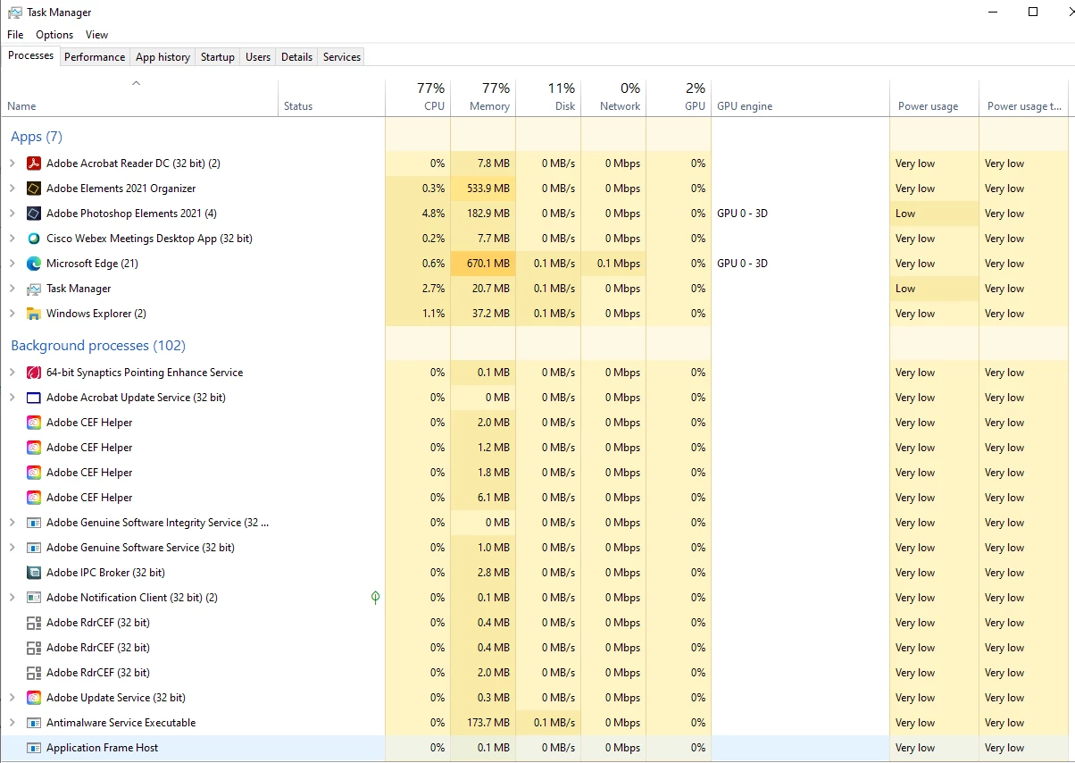

Your screenshot still does not show what is taking up all the CPU.  You need to go further down the background processes and look for Elements Auto Creations 2021.  (It does not have Adobe in the name.)  Alternatively, click on the CPU header of Task Manager and that will sort the processes by CPU usage.
JohnK105Author
January 16, 2021
Hi Greg,
Sorry for not realizing that Elements was not prefixed with Adobe.

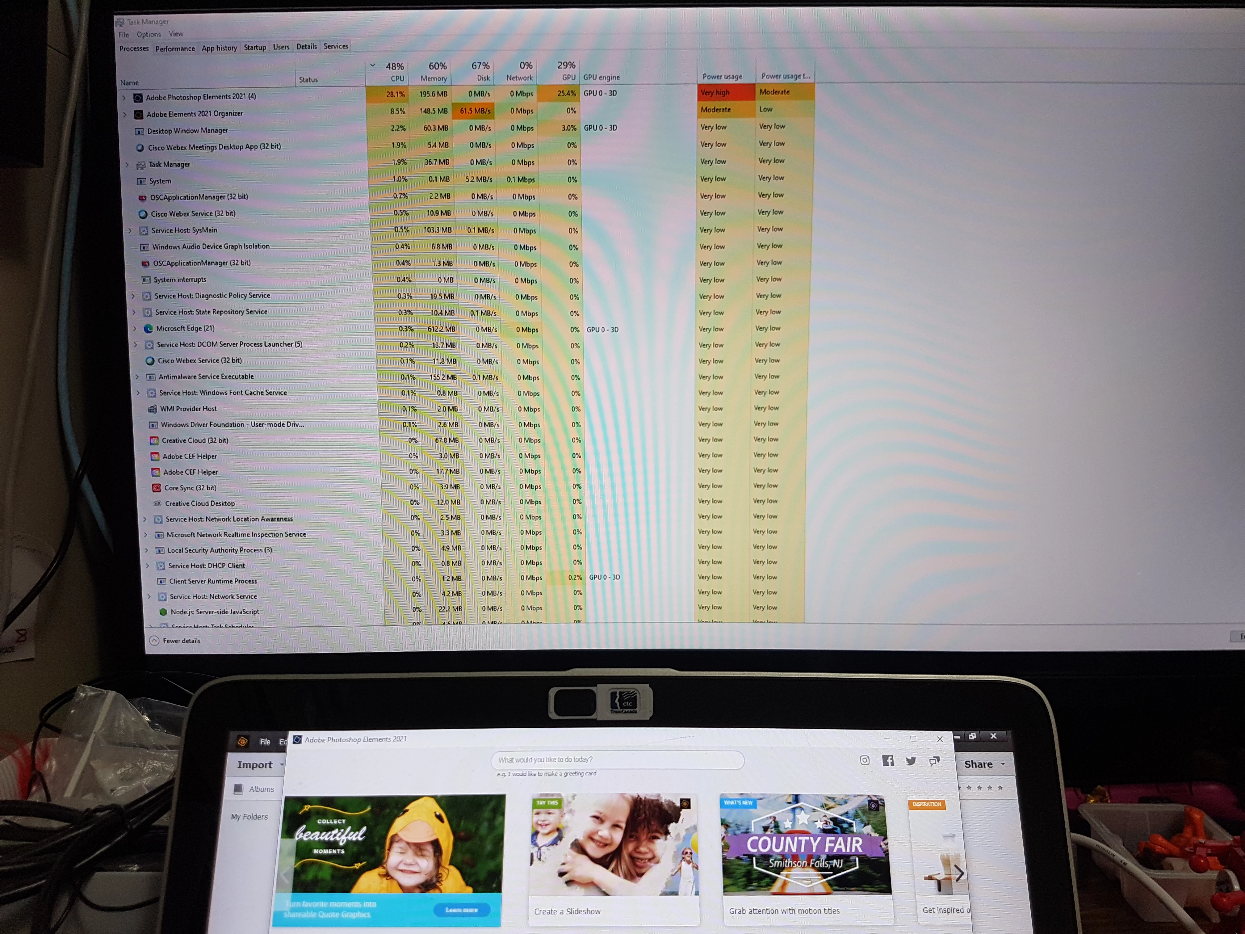

I launched Task Manager and then launch Organizer again and then did a print screen to then capture it in a Paint file but then it froze/hung/crashed on me again!!!
I did a hard reboot again and this time took out my smartphone camera to capture a series of images of Task Manager (sorted by CPU%).  The last image capture was when the system crashed again!!!
The series of images (file names are the date/time stamp) are attached for your review/analysis.
What's my next step?
Thanks for your contunued support.

Your screenshot does not show what is taking up all the CPU.  If you scroll down, do you see the Auto Creations 2021 process taking up CPU?  If so, end it in Task Manager, and let us know whether it is still active after rebooting your computer.
Now that the media analysis has been turned off, is the computer still freezing?  Are you able to name face stacks?  Having high CPU usage does not necessarily mean that the computer will freeze or become non-responsive.  But we need to track down what explains the high usage.

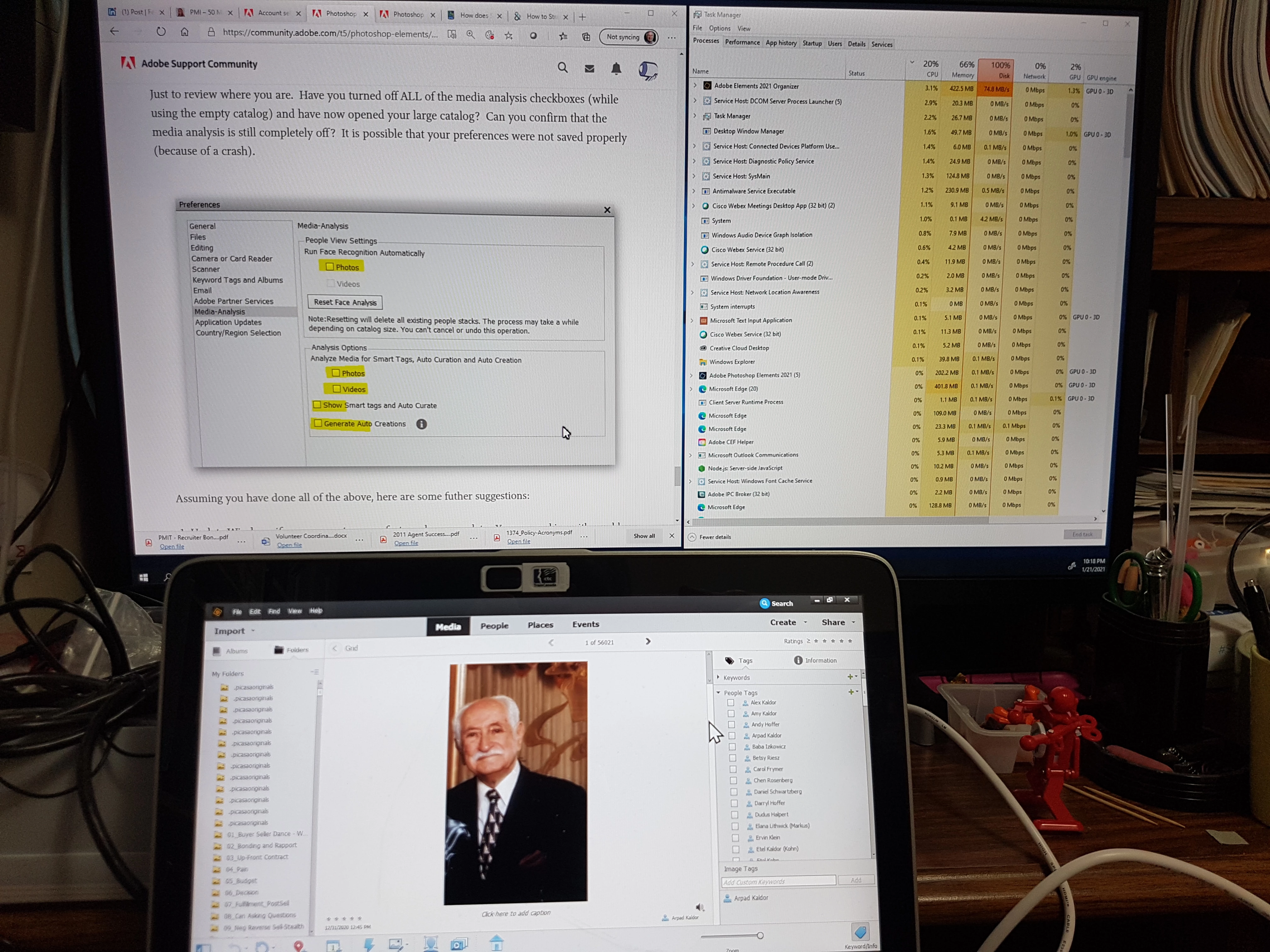

Prior to your respnse this morning., I relaunched and went into Editor to select a photo which I had previously edited.  When I selected it nothing happened.  I then went into Organizer and after selecting the 50K Catalog.  I captured a task manager screenshot which I had attached in my last reply.  I then left Organizer running and came back to it after a while.  The hourglass was still there and when I tried moving the cursor nothing happened.  It was frozen/hung/crashed!  I did a hard restart and am replying with this info.

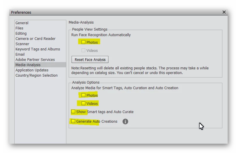

If you are unable to change the Media Analysis preferences before the program freezes, try the following:
  • Hold down the Shift key while launching the Organizer. This will bring up the Manage Catalogs dialog.
  • Create a new empty catalog and open it.
  • Skip the screens to add media.
  • Go to the Preferences dialog and turn off all of the Media Analysis. You should be able to save before the program freezes.
  • Relaunch the Organizer, again using the Shift key.
  • Open your 50k media catalog.

I followed your procedure and was able to turn off all Media Analysis and Analysis Options (unchecked all the items).  I was then able to open up the 50K Media Catalog.
I have also attached a snapshot of the CPU and Memory from Task Manager below - after performing the entire procedure.

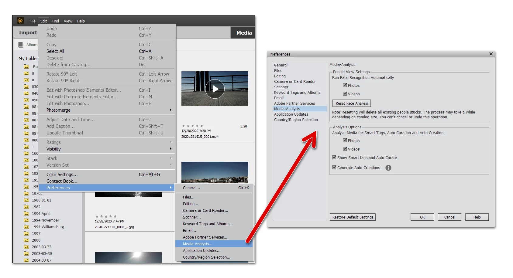

I rebooted and relaunched PSE and Organizer and navigated to the Edit>Preferences>Media Analysis dialogue.  I had slow response but was successful in unchecking Generate Auto Creations.  I then tried to move my cursor to the OK and just before I had a chance to click on OK, my system froze again!!!  Ahhhhhh!!!!
The ALT/CTL/DEL didn't work as usual.  I had to do another hard Power Off and then restarted the system again.
What's your next recommendation?
Thanks.

January 12, 2021
@JohnK105 said:
I couldn'd readily locate the Edit>File>Media Analysis dialogue.
That's because it doesn't exist.  MY MISTAKE.  I meant the Edit>Preferences>Media Analysis dialogue.    Sorry for putting you wrong.
Please report back when you have turned off all the Media Analysis.
