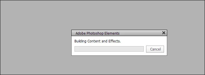

Aug 15, 2022 4:52 PM UTC
Mine is dog slow to start.  It does sort of a rebuild every time it loads.  Why each time?  My configuration does not change.   It gives the following message.
Aug 16, 2022 1:33 AM UTC
BTW Windows 10, Only SSDs, Gen 11 I7 cpu, 64GB Ram, modern GPU
