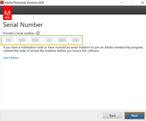

Wait, i just noticed your Serial number screen is from photoshop elements 2020?

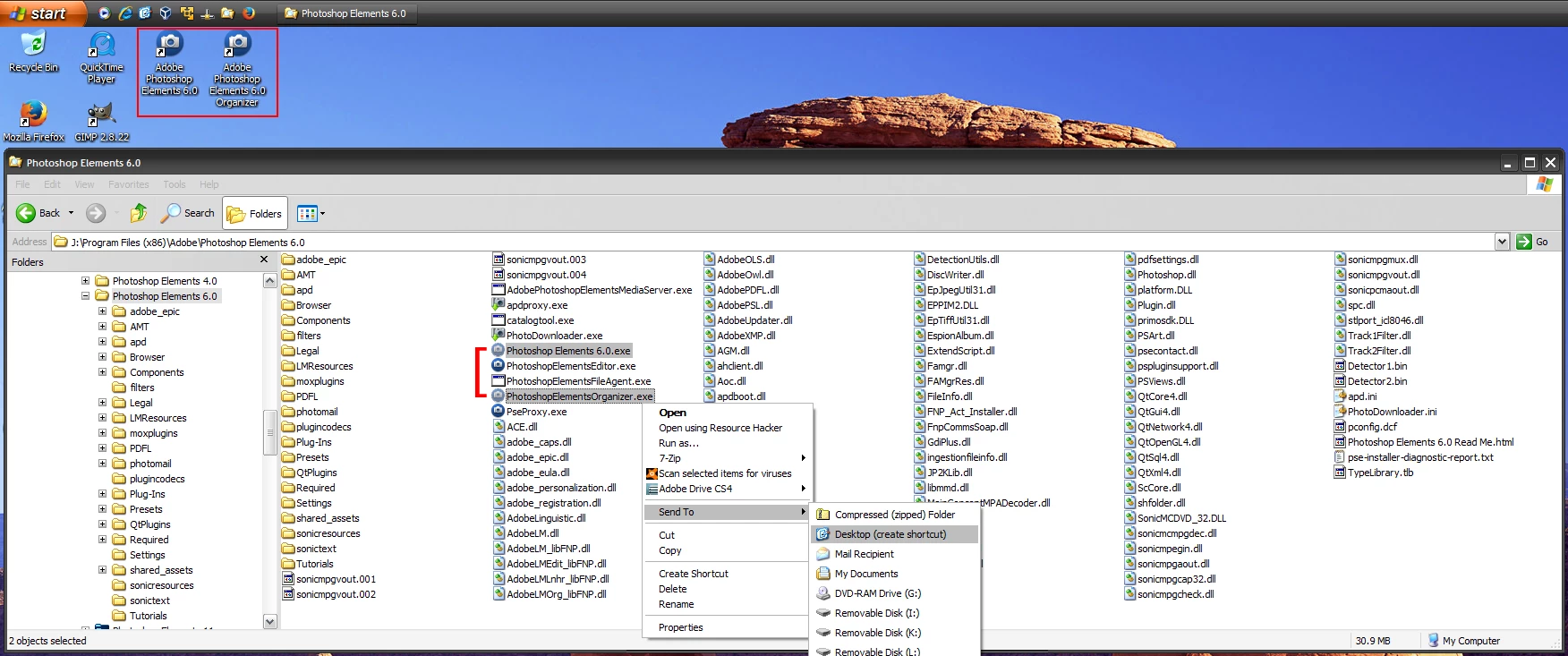

See if putting a shortcut to both the pse 6 editor and organizer shortcut on the desktop in order to bypass the Welcome Screen works.
Go to C:\Program Files (x86)\Adobe\Photoshop Elements 6.0 and right click on the Photoshop Elements 6.0.exe and then click
Send to>Desktop (create shortcut)
Repeat for the PhotoshopElementsOrganizer.exe

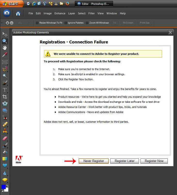

Are you seeing a Registration Screen like this?
Try turning off your internet connection first before starting pse 6
You should get a dialog like this with a Never Register button.
If your using windows vista, 7, 8/8.1 or 10, you'll need to run pse 6 as an administrator to get the Never Register to stick.
Right click on the pse 6 shortcut and click on Run As Administrator or More>Run As Administrator
You only have to do that one time and then run pse 6 normally after that.
