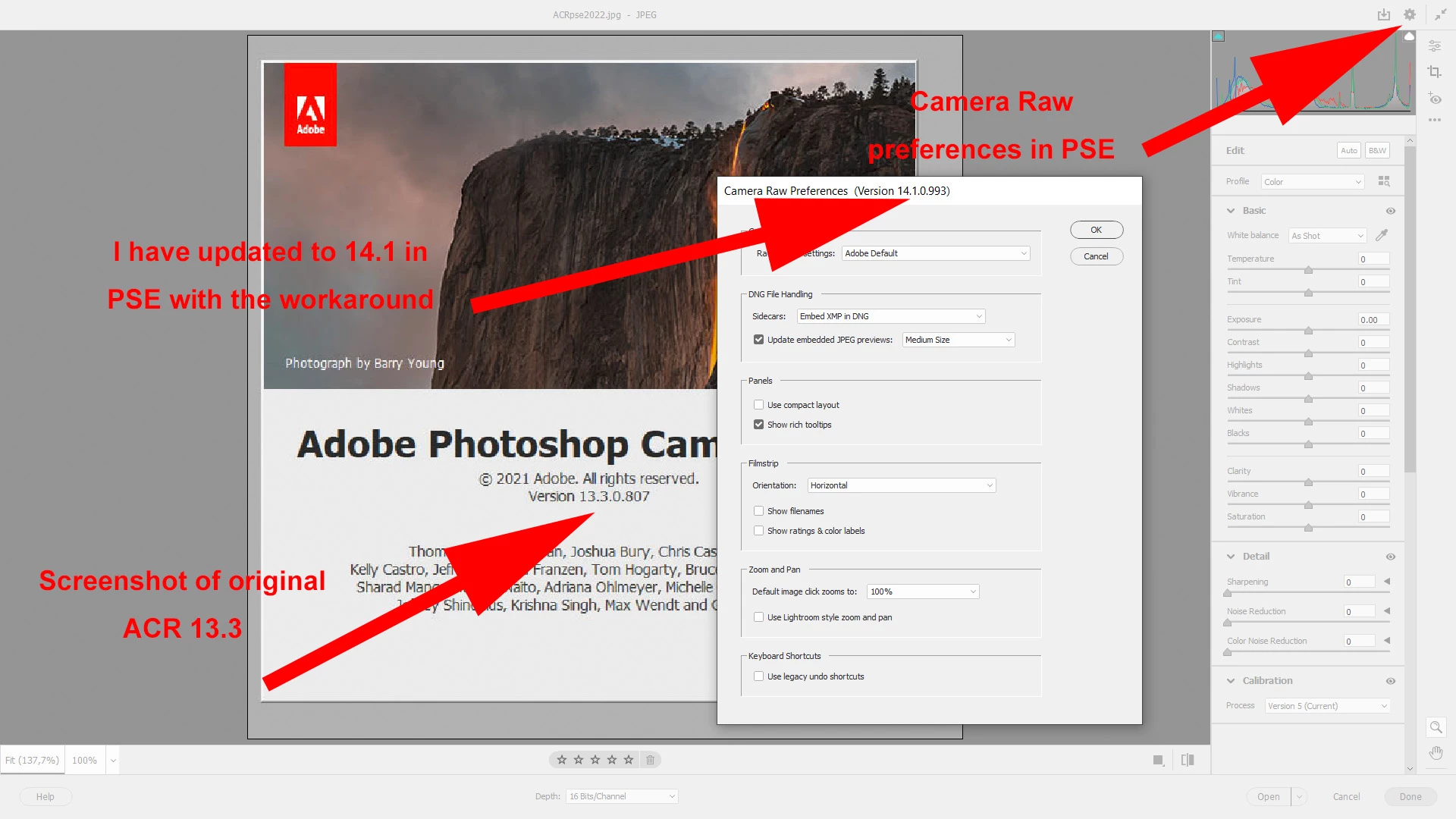

Yes there is the normal way to contact Adobe support directly, with Photoshop and Elements as well.
In the editor, menu Help >>Support... look at the bottom right corner, in the small circle you have a bubble talk with 3 dots: click on that bubble and and answer 'agent' to get into contact by chat with an Adobe support member.
Now, can you access the first stage of the opening of ACR and click on the clog wheel in my screenshot, top right ?
If you can, can you restore settings to 'Adobe default' ?
The problem with ACR in Elements is that it's a different version from the full one in Photoshop and that Photoshop ACR experts often don't know the differences.
As you can see, I have manually installed a newer version of ACR following this tech doc:
https://helpx.adobe.com/photoshop-elements/kb/camera-raw-update-not-available.html

I have now tested manually updating Camera Raw 13.3 to 14.2. No improvement. Have also tried uninstalling all Adobe programs and reinstalling PSE. No improvement. There was an update now for both PSE and Raw (ACR to 14.1). Negative result.
I just have to open Camera Raw, without making any adjustments, it will lock after a short while.
