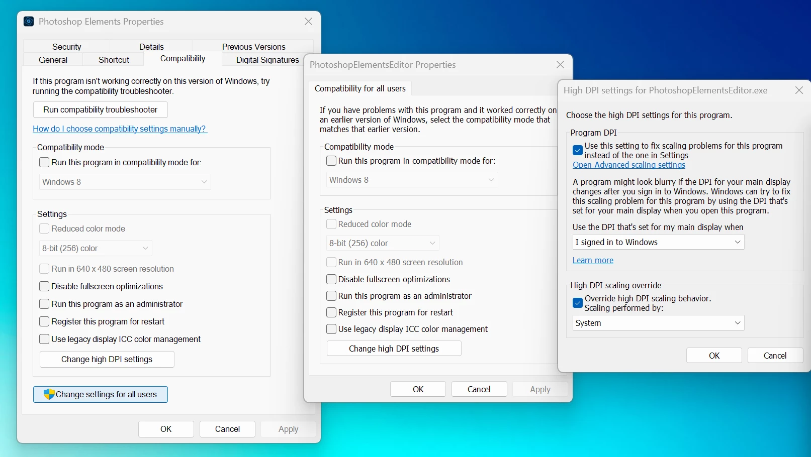

Here is something else you can experiment with. Change the program's High DPI settings in explorer. I've set mine to "Overide high scaling DPI behaviour. Scaling performed by System". This DEFINITELY fixed the problem for me. Doesn't happen anymore.

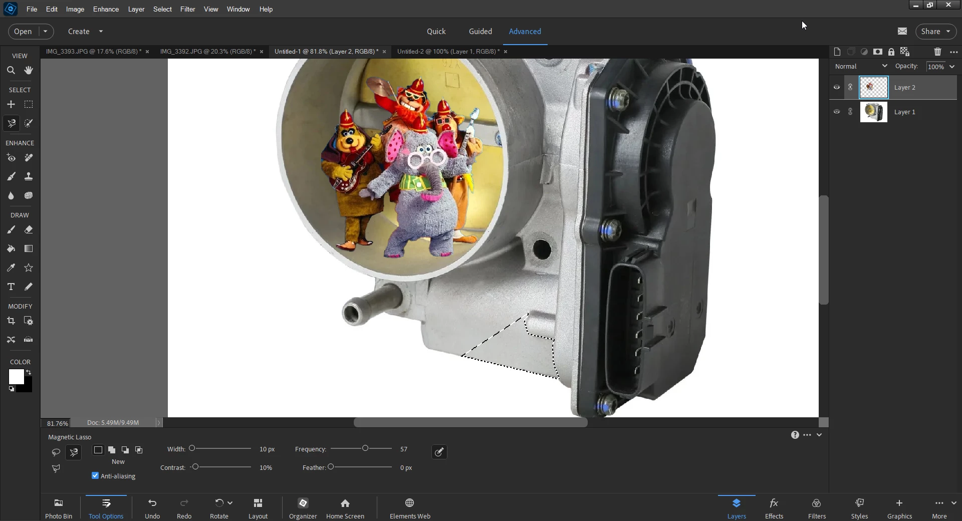

Screenshots always help, even though your descriptions were pretty good.
I generally only use the tool every now and then, simply because there are better selection tools in the program.   When I use the tool it rarely produces the results I was look for.  If it were up to me I would remove the tool from the program.
Yes, that's the Banana Splits standing in a carburator (It was for a facebook group that likes to measure things in "banana added for scale).
