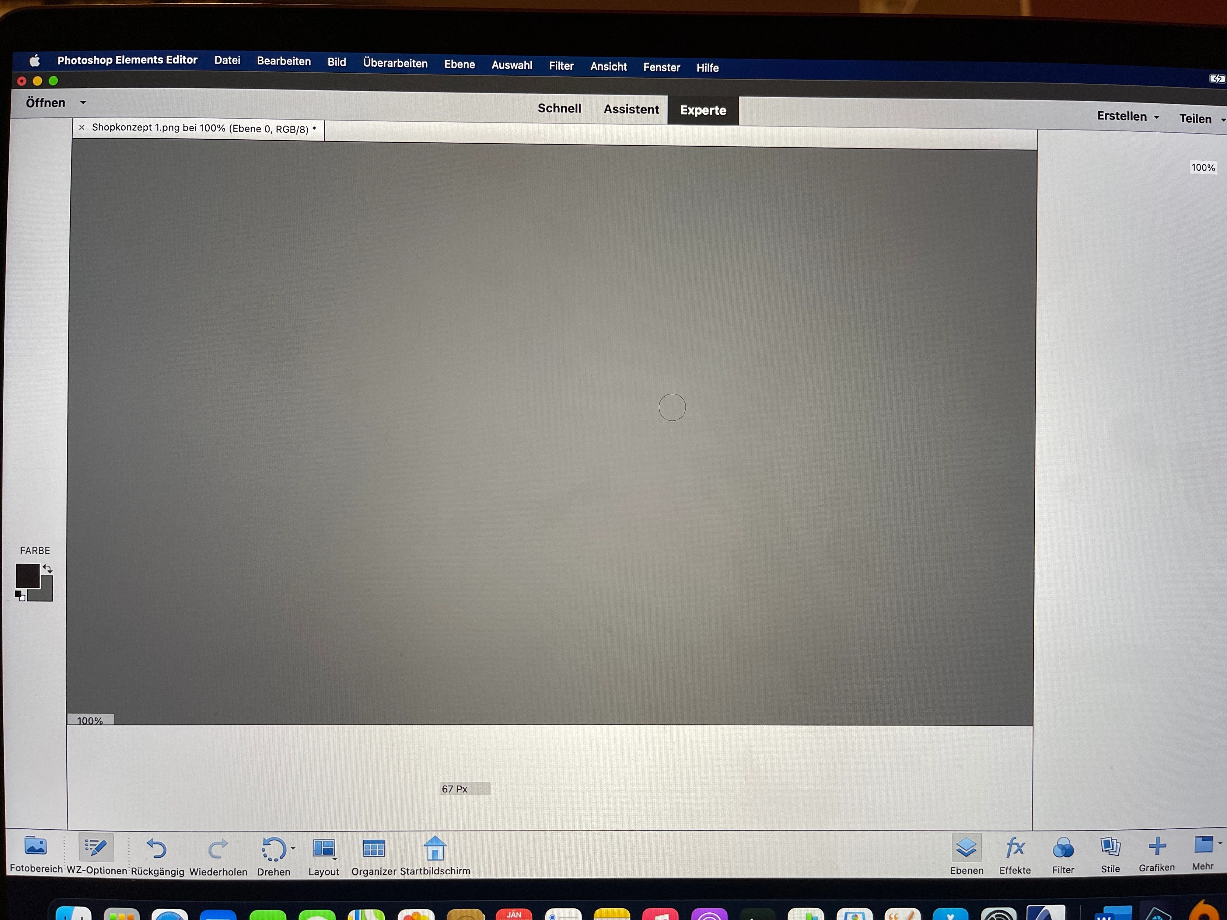

Hello everybody!
I use Photoshop elements 19 (mac) and recently there has been a problem while editing. Maybe someone could help me? As soon as I use any tool (whether transforming or using the eraser) and click on the mouse, the image to be edited disappears (you can only see the gray background of the program) and only appears again when I release the mouse button. This makes editing very difficult.
On this picture you can see the gray screen while the mouse button pressed. Does anyone have any idea how to solve the problem so that the image to be worked on is always visible? Thanks to all:)

@Magdalena5C32, Elements 2019 (version 17) will not work with Big Sur.  You need Elements 2020 or 2021.

Could you please mention the OS and hardware details? Also, have you started encountering this issue after some updates were installed on your system?
Try resetting the preferences as mentioned below:
Mac: Photoshop Elements > Preferences > General, click the Reset Preferences on next launch button, and then click OK. When you restart Adobe Photoshop Elements, all preferences are reset to default settings.
Thanks.
January 11, 2021
Resetting the preferences worked, thx so much!

I know nothing about Macs and have never seen this problem reported before.
All I can suggest is to try resetting the preferences file. Go to Edit>Preferences>General tab and click the Reset Preferences on next launch button.
I assume you have not upgraded your OS to Catalina or Big Sur?  If you have, Elements will not work with them.  I misread that you were using Elements 2019, instead of Elements 19 (which is Elements 2021).
