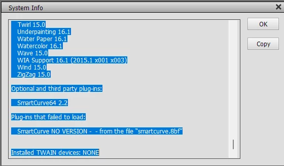

I have been installing the SmartCurve plugin which I used on PSE11 with no problems, but now I'm using pse 15 and 2024 I find it does not work, when I open the plugin on the filter menu it crashes and shuts down pse.

As Stephan has suggested, I also suspect that SmartCurve is a 32-bit plug-in that was published about 15 years ago.  You may be able to find a utility that bridges the plug-in for use in a 64-bit program like Elements 2024.  But many users recommend Elements Plus, a cheap add-on that includes a Curves function for Elements.
Apr 23, 2024 6:22 AM UTC
As you can see here :
http://members.chello.at/easyfilter/curves.html
The 64bit version is still in development and not working.
There is no solution for this issue since ~10 years.
The only way to get this working is to use a 32bit Version of Photoshop elements and take the 32bit version of the plugin, but as far as I can remember
PSE 15 is 64bit only.

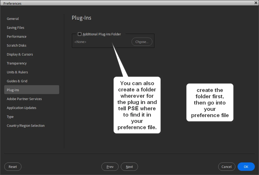

Glenn 8675309
Apr 22, 2024 11:25 PM UTC
C:\Program Files\Adobe\Photoshop Elements 2024\Required\Plug-Ins\Filters
Put the 8bf file in the filters folder.
If it still does not work / locks up that probably means the plug- in is no longer compatible-- but 8bf files are pretty standard.
OPTION 2:
