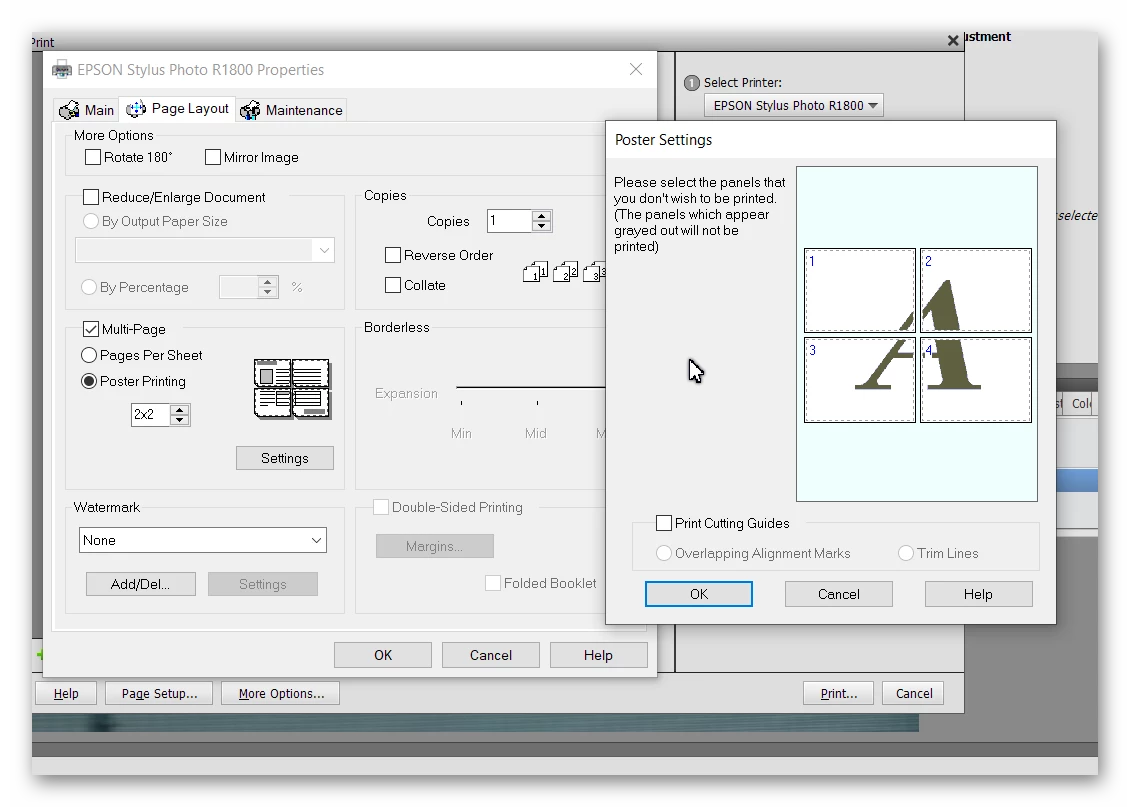

You live and learn.  In helping another user with a printer problem, I discovered that both my Epson and HP printers can print posters in various configurations.  So, it seems to me that Elements should be able to use the printer's capability to do so.  It will be necessary to go into the Page Setup dialog and enable the poster printing in the Printer's driver dialog.

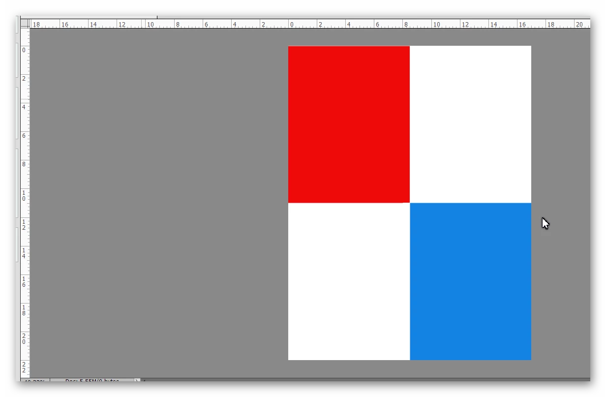

The problem is that the image at 19x12" will not fit on 8.5x11 background (tile). Even the aspect ratios are not in alignment.
If you are so inclined, please post a representative picture file for us to look at. You can do that via the Insert Photos icon at the top of the reply box here on the forum; however, you can not do it via email reply.

Moe,
I fail to comprehend how a 19x12" (physical size) picture  can be expected fit on an 8.5x11" canvas.
You can crop the picture to 8.5x11". Then it will fit, but you will lose some information.
You can also try to resize the picture with resampling via Image>Resize>Image size.
Tell us more about the tile - - perhaps that will help me to better understand the issue.
