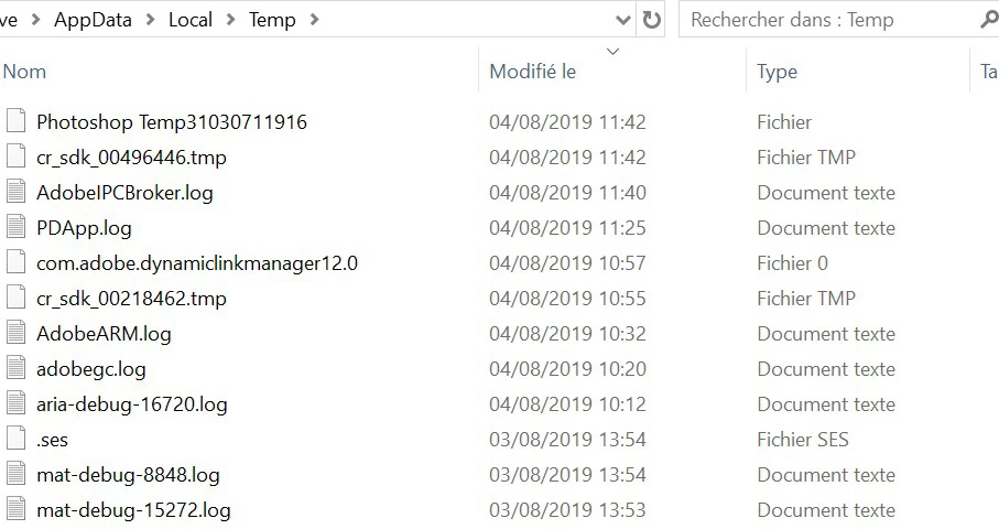

  10. Check the conversion log: although I am not attempting any conversion, but a total backup, I have checked the %temp% directory, situated at C:\Users\$$$$\AppData\Local. As shown on the attached capture of the most recent files present in this folder, I have not found any *.temp file which name woulf include the catalog name.
