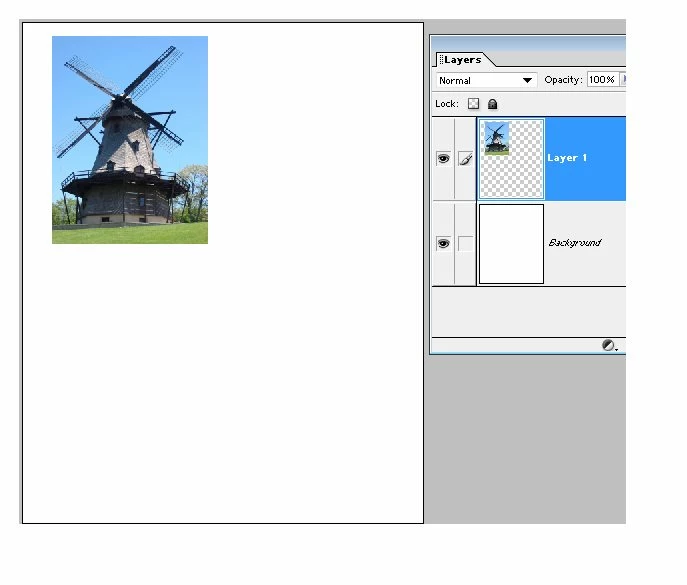

    Wow, PSE1!  And I thought my PSE2 was old .

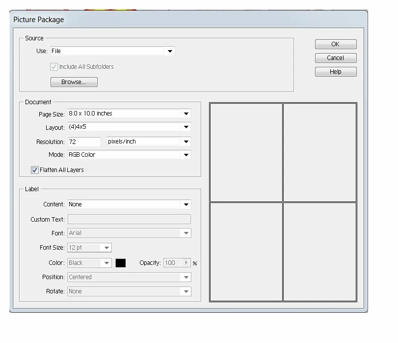

    Anyway, in my PSE there is a Picture Package option where you can define 4 4x5's to print.
    I don't know if PSE15 has such an option (I would hope so).
    If not, here is a way to do it.
    1 .Create a blank file 8.5 x 11 and with the same resolution (DPI) as your picture.
    2. Open the picture and select it: Select > All.
    3. Copy the selection to the clipboard: Edit > Copy.
    4. Open the blank file and paste from the clipboard (Edit > Paste). This places the picture on a new
    layer.

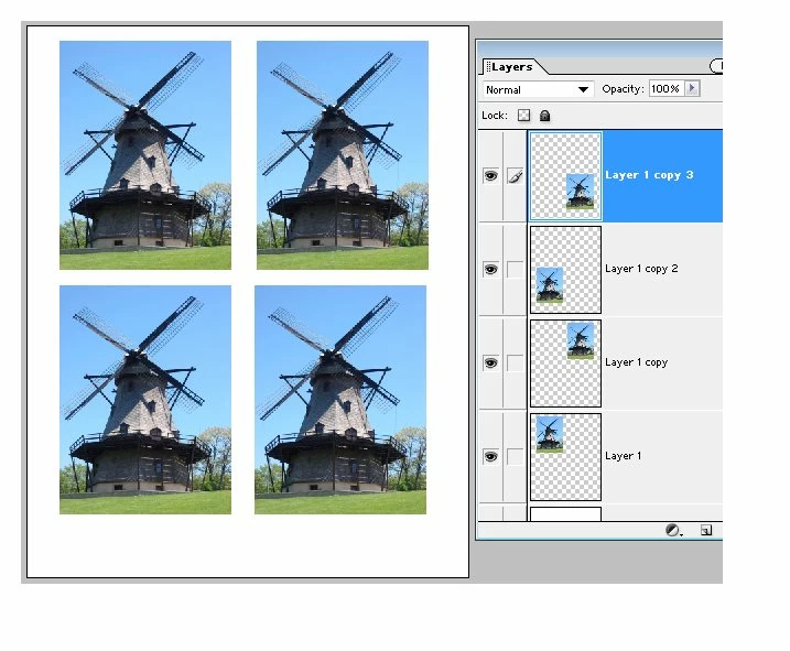

    5. Using the Move tool, position the picture in one corner.
    6. Duplicate the layer 3 times and position them.

    I found print- picture package but it looks nothing like yours. I was able to get 4 photos on a page but that messed up proportions. Only allowed 4 3.5x5. The strange thing is that when I printed the pictures they were muddy. Dark and little contrast. I printed the same pictures with irfanview and they came out fine- but only one at a time. The other process you showed sounds complicated but I will try it later today. Thanks.
