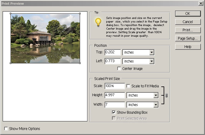

February 10, 2016
In my ancient PSE2 I can do File > Print Preview , uncheck the Center Image box, and drag the photo to the top of the page.
Then later do the other photo moving it to the bottom.
Has this capability been removed in PSE9? I would be shocked!
February 13, 2016
Unfortunately, in PSE9 someone in their infinite wisdom decided not to allow that function anymore. Now the photo comes up in a bounding box that you can drag up, down, left or right but it cannot be rotated. Best solution seems to be to print on a half-sheet (5.5x8.5) in custom size. Then you can cut your 8.8x11 paper in half and just run it through on that. Gotta print twice, but at least you can use the full sheet of paper.
