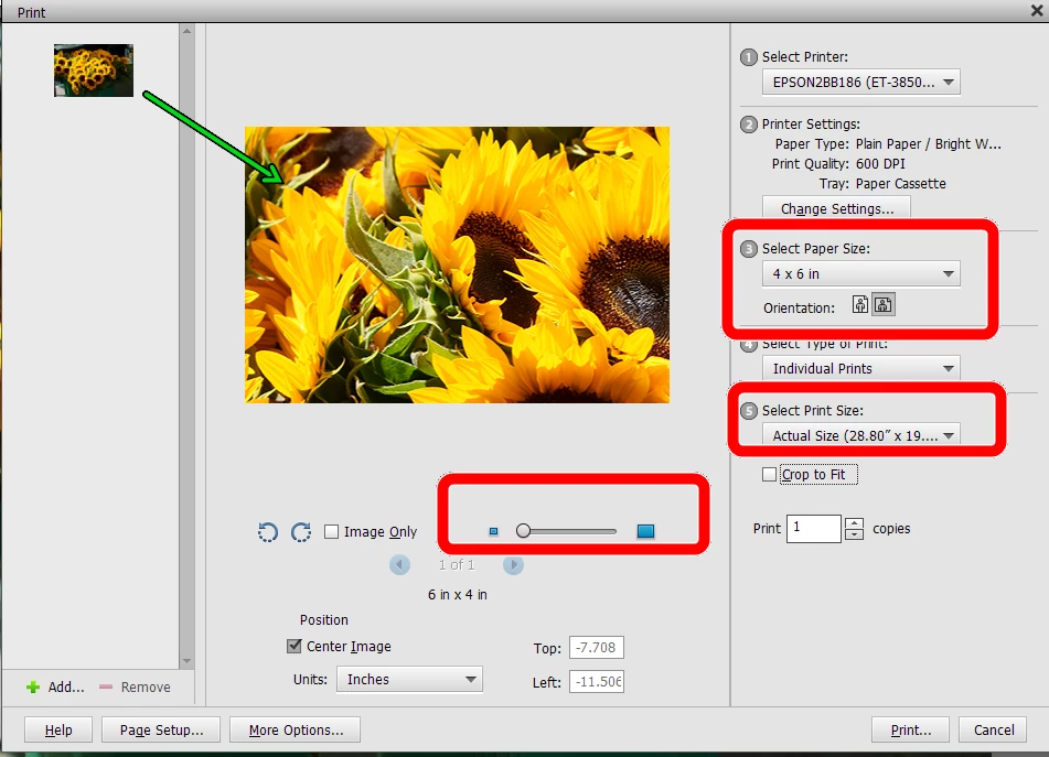

This can happen for a number of reasons, but you should be able to fix it in the Print dialog settings.   As you can see in the screenshot below, my photo has been severely cropped in the print area.  This is because I have set the Paper Size to a 6x4 print, but the Print Size is set to Actual Size of 28x19.  If I change the Print Size to match the Paper Size, the full image will print.  Other possibilities could also include that you have set the zoom slider to close in on the photo.
