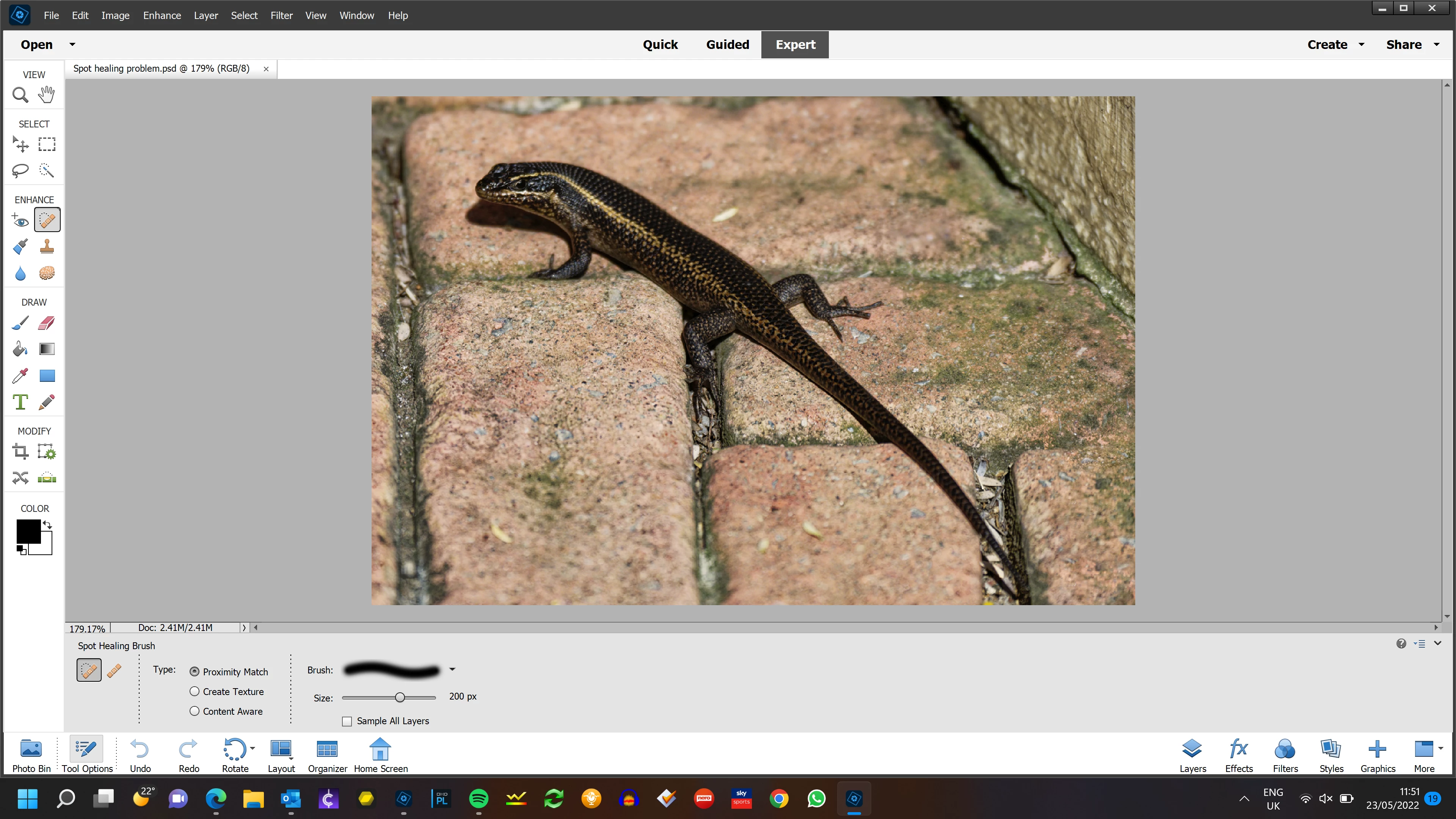

Based on the size/resolution of the photo you have attached (when I download it), it seems to me that you are using too large a brush.  When using the Spot Healing brush, you should size the brush to just cover the spot you are trying to remove.  You can use the square bracket keys to quickly resize the brush ([  ]).
I removed the white blemish in the screenshot below, using a brush size of 60 px.  When I increased the brush to 200 px (as shown in your settings), nothing happens because too large an area is covered.
Let us know if this fixes the problem for you.  (I'm not sure whether the forum changes the resolution of the photo when I download it.)
May 24, 2022 6:54 AM UTC
I admit that does seem to work but I am sure I have had the problem with smaller sized brushes. I will try some more files over th enext couple os days and let you know how it goes. Thanks for your help.

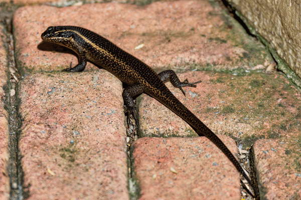

May 23, 2022 10:01 AM UTC
If you look just to the right of the skink’s body there is a white-ish small seed or leaf that I have applied the spot healing brush to three or four time but to no avail.
I have added a screenshot to show the settings.
