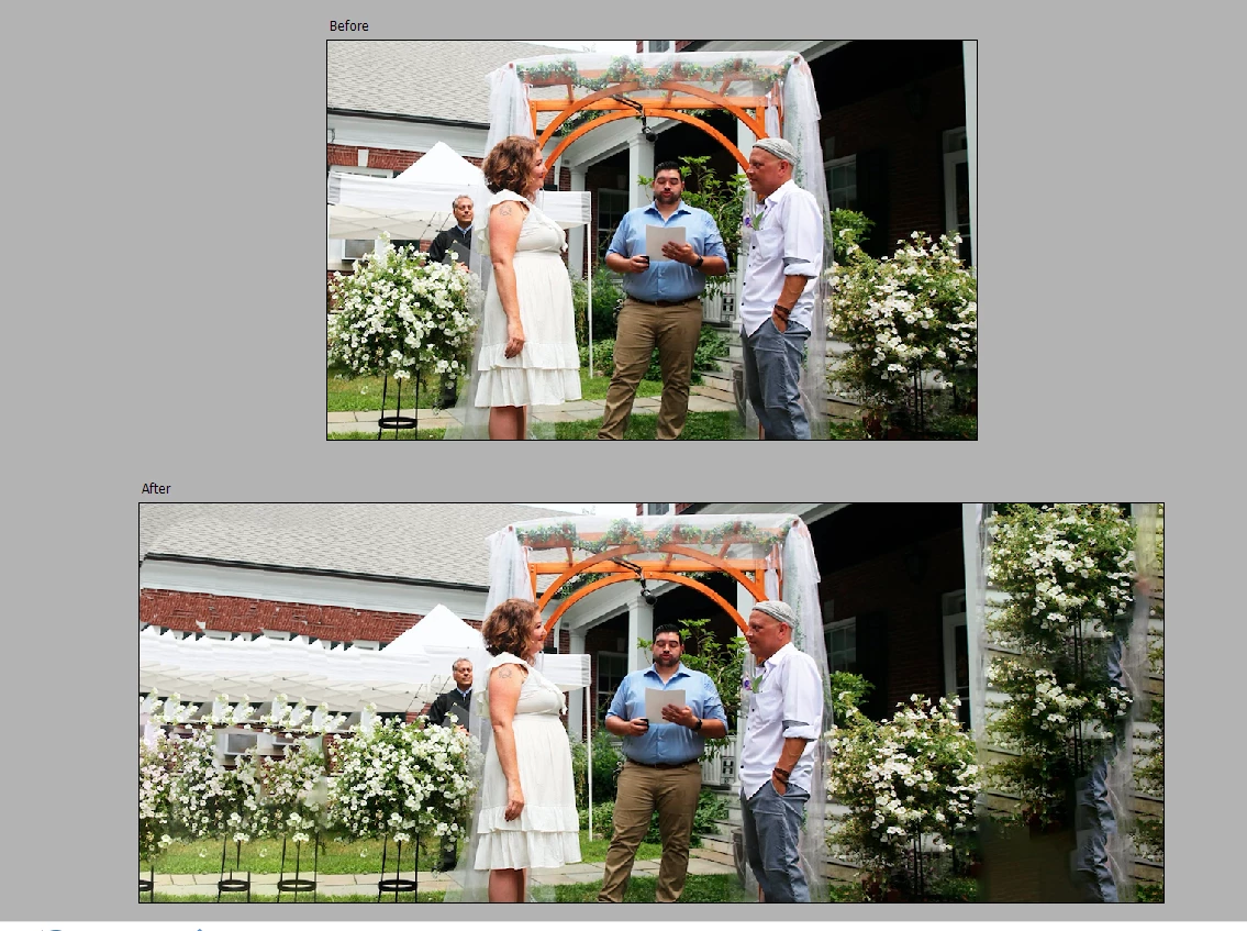

Elaine, I hope you don't me playing with your photo.  Frankly, the original is not really suitable for extending into a 3:1 panorama (IMO).  So, first I cropped the photo to focus on the bride and groom.  I was then able to use the Guided Edit to create the following before and after view.  At least this gives you some idea of what can be done with the available tools.
ElaineNewYork
Sep 3, 2022 12:53 PM UTC
Very interesting, and a great tip! I just upgraded to Elements 2022, so I'm going to take all these great suggestions and practice/learn. Thanks so much again!

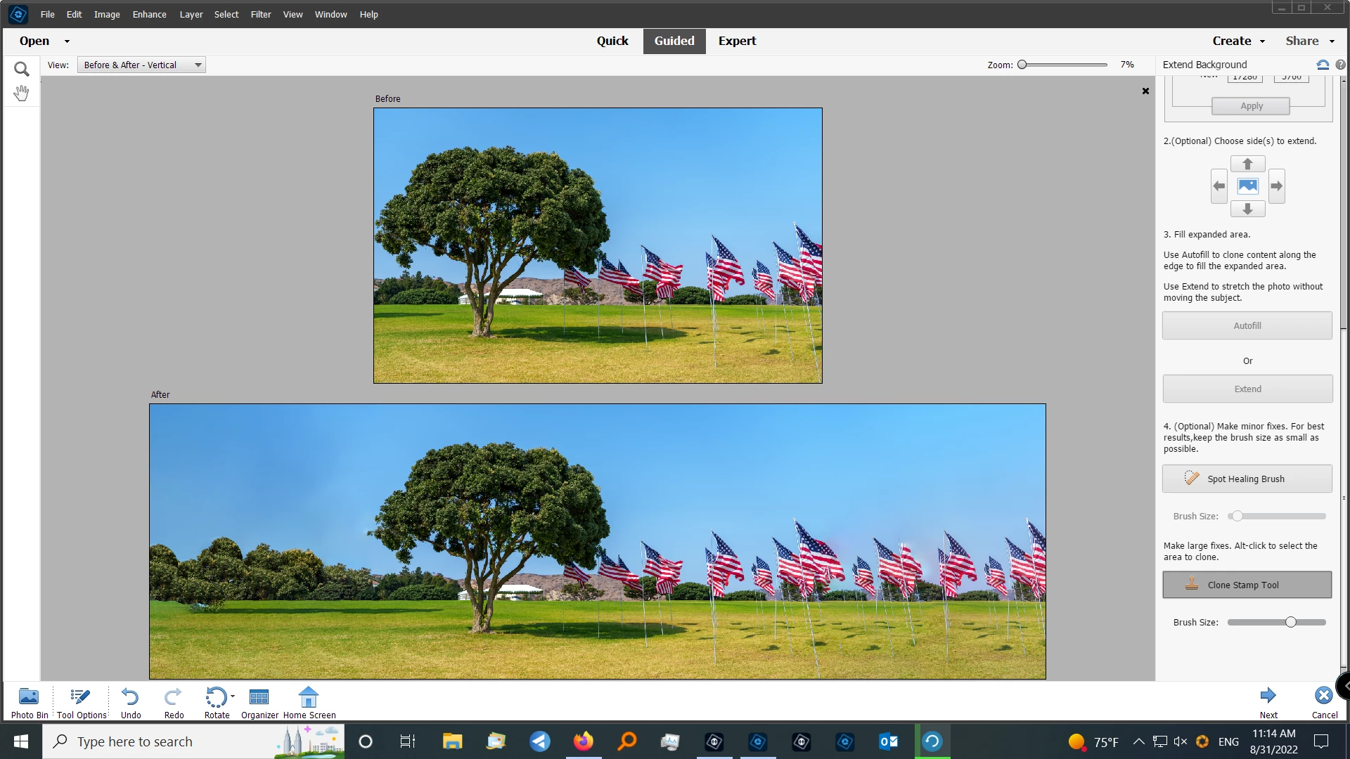

Elaine, you haven't really told us much about the kind of photos you want to put in the "panoramic" frame.  I have tried to explain the problems with changing the aspect ratio for the frame.  @hatstead has given you some examples of how to perform each type of extension.  Elements 2022 has provided another method which may suit your needs.  There is a new Guided Edit that will extend the background of your photo using artificial intelligence with a Content Aware Fill.  Here is what I was able to do with the photo from my earlier screenshot:
This took me less than a minute to create (although I could have spent more time cloning or spot healing the area on the left, particularly the phantom shadow).  Obviously, this will not work well on all kinds of photos - for example a group/family portrait.
You can download a free trial of Elements 2022 and see if this new feature gives you what you want.   And here is a video that shows how the Guided Edit works.

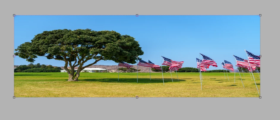

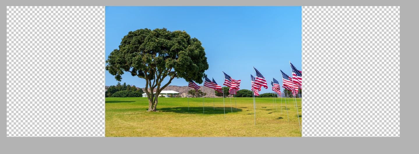

I'm afraid you are trying to put a square peg in a round hole.  Your image has an aspect ratio of 3:2.  (The number of pixels doesn't really matter for this discussion.)  Your frame is 3:1.  So, if you put the picture in the frame, it will look something like this:
You can, of course, fill up the frame with the image, but you will lose a lot of the image, so it appears like this:

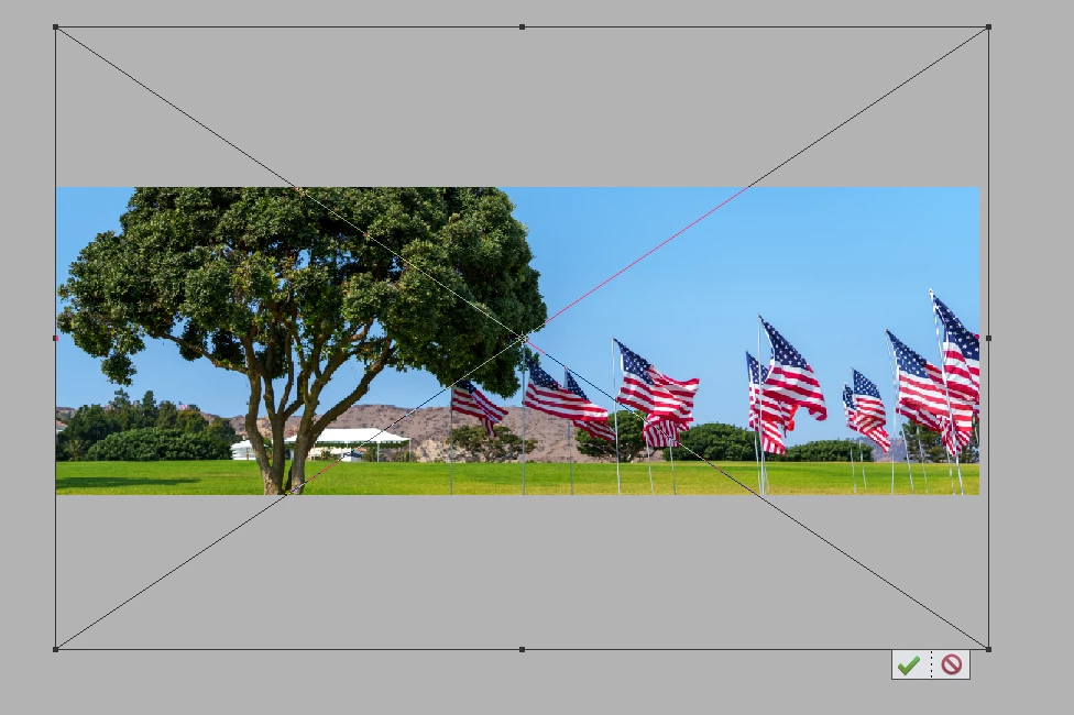

Or you can resize the whole image itself, which will cause a distortion in the photo, something like this:
So what exactly do you have in mind?
