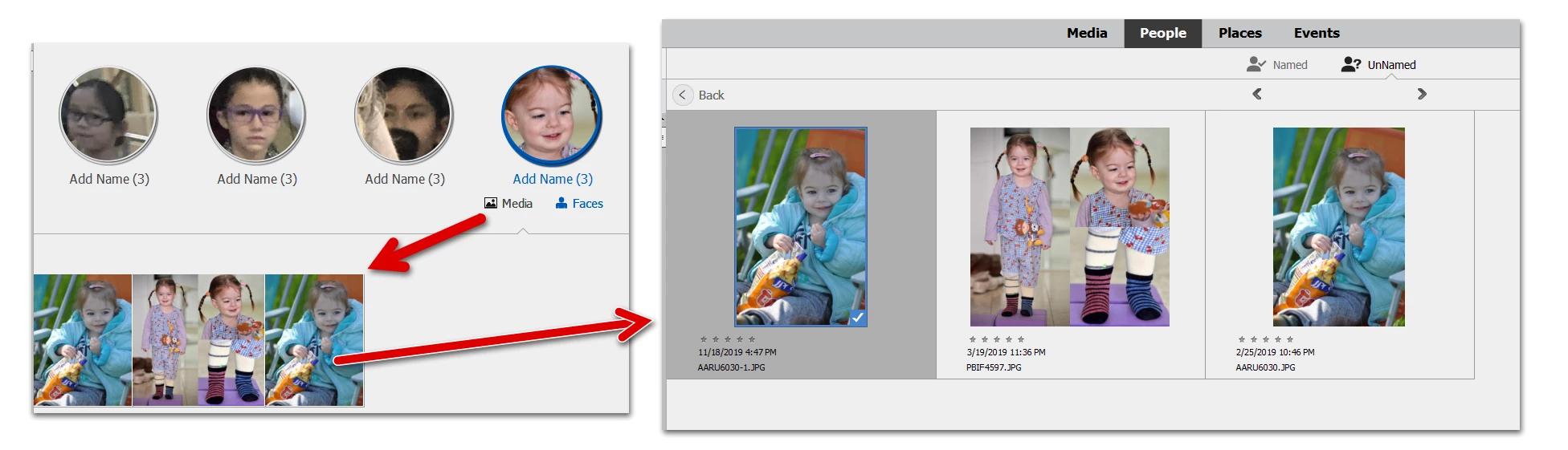

What is bothering me is I have 360 people in the UnNamed stack and only 51 in the named.
This means that only 51 people have been named by you via the face recognition tools.  While it wouldn't matter if you attached a name to a face via the UnNamed People room or via your preference of naming someone in the grid, I would like you to confirm that you have not named people in your photos by simply dragging a People name tag from the keyword tag hierarchy to the image (or vice versa).  If you have named a person in the grid via the Add Name text box, that person will appear in a stack in the Named People room and the photo will be removed from any stack in the UnNamed People room.  If you have only added a People tag to the photo in the grid, the name should appear in the Named People room but the photo will be identified with a generic icon, not the face of the person.  Similarly, if FR has recognized the face, the photo will remain in a stack in the UnNamed People room because the tag has not been associated with a face.

What is bothering me is I have 360 people in the UnNamed stack and only 51 in the named.  As I have said, this catlog contains scan photos of my family and that of my husband's.  Typically, what I have always done is scan a group of photos, named the file according to who is in the photo and date.  Then copy the photos to my ancestry folder that is setup as a watch folder.  Once that is done I would go into the organizer and update the information.  This included identifing the people in the photo with FR.  This is why I was doing it from the grid and and the UnNamed Stack.  What I was impressed with is the system would reconize a majority of faces that had already been added; "Is this Charles S. Banks?"  On new faces I would already have the information on who it was and would just enter while i was working on the photo.  I am now blind-sided that I have so many unNamed faces, some of which I swear I know I added names.
