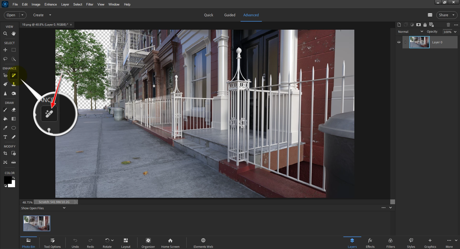

    The screenshot below is from pse 2025 and the arrow points to the "magic removal tool"  which does the same thing and the distraction removal tool in PS.

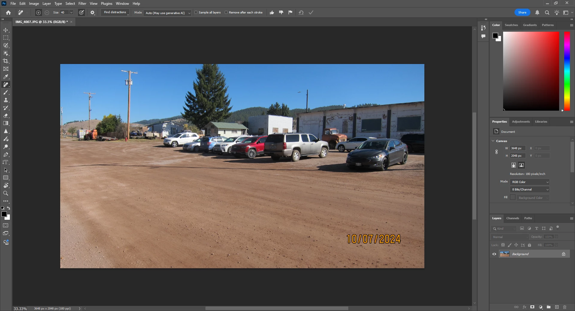

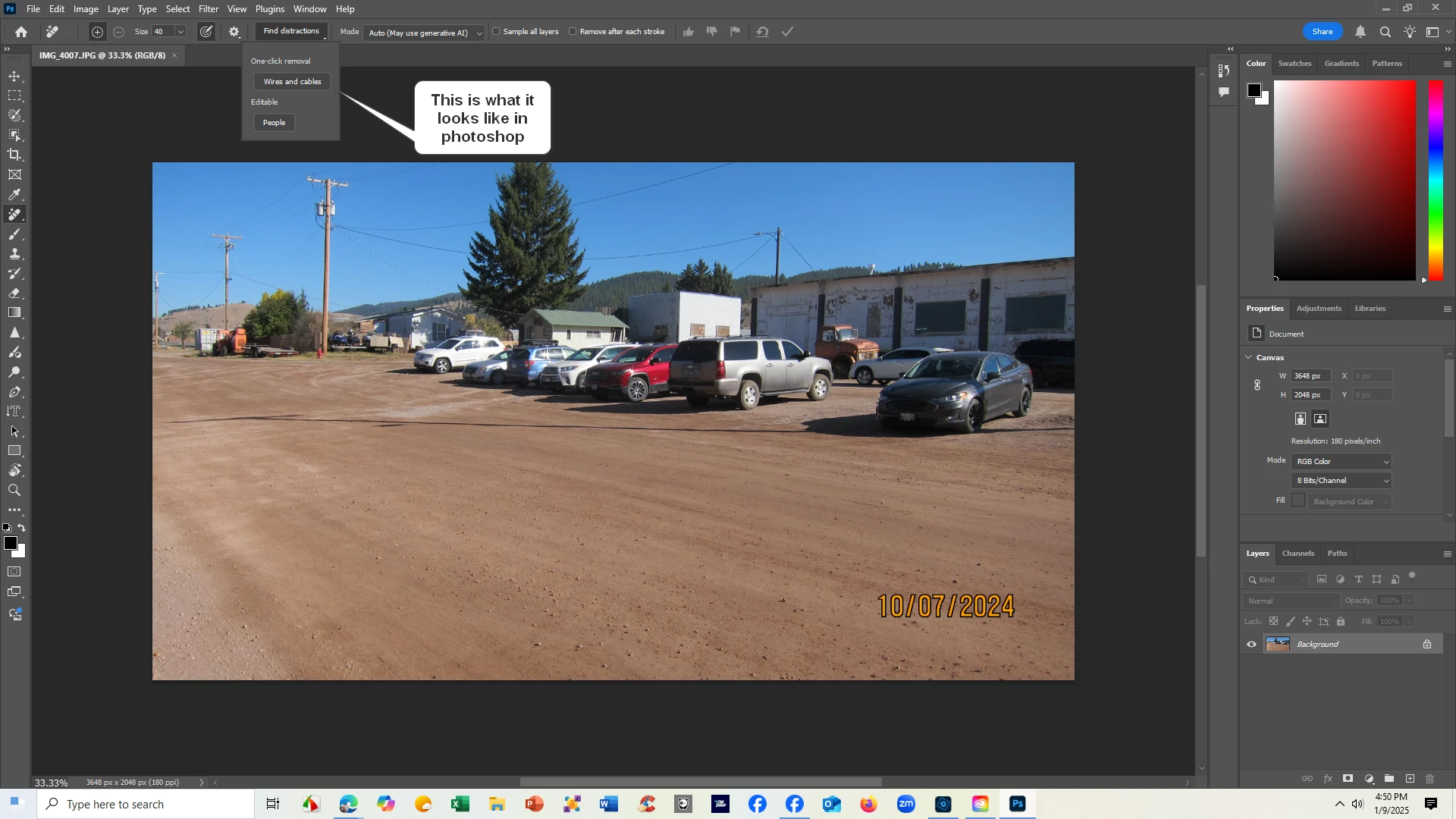

    This is from the latest version of photoshop:  Please note the telephone and power lines.  The second image is the result- you don't have to select the wires PS does it automatically.

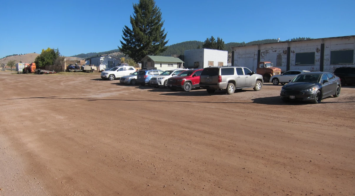

    This is after I manually removed some poles and the date-- PSE lets you do this, but the end result is not quite as good compared to photoshop.
    This is actually the Phillipsburg School district staff  parking for the school system-- all two buildings.
