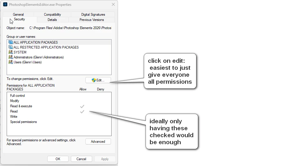

    Glenn 8675309
    Aug 20, 2026 11:56 PM UTC
    Perhaps it’s a permissions issue.  Do you know how to check that on the exe file?
    alwrmcAuthor
    Aug 21, 2026 12:28 PM UTC
    Check on the exe file? No,I do not.

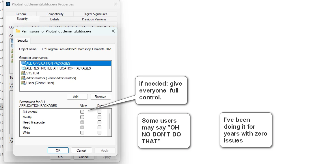

    Glenn 8675309
    Aug 22, 2026 10:05 AM UTC
    locate the exe file.
    right mouse click on it.
    choose properties
    choose permissions
    choose security

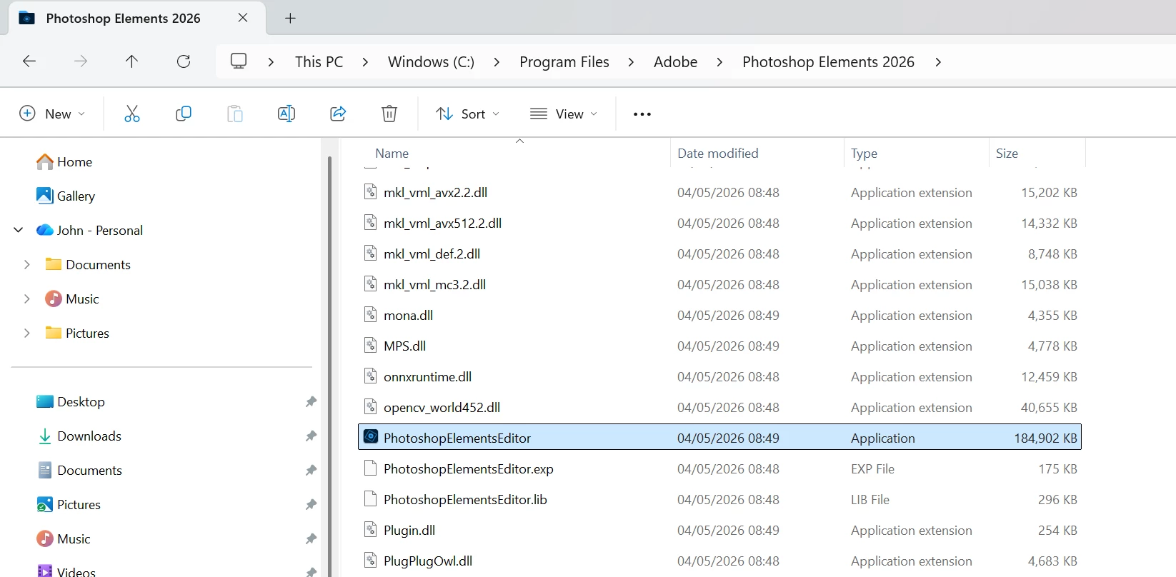

    Aug 20, 2026 5:57 PM UTC
    Try closing all programs including Organizer and navigate to the Editor executable file.
    Go to:
    C:\Program Files\Adobe\Photoshop Elements 2026
    Inside the Photoshop Elements 2026 folder scroll down to the files beginning with P and right-click on the application PhotoshopElementsEditor and choose Open - see image
    If it launches successfully, you can pin it to the taskbar and you should be able to launch in future with a single click on the taskbar icon.
    If that doesn't work you may need to do a full clean-up and re-installation.
