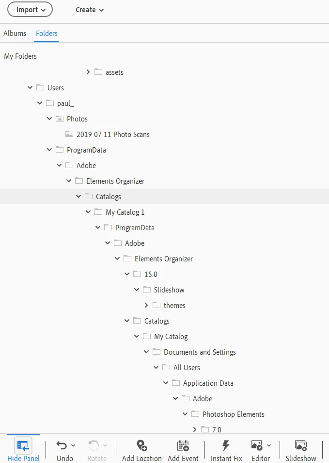

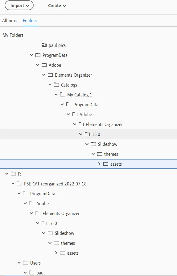

hello not sure you are still here....just appreciated your help before. I have been tied up with life and havn't finsihed cleaning up my catalog yet. quick rundown. I have it on an external drive and restored there. It works good for my photos but my folder tree is a mess. My current Catalog is ten plus years of various PSE years additions/upgrades restored, converted Catalogs from over the years of restoring and it has become a mess of a Folder tree! Grayed out Folders and previous un-used drive letters & folders and file paths from way back I can see but cannot delete or remove any of it anyway I can find. How can I remove all this old junk from my catalog folder tree and just have the present used position of my photo folders in my Catalog and nothing else..? Pauls pics folder at top and above are all my current used folders, no issues with those. I want to clean this up before I convert it onto my new laptop with PSE 2024. screen shots of folder tree. how do I get rid of everything below Pauls pic folder? Do I have to go into File Explorer and do it? I am stumped. Thanks for the help
