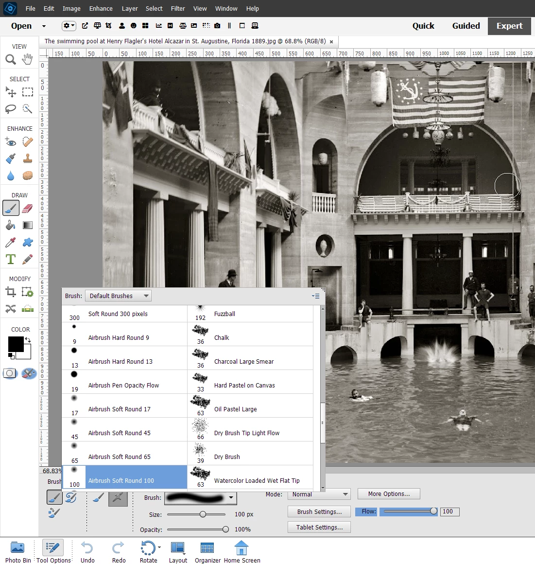

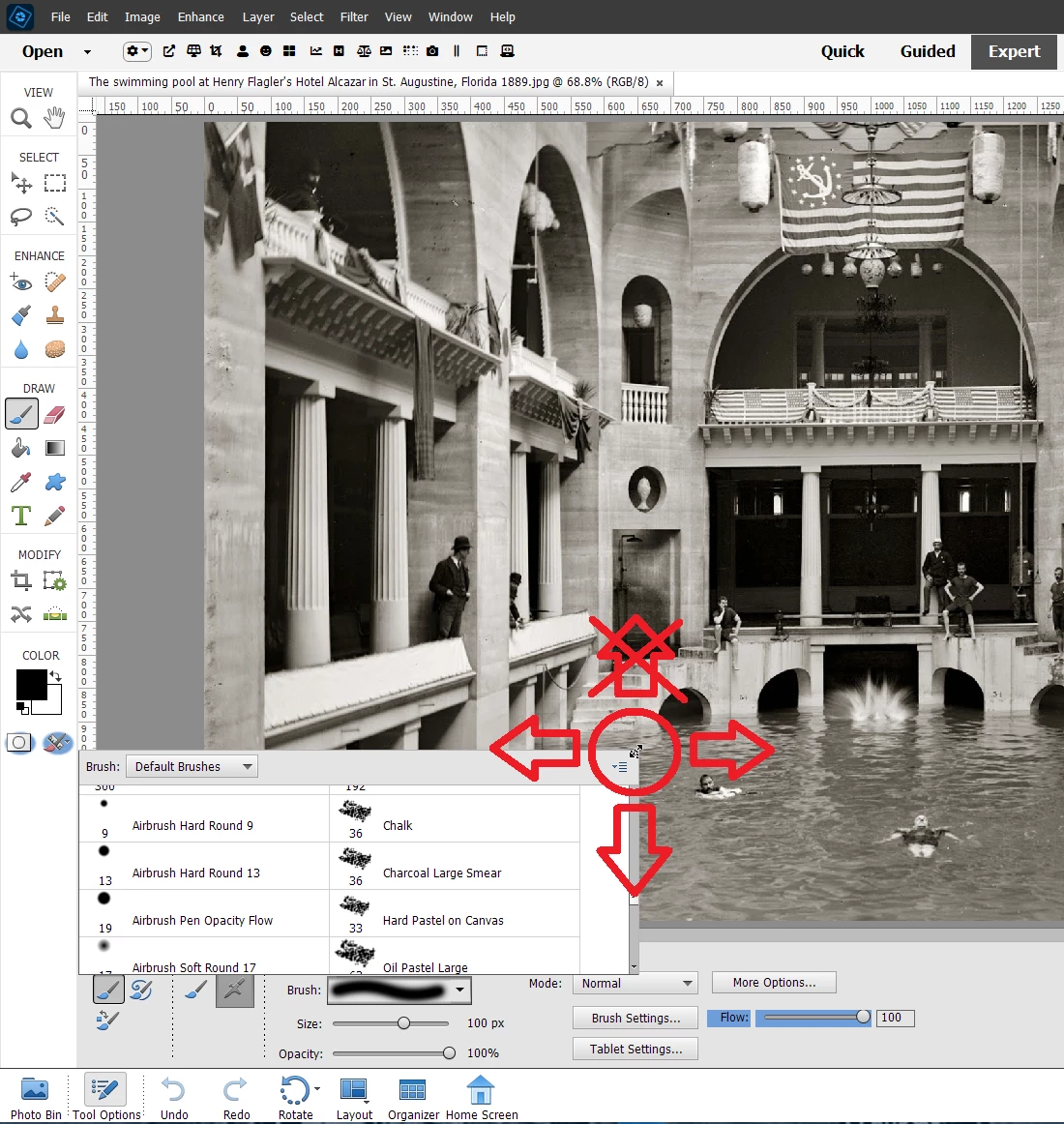

I just upgraded from PSE 2020 to PSE 2022 a few days ago when it was on sale. I just noticed that if you want to change the size of the brush menu by dragging that upper-right corner, you can NOT drag it Up. It will only drag Left, Right, or Down!

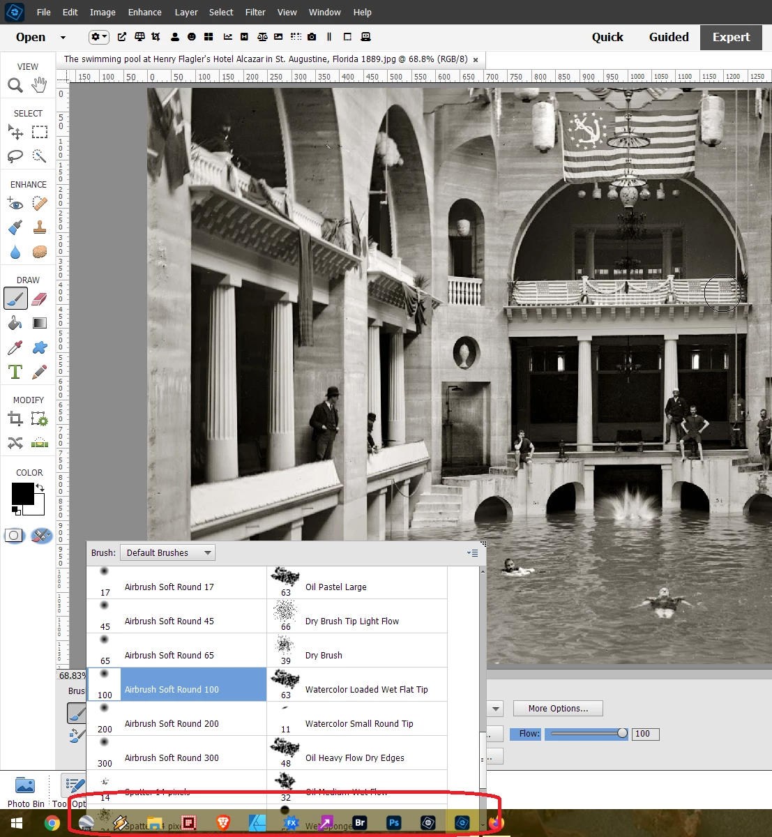

It will drag Down till the bottom is below the bottom of the window.
The next time you use a brush, the menu opens in a higher position that it did originally and it's also larger (taller).
In PSE2020, I could drag Up, Left, Right, and Down only to a minimum size.

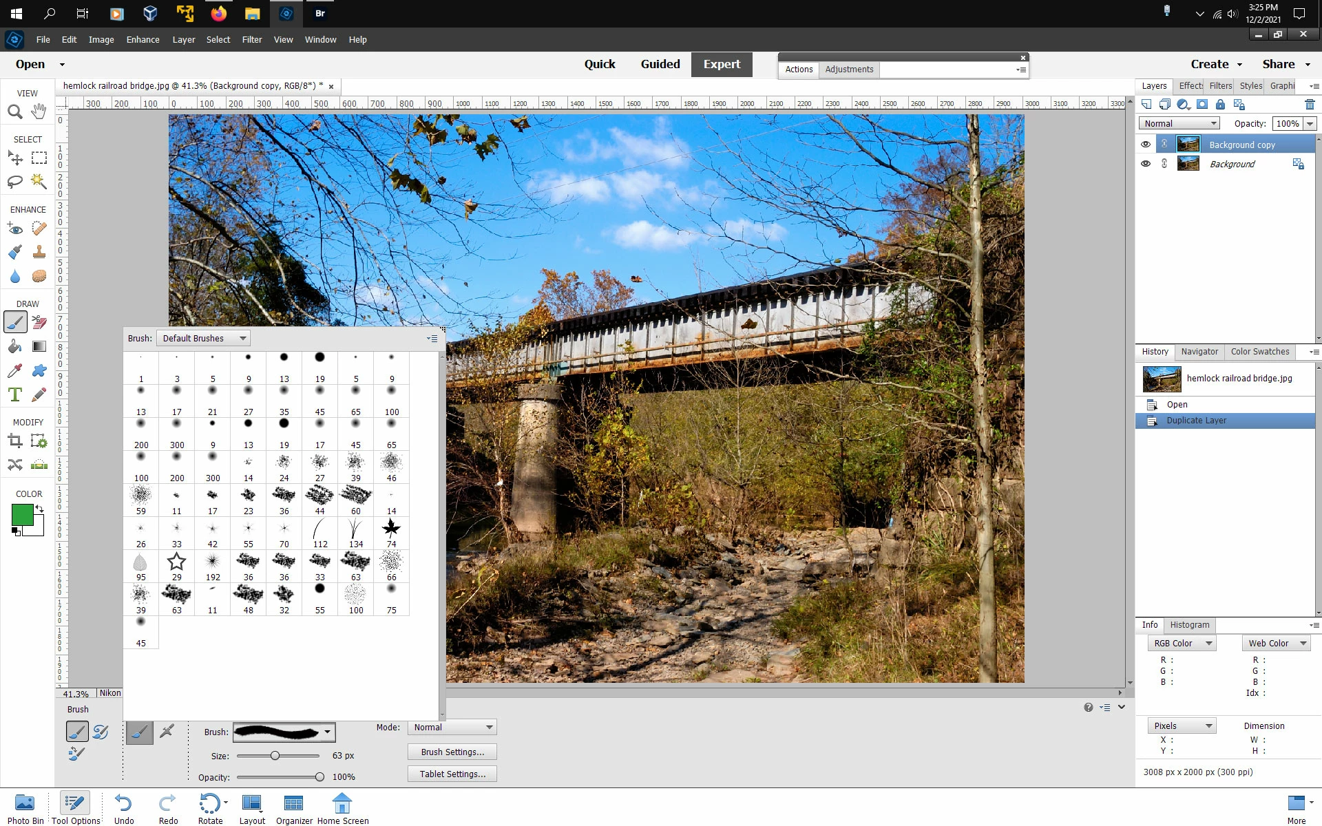

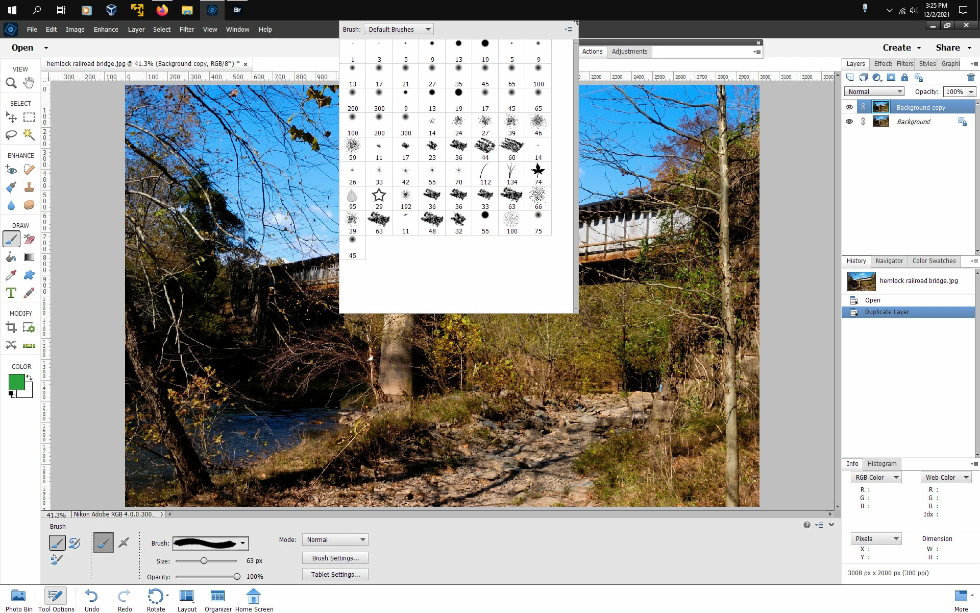

With the Brush Tool selected you can right click near the top of your document and that should give you room to resize the window and the size should be kept when you click on the Brush Preset Picker in the tool options.
