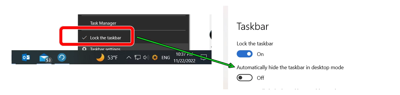

I am asking about a Windows setting, not an Elements setting.  Does your Windows taskbar disappear if your mouse is not hovering over the bottom of the screen when you use any program?  To change this setting, right-click on the Windows taskbar and select Taskbar settings from the context menu.  This will take you to the dialog where you can turn off Auto-hide if it is turned on:
