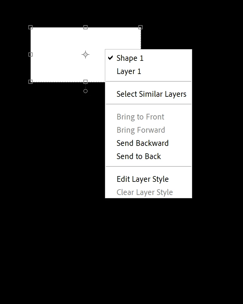

I don't know if there is a setting for this and it has just been so long I don't remember.
I used to be able to right click on an a selected shape i placed in a picture and see the style settings option in the context menu, that seems to be gone now, and I have to go up to the layer menu, layer style, style settings.
Is it possible to get this back in the context menu?

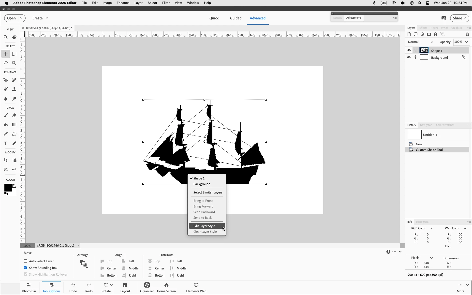

Feb 2, 2025 4:19 PM UTC
Yes, this has been fixed with most recent update as of 2/2/25.  Thanks Adobe!

Jan 30, 2025 3:28 AM UTC
Seems to be fixed in the latest Photoshop Elements 2025 update, at least here on the Mac side.
Doesn't specifically say it's fixed, however it appears to be.
https://helpx.adobe.com/photoshop-elements/release-note/update.html

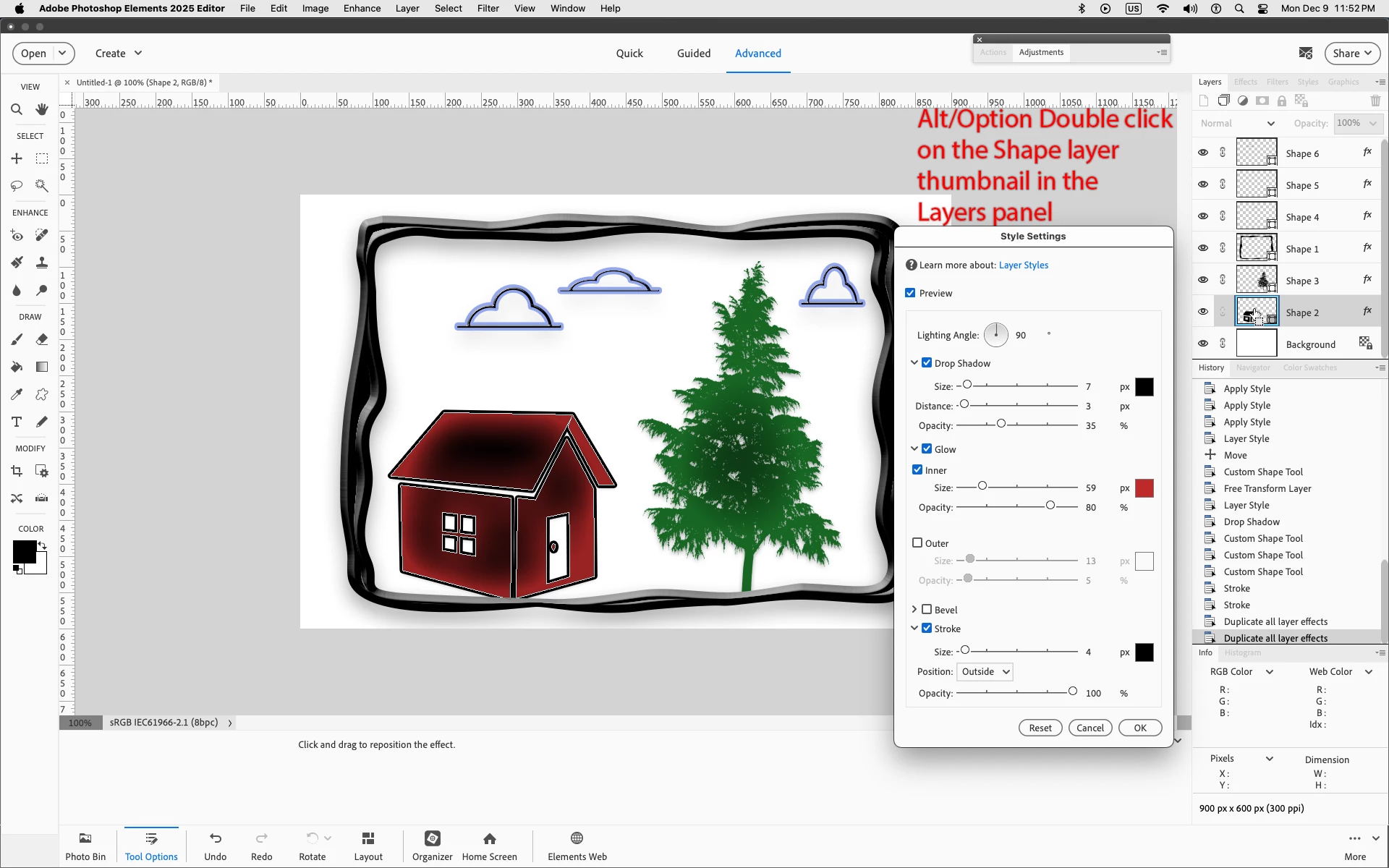

Dec 10, 2024 4:58 AM UTC
You can also Alt or Option double click on the Shape layer thumbnail in the
Layers panel to bring up the Style settings dialog.

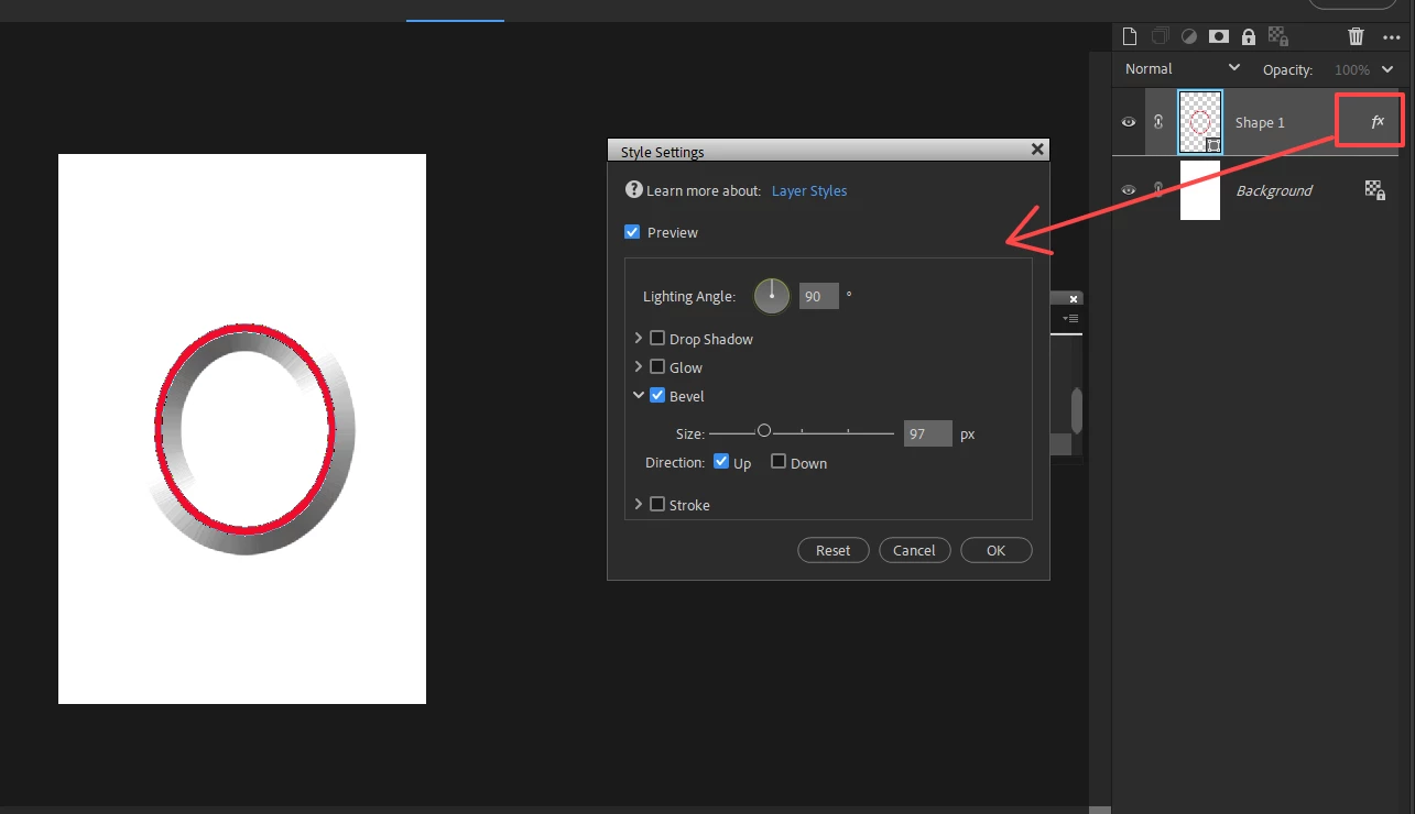

Dec 7, 2024 8:20 PM UTC
Another option to edit an applied style in Elements is to double-click on the fx icon in the layer panel.  This will bring up the  Styles Settings dialog.
Dec 7, 2024 8:57 PM UTC
I don't have the fx, maybe I am creating it incorrectly?  I just use the shape tool to create a new shape layer, then select the shape.

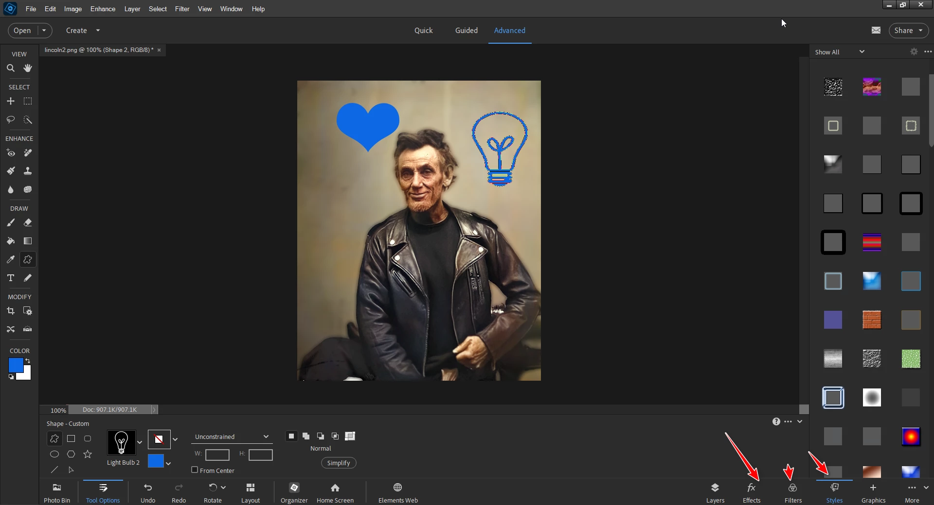

Glenn 8675309
Dec 7, 2024 7:39 PM UTC
That feature you refere to is actually part of PS, not pse.   You can still find all those things.  Look where to red arrows are.
