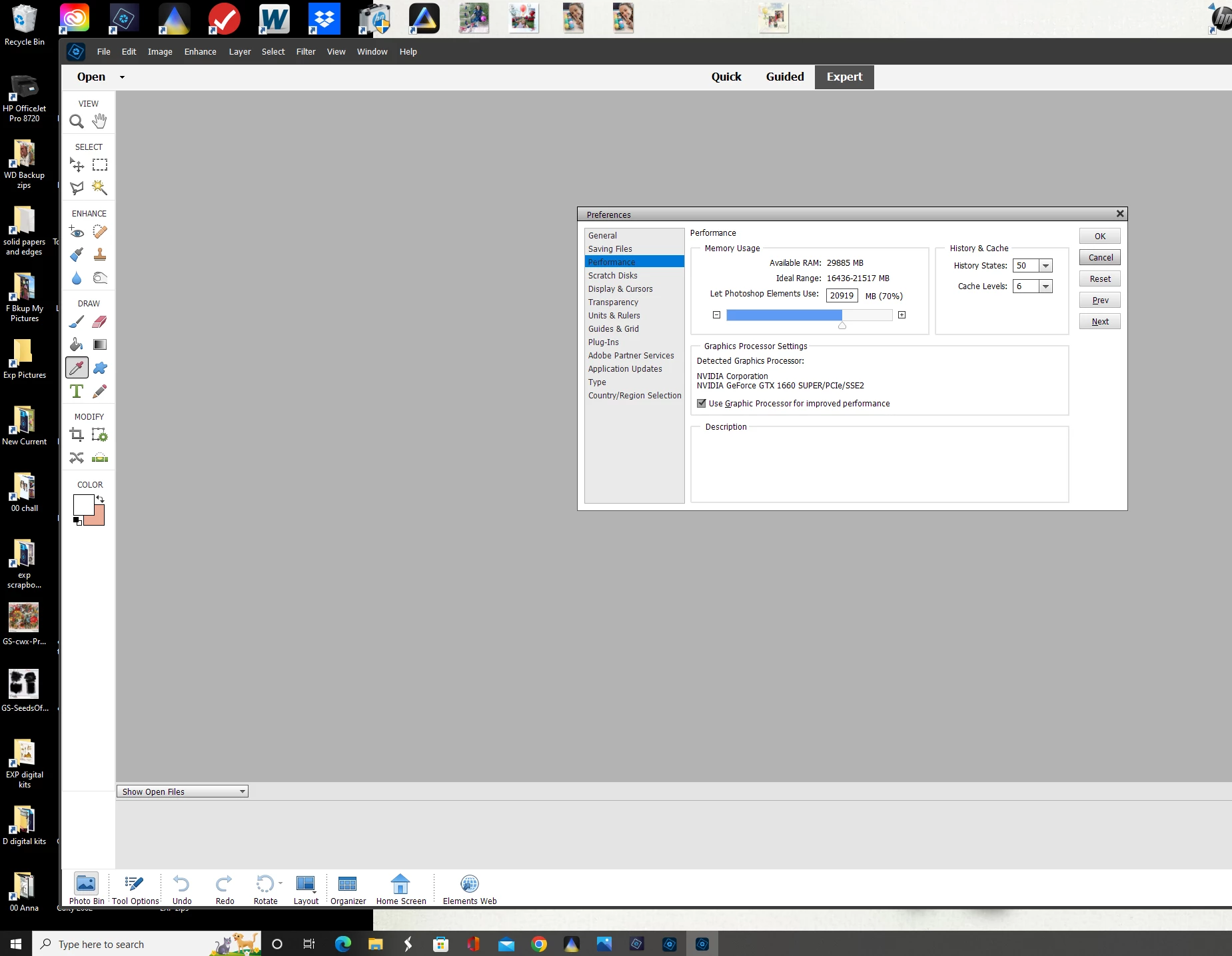

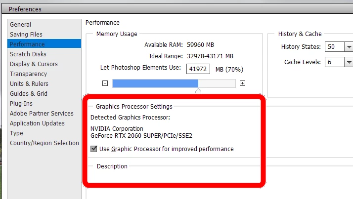

If I understand you correctly, if you close and reopen a file, the layers appear correctly.  Is that so? How much RAM do you have on your machine?  This sounds like maybe a memory leak or graphics card issue.  So, you can try changing the Graphics Card acceleration in the Edit>Preferences>Performance dialog.
And you should also update your graphics card driver from the card's manufacturer.

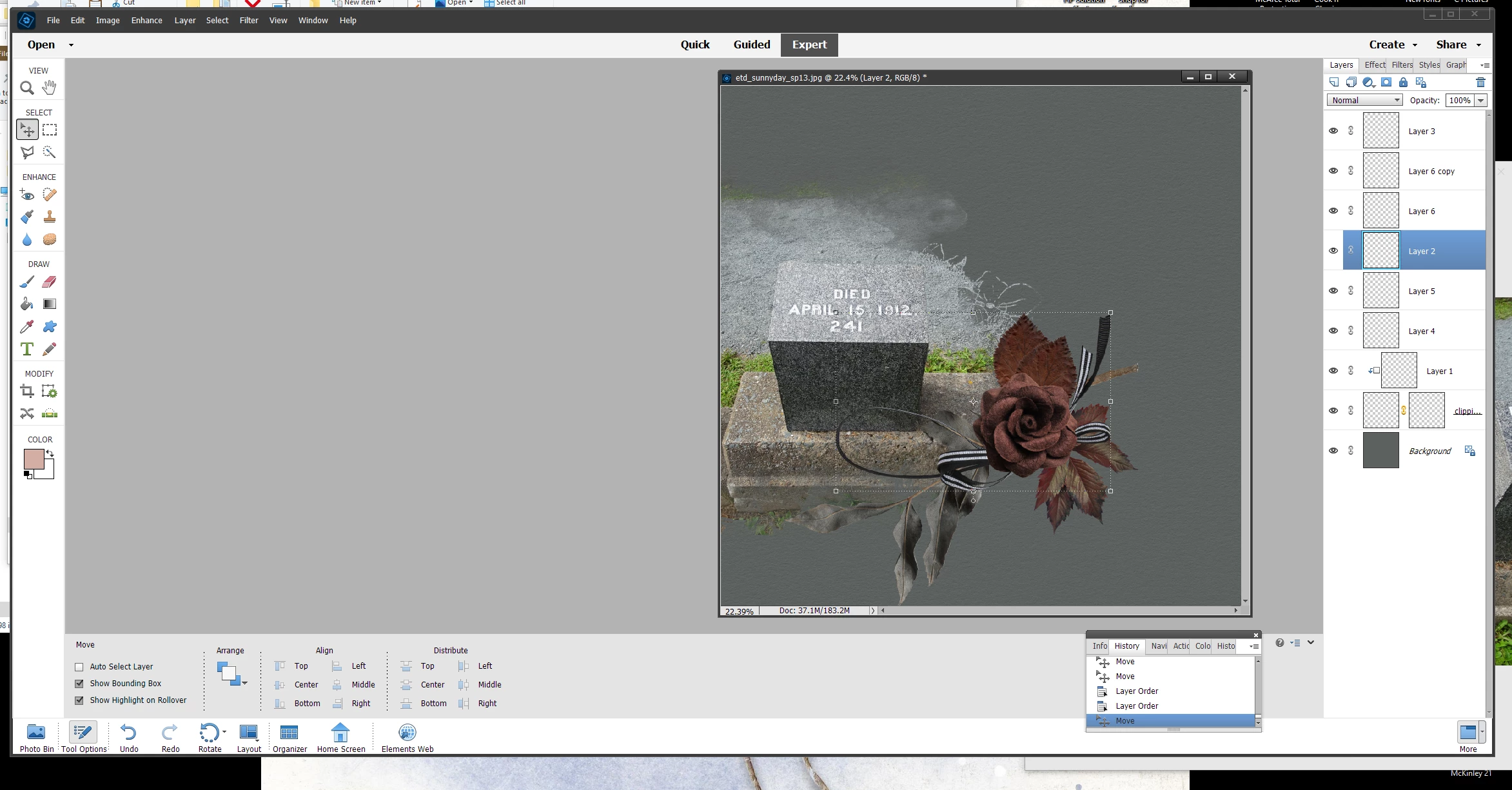

Yes, all is fine if I re-open, but new layers after that are blank.   I changed the graphics card down to 50%, opened 2 files (pngs)  both blank.   So frustrated.  Been using PSE forever, 20+ years, always update to the newest odd release (skip the evens).   Never seen anything like this.   For scrapbooking, it's completely unusable.   I end up with 30 layers or more, with many of them masked and can't see a thing!   I submitted an email to support.  They responded with  a question about my serial number.  I responded; haven't heard another word. Screenshots attached (preferences one was before I reduced the graphics card speed).  thanks for your help.

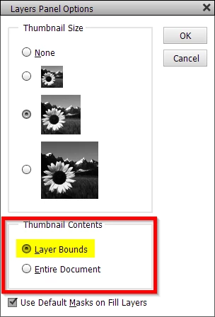

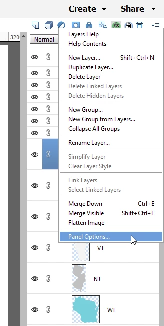

Sometimes the object in the layer is too small to be seen in the thumbnail. So, as Greg_S suggested, open the Layer Panel Options and try setting the Thumbnail Contents to Layer Bounds. It will zoom to fit the object in the layer.

Too small is definitely not the problem.   If you look at my sample, sometimes the layer is completely filled with a patterned paper.   Also, the masks don't show.   I can fill a mask with black and it stays white in the layers panel.   If I reopen elements everything is filled in, but any new layers I add, may or may not be.   It's not consistant at all.   I've gone back to PSE 2020.  This is too time consuming to work with.   So disappointing.

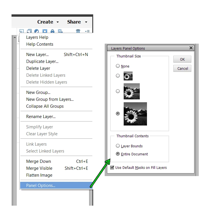

All I can suggest is to go into the Layers Panel>Panel Options and play around with changing some of the settings like the Thumbnail Size and see if it makes a difference.
