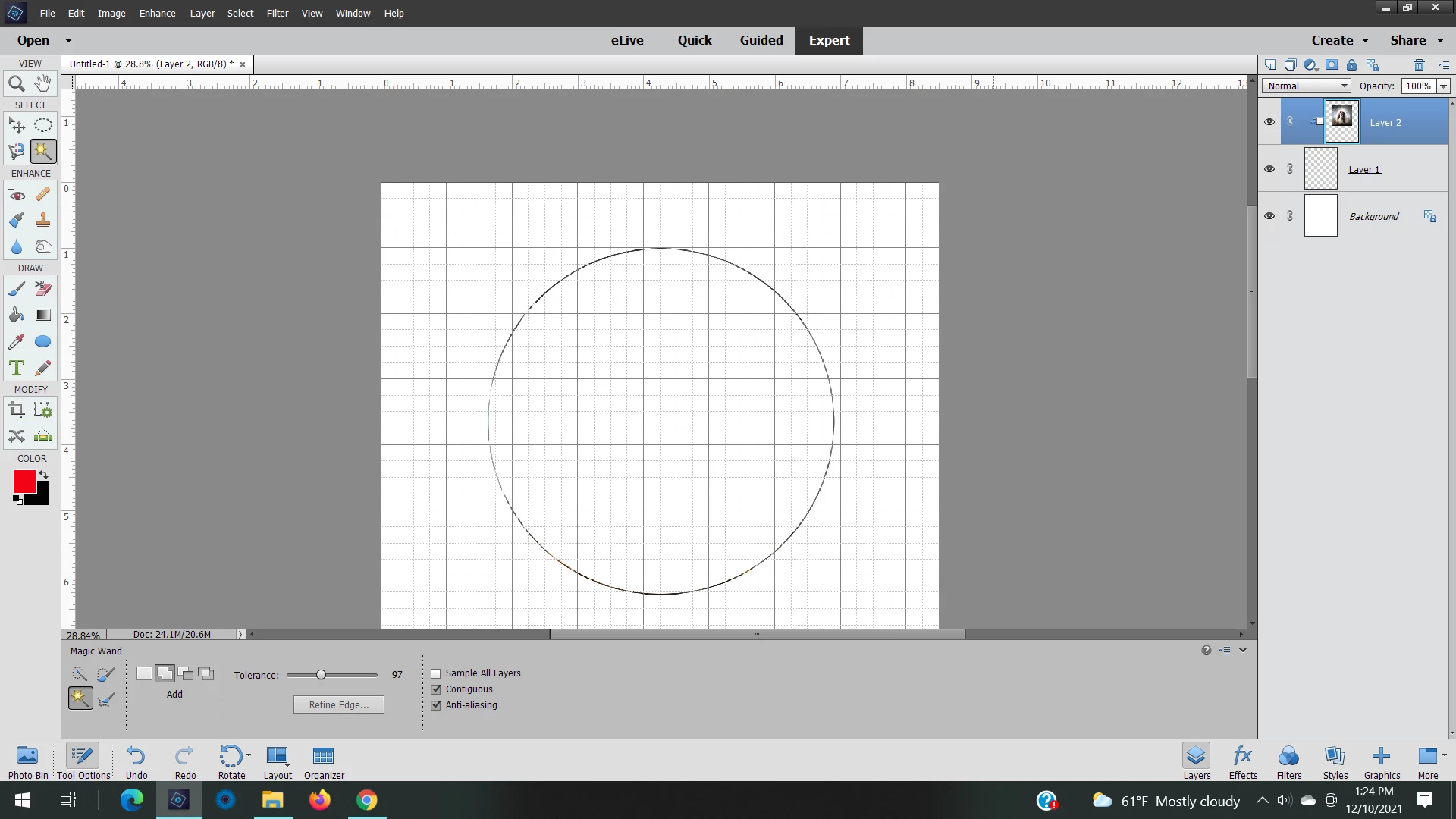

I'm still using PSE 15. I am having rouble getting a clipping mask to work. I sreated a shape on layer1, photo is on layer 2 but when I hover & alt+click nothing happens. What am I doing wrong. I've tried reversing the layers & still nothing.

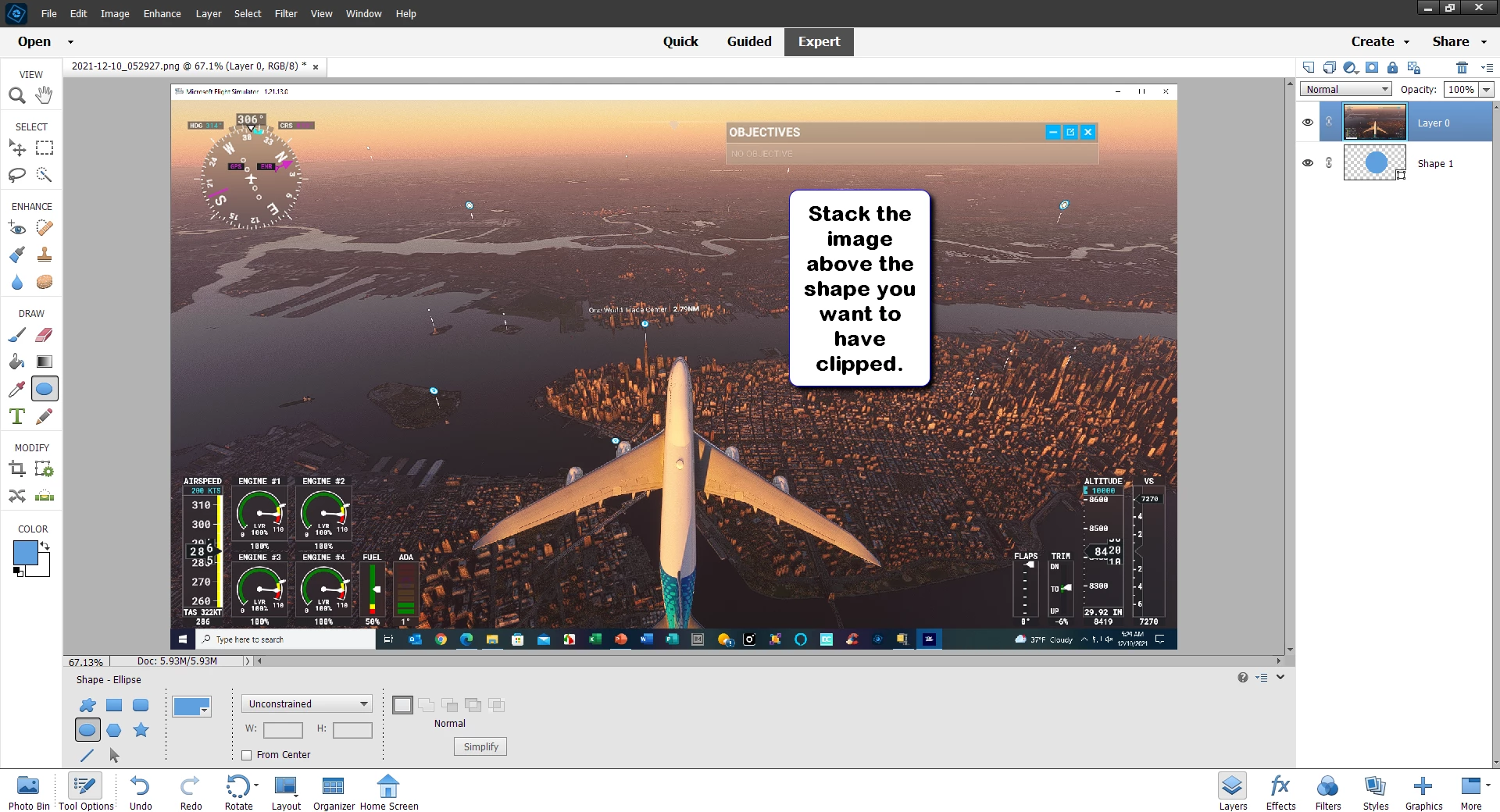

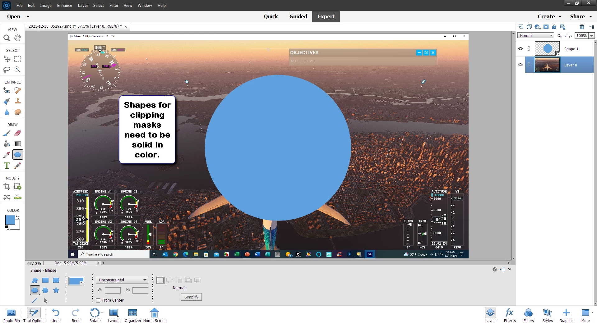

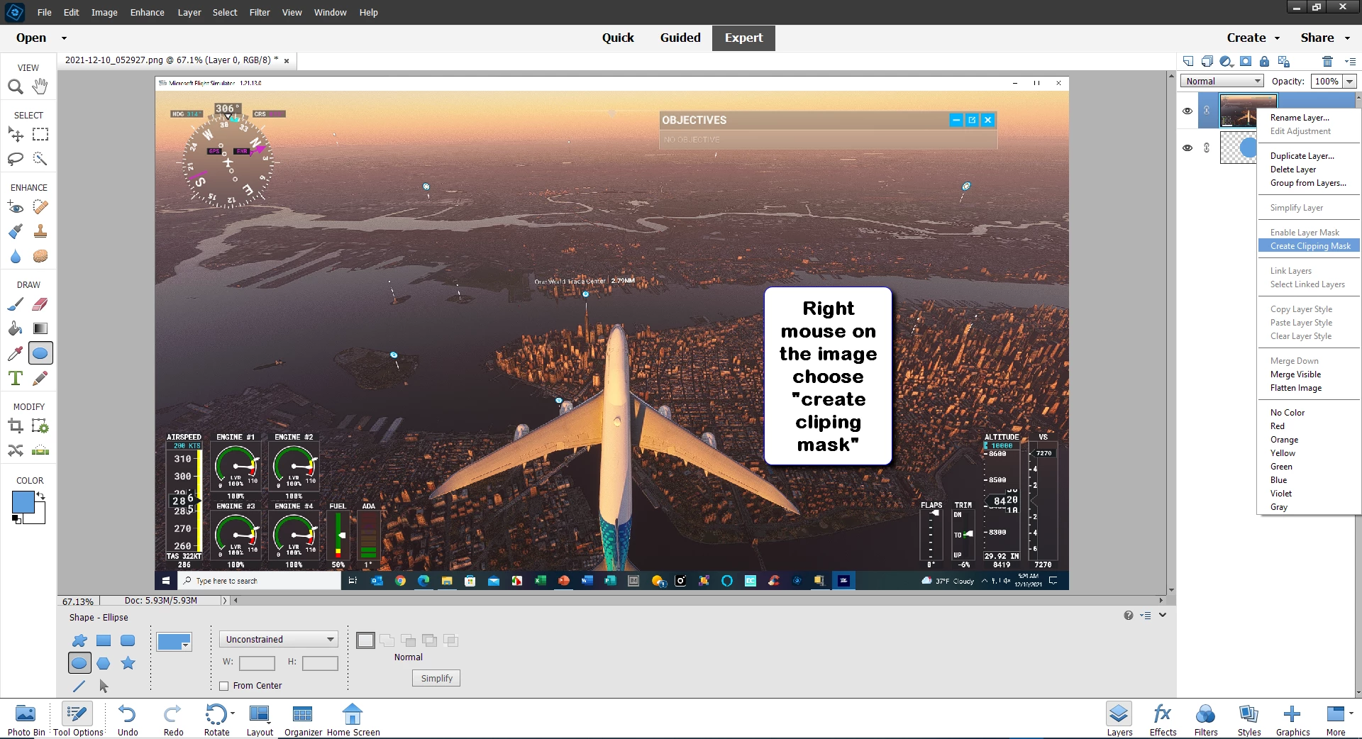

These images are from PSE 2022.  The image with the jet is from flight sim 2020.  This is how I do clipping masks.
