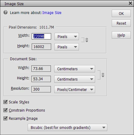

The point I am trying to make is that your file will not save as a PSD because of its size.  You can reduce the size of the file by reducing the number of pixels that make up the file.  And since you intend to print to a regular size page, you only need a maximum resolution for the image of 300 ppi.  By resizing and resampling your image, you should be able to reduce the size of the file and print it without losing too much quality in the image.  And you should also be able to save it as a PSD for further editing.  Reducing the number of pixels will also speed up editing performance.

Thank you - with all this help from you Greg and the quoting of numbers I realise where I have made my mistake. Of course I don't want the page at 29x21 inches how ridiculous!! I meant 29x21cm of course. No wonder my other pages saved ok it was just the last 2 I had problems with and a slip of my mind I typed inches instead of cm. I have a feeling that all my troubles have been solved. Forgive a foolish pensioner. My thanks to you Greg and to Michel I'm in NZ so it's late evening - I will be setting it all to rights in the morning. Thank you again for your patience in dealing with me and my problem. Good Night.

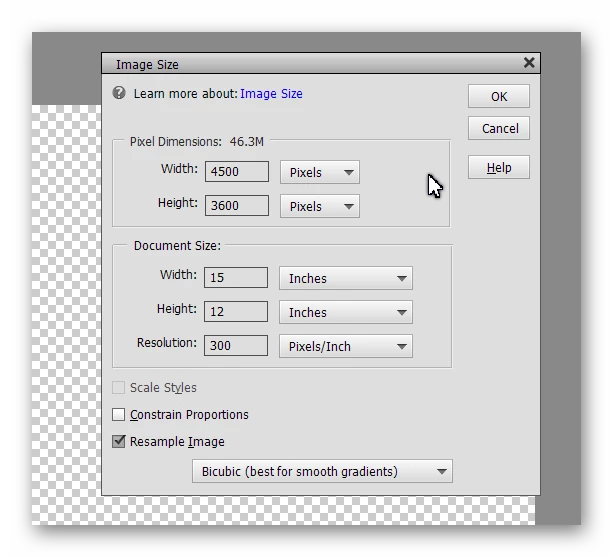

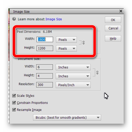

I think you could reduce the size to 25% of the current size.  For example a 15x12 inch image at 300 ppi would create an image size of 4500 x 3600 pixels.  (Sorry, but I can't think in centimeters.  😊)
So, take a look at the actual print size of your document, and figure it out from there.  If necessary, you can probably get away with a lower resolution than 300 ppi.  This will reduce the file size even further.

Hi again. I am making pages for calendars that will be printed. I see what you mean about pixels have a look at this
They are far too big aren't they. What do you suggest I drop them too to still get a good print.

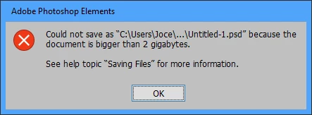

If you are talking about a scrapbook page with many layers, then it could very well be over 2GB.  How are you determining the measurement?   Can you give us a screenshot of whatever message you are receiving.
Are you able to save the page if you flatten it?
