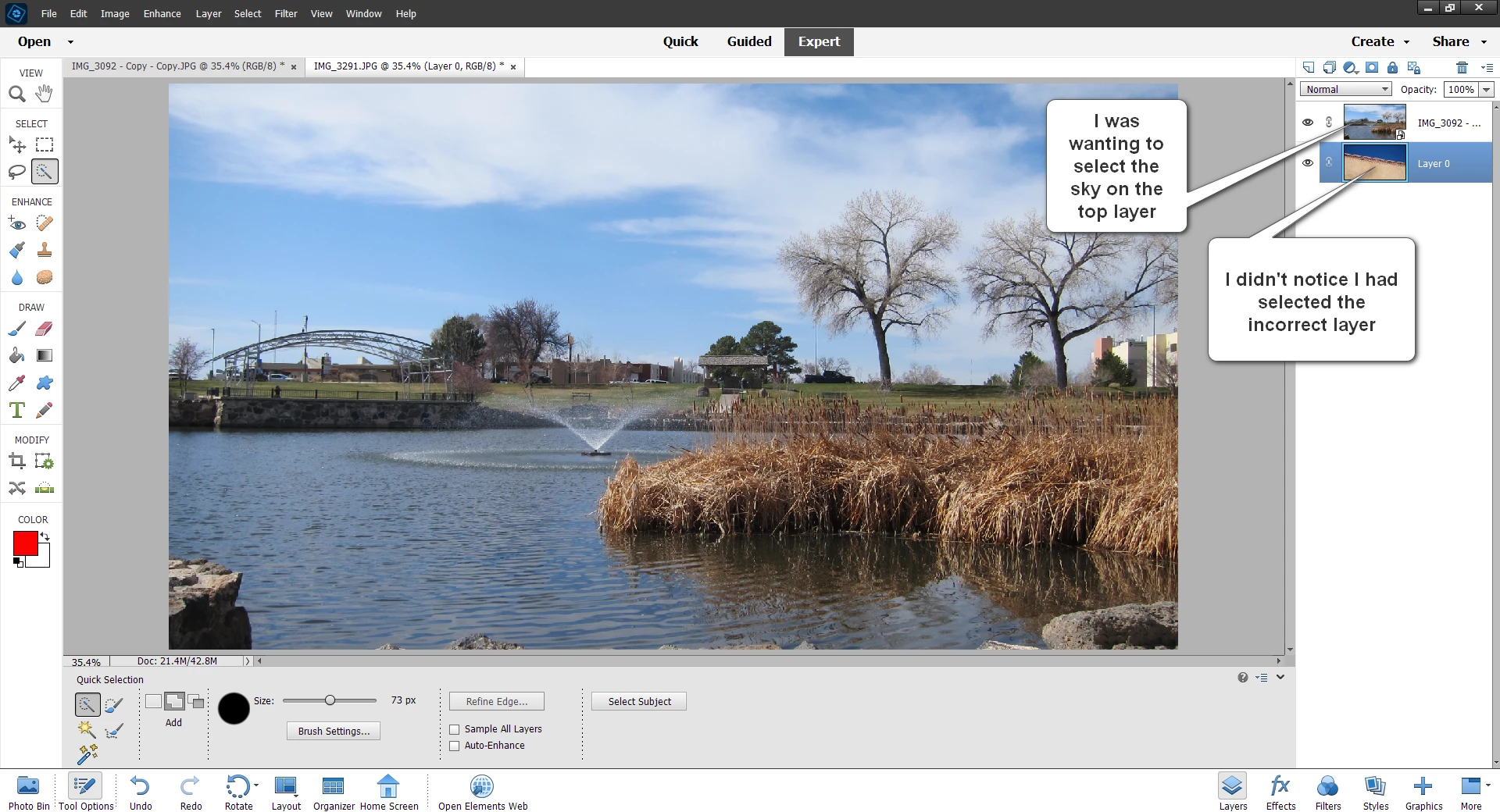

This is what happens: I first create a new layer. in this layer, I want to select the sky. I start dragging the Quick Selection tool from the top corner of the image, but it won't "snap" to the contour of the buildings on the horizon, instead it just goes over them and eventually selects the whole image. When I release the mouse button the selection disappears. Is only possible to use the tool in a background copy?

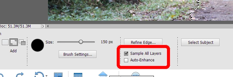

@paolovee , what exactly are you trying to do?  A new layer  has no pixels to select.  Depending on what you want to do, there are several options:
  • Check the box to Sample All Layers
  • Select the sky on the background layer and press Ctrl+J to copy just the sky to a new layer
  • Copy the entire background layer (also using Ctrl+J) and do as Glenn suggests by selecting pixels on the copy.
There are a number of other options but I'll wait for your response as to what you want to do with the selection.

Glenn 8675309
Jan 13, 2023 12:24 PM UTC
You sure you had the correct layer selected?
