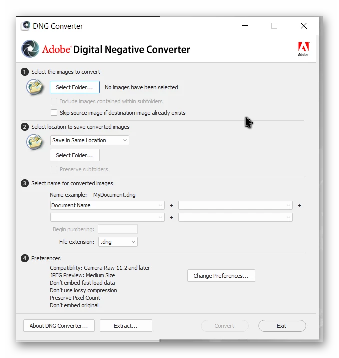

Thank, downloaded DNG but haven't figured out how to get from card to DNG converter then back into Elements 2020 so I can edit. I also downloaded the RAW_12.1_zip file and could not get it to work.
Where are you getting stuck with the DNG converter?
  • In the first box, you will click on the Select Folder button and navigate to the folder on your memory card where the raw files exist.
  • For the second box, Select a folder to save the files from your memory card.  (If you have already saved them to your hard drive, you can save them in the same folder.  The files will be converted with a dng extension so your originalNikon raw files (.nef?) will remain.)
  • You can leave the other options as is and hit the Extract button:
In the Organizer, select Import>From Files and Folders and navigate to the folder where the dng files have been saved.   The files should be imported into your catalog.  If you want to bypass the Organizer, then simply go to the Editor and use the File>Open in Camear Raw command and navigate to the files.  You should then be able to edit them.
You will probably be unable to see thumbnails of your images unless you use the Organizer.  However, on Windows, it is possible to install a free utility that will give you a thumbnail within an Explorer window.  Check out SageThumbs

Thanks, got DNG figured out to be able to convert and edit now.  Will use this till Elements updates to work with new RAW files.  Truly appreciate your assistance.

Nobody here knows when that will be.  But it is unlikely to be anytime soon.  In the meantime, your option is to use the free Adobe dng converter to process your files.
March 20, 2020
