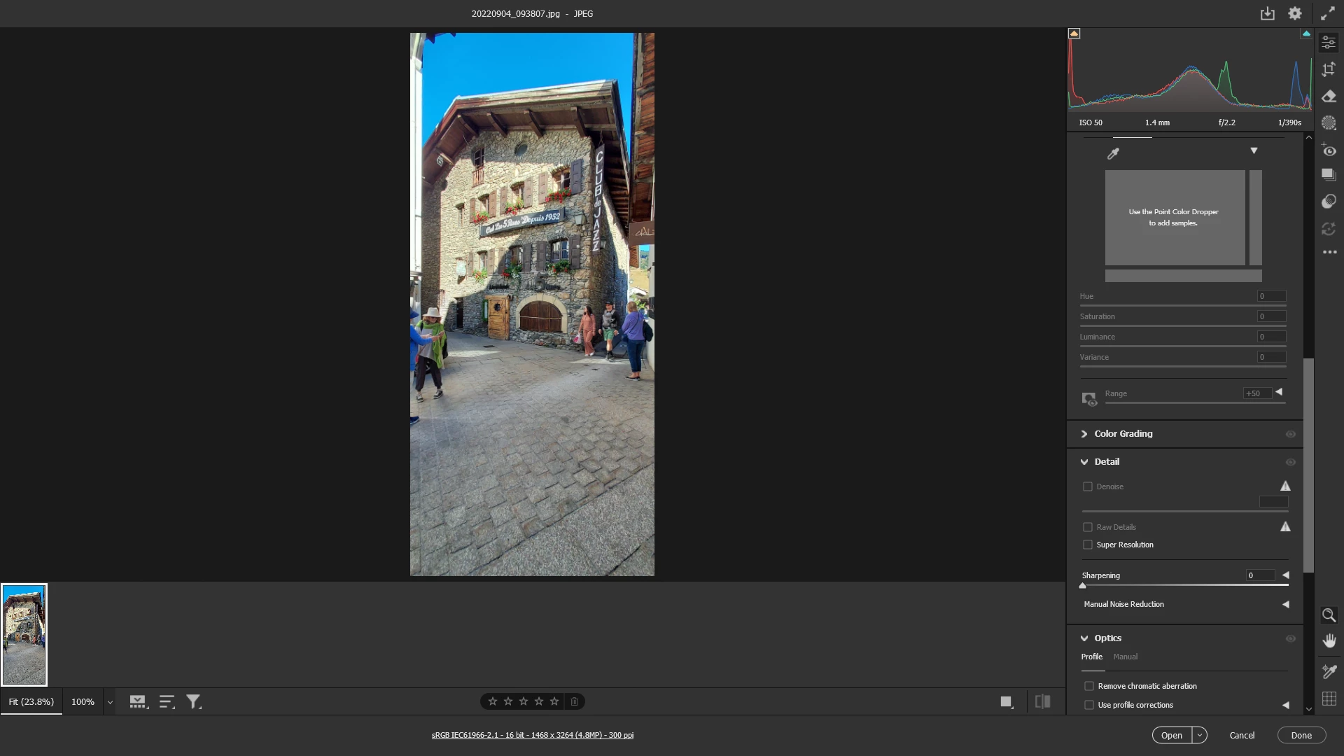

ACR installs 18.0 with PSE 2026.    It's a "scaled back" version of the ACR you find in photoshop.  99.9999% of features you may read about that are new in ACR only apply to photoshop.
" Curious as to why Elements wouldn't default to the latest download of the plug-in."   I think it's because the majority of users don't use it.   I wish it, and organizer were optional add ins "Oh you want the image organizer AND you want adobe camera raw?  That will be $20 more dollars please".   Kick those 2 items out of the basic install and lower the prodduct price $20.
PSE should have a "Hey, there is an update to ACR for your version, want to install it?" feature.
I set up one of my cameras to shoot in RAW.  No what? Makes no difference, for me, joe schmo average   user.
Not all users even think about acr, their lives and image editing are not affected one bit by not using it.  "But goodness  Bill, you tell me you only have ACR 16.1?  Version 18 is out, so you better get it" 18 is better than 16.1".
Users sometimes will wrap their heads around Adobe Camera Raw, "investigate" it and determine "By golly I always must have the latest version of raw  simply becuase it's the latest"  I manually install whatever the latest version just to see how it works.   When I get the time I check backwards compatibility with previous versions.    You simply cannot get ACR version 18.0 to work with PSE  2014-- there is an upward limit to compatibility.
Below is what ACR looks like in photoshop.  No, you can't get this version for pse.
