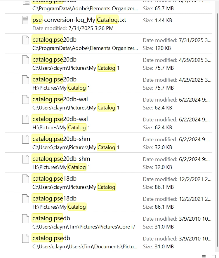

Based on your screenshot, I'm thinking that your best bet will be to try (re-)converting the database located at
H:\Pictures\My Catalog 1
This appears to be the most recent catalog created with Elements 2020.  It also contains a catalog file the same size as a catalog stored on your C drive in the default location.  Based on your other answers, this may be a backup of your catalog that has been restored to your H drive.  But I'm not sure.
What is puzzling to me is that your search did not find any Elements 2025 catalogs (with a file named catalog.pse25db).  So, it is possible that a prior conversion may have failed.  But even if that were the case,  you should still have had a new catalog created in the default location on the C drive when you launched the program.
Perhaps give us a screenshot of the H:\Pictures folder for more clues?

It appears I have multiple catalog files. The attached screenshot shows the results of a search for catalog.pse on multiple drives. The C: drive is where PSE insisted on storing everything in previous versions. My intention is to keep all my photos on the H: drive.
An external disk holds a PSE backup from 12/7/21. My records show I purchased PSE 2022 on 11/29/21, and I imagine I did a backup shortly after the install. The folder holding the backup is 46 GB with 45K+ files. Most are named B00xxxx, with one Backup.tly and one catalog.buc.
