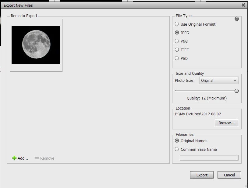

Using the Organizer is also an option for batch converting the tiffs to jpegs.  Simply select the tiff files and go to File>Export as New File(s).  This gives the option to change the format to jpegs (and gives a more granular option for the quality of the jpegs than the Editor's batch processor).
No existing jpegs with the same file name will be overwritten because the OS will not allow it.  Instead a numeric suffix will be added.  (And I can't imagine how the original tiff could be overwritten using this method.)
If the original folders are within the Watched Folders hierarchy, the new jpegs will be automatically imported upon the next launch of the Organizer.
