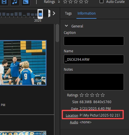

When you select a missing file, where does the Organizer think it is? (This should be displayed in the reconnect dialog but you can also look in the Information panel under the Location link.  If the location is not fully displayed hover over it to see the full path.)  Does that give you any clue as to why the file is missing?

When I look at LOCATION, it shows a place on the hard drive but when I go there, the image is not there.  When  I search the hard drive, it does not find it.
