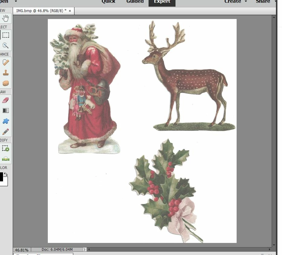

hatstead, Thanks very much for your quick reply. Do you mean the pixels dimensions or the document size drop downs?
Because I tried both, and ended up with teeny tiny images, like way too small. Here is my original scan, three images on one 8.5" x 11" sheet at 200 dpi, saved as BMP.  I'm not sure if I was clear in my original post, but I need them to each be 60% smaller.
What might I be doing incorrectly? Thanks!

December 18, 2020
Try this instead:
1. Go to File>new>blank file and enter the dimensions for your canvas (8.5"x11"), resolution 200 px/in, background to suit.
2. Go to File>Place and point to Image #1. Place. This will come in on a separate layer. Use the corner handle of the bounding box to resize the image, and position it.
3. Repeat for images 2 & 3. At this stage you should have 4 layers,
