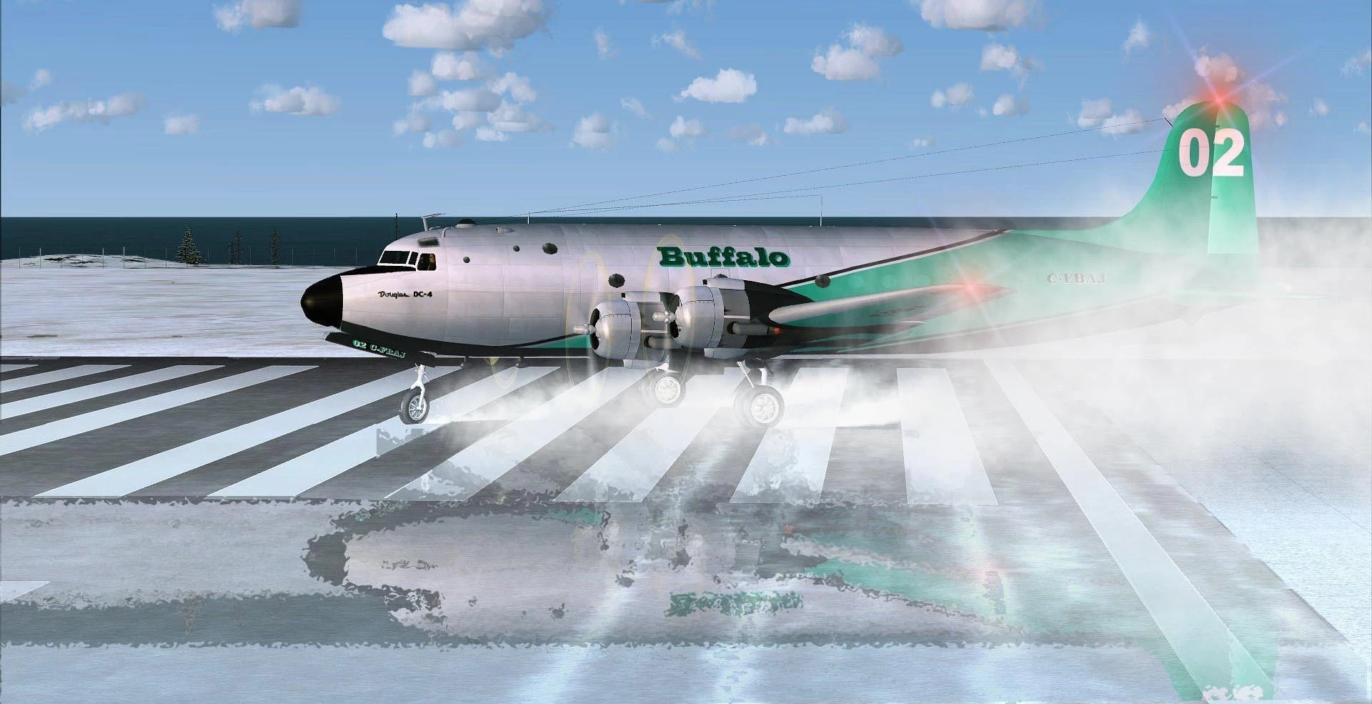

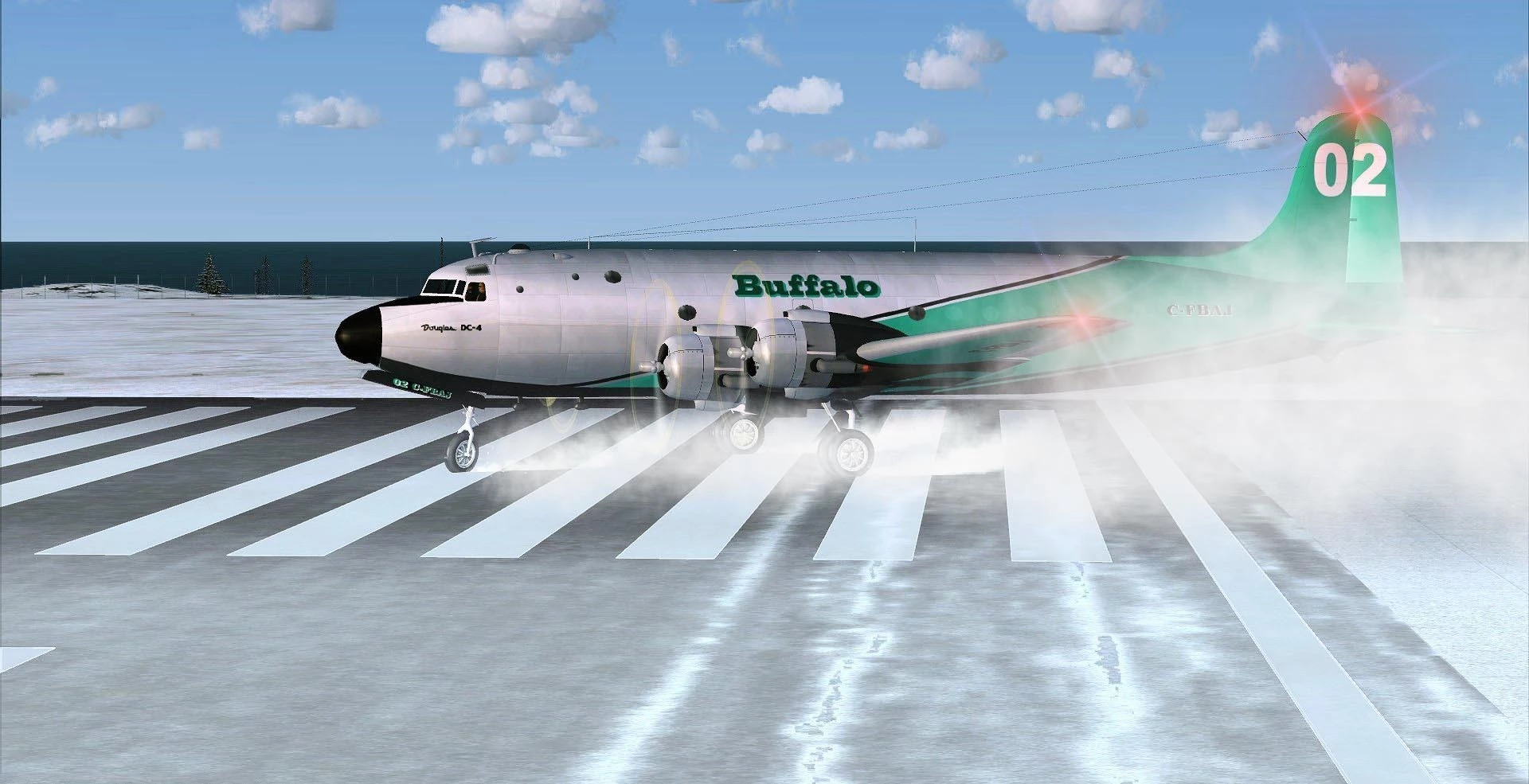

Hello all Photoshop Elements pals,
I just bought Photoshop Elements 2026 because I was told that this new software could do far better job and would be more powerful than Photoshop 5.0 CS that I have as well as than both Photoshop Elements 2023 and Photoshop Elements 9.
However I have interesting problem as seen on the two screesnshots below before water reflection and after water reflection.
From the second screenshot, you can see that on right side, the big white strip runs through the water reflection which is correct and realistic considering the fact that water is on top of the white strip.
But look at the stripes in front of the front landing gear wheels, you can see that piano lines run through the water reflection which is correct as water is on top of the piano bars BUT look at the wierd paino bars in angle appearance which is not correct. I have been making tons of screenshots showing cool reflections WITHOUT WITHOUT problems regarding piano bars on runways on Photoshop CS 5.0. Unfortunately, in my new Photoshop Elements 2026, you can see weird problem.
What can I do to fix it please?
Aharon

    Jeff Arola
    Jul 20, 2026 9:29 PM UTC
    Yes that looks much better.
    Nice work.
    I think that particular runway has lines at a odd angle that when the opacity is reduced give a very odd look.

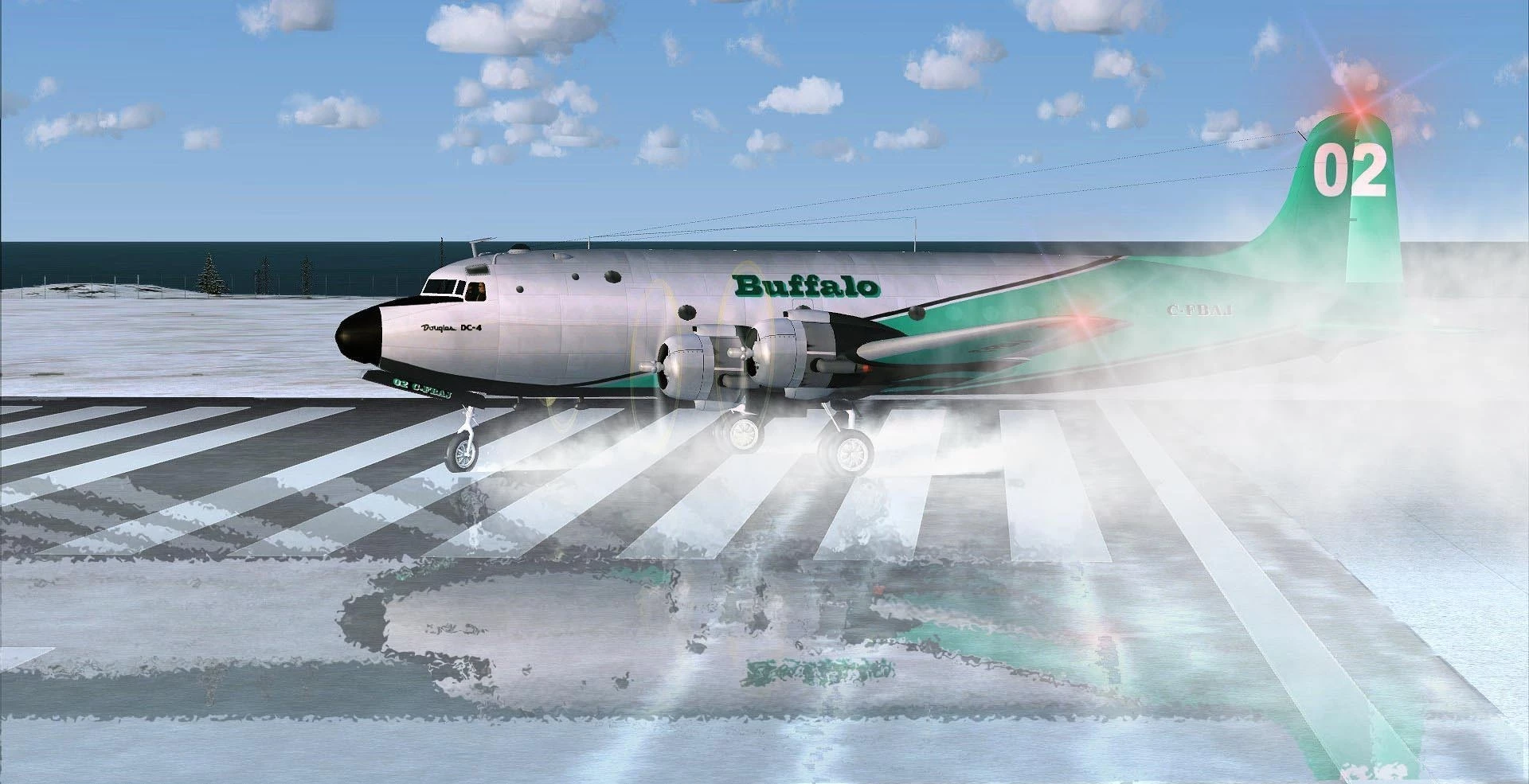

    Jul 21, 2026 1:31 PM UTC
    Yes that looks much better. Nice work.I think that particular runway has lines at a odd angle that when the opacity is reduced give a very odd look.
    Jeff,
    Thanks!!!  You might be right that it is caused by the runway’s piano bars showing odd angle in pre-edited screenshot.  At least,  PSE2026 has proven that it can do precise same job as Photoshop CS5.1 by having opacity functioning properly without displaying checkerboard unlike PSE2023 did.
    Thanks for your help.  When I am satisfied with testing the new PSE2026 for my aviation themed screenshots that required advanced reflection editing and tire smoke or snow splattering paint brushing editing, I can retire Photoshop CS5.1. I am having hard time believing or imagining that PSE2026 can replace extremely powerful Photoshop CS5.1.
    Aharon
    Jul 20, 2026 4:59 PM UTC
    Jeff Arola,
    I repeated the editing using Photoshop CS5.1 and to my surprise, for first time in about 15 years, CS5.1 failed to show correct reflection and still had same the runway/s weird angle piano bars problem.
    So I decided to solve the problem by using PSE2026 to copy piano bars from pre-edited screenshot and pasted on the edited screenshot with water reflection. Now it looks better.
    Aharon

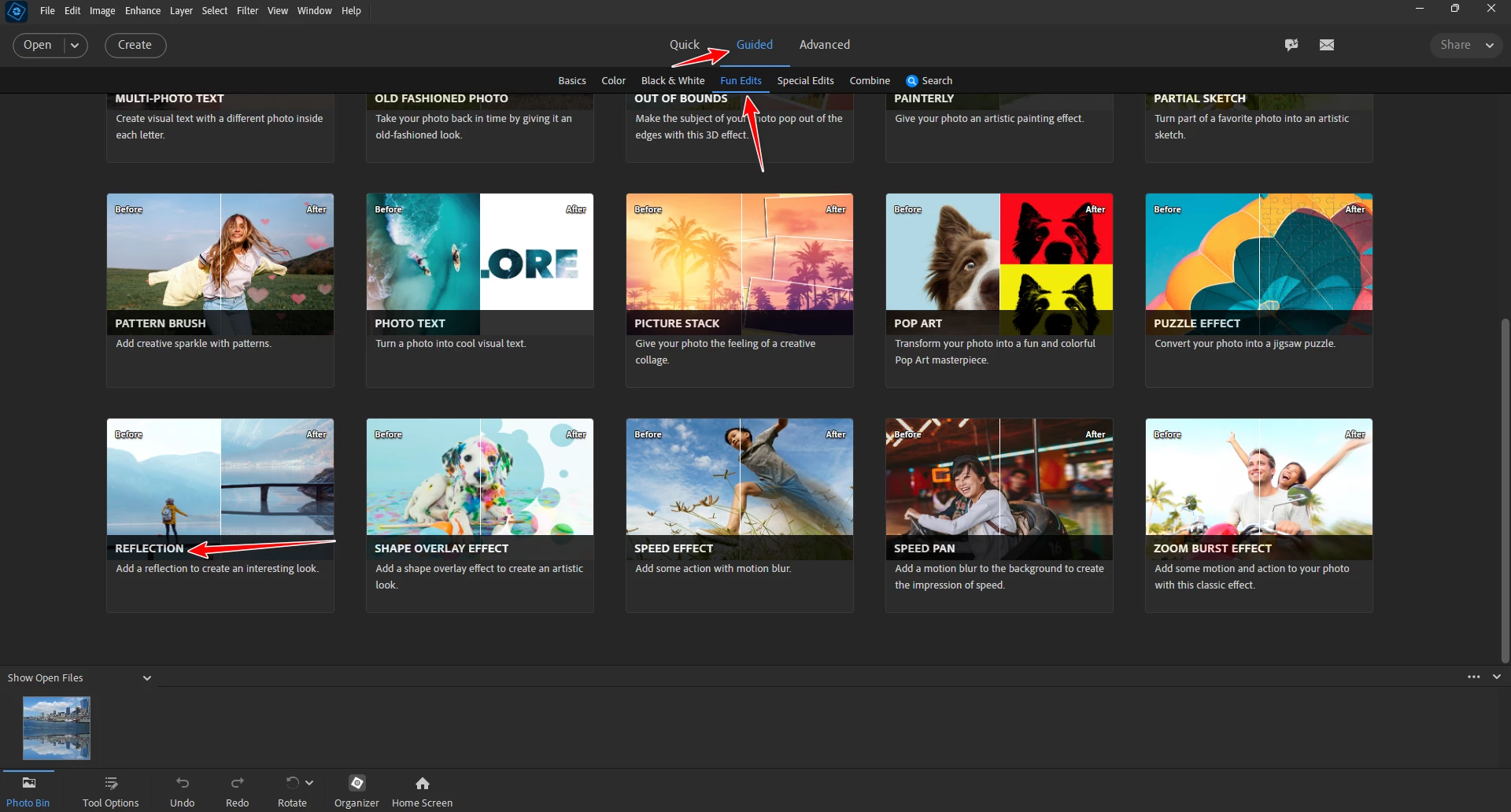

    Glenn 8675309
    Jul 19, 2026 12:04 AM UTC
    have you tried using the guided edit in pse 2026?
    Jul 19, 2026 2:06 PM UTC
    Well I do not know what is guided edit because I prefer advanced edit which gives me more tools on the left sidebar. I just repeat all my methods from CS 5.1 and apply to PSE2026.  Sorry if I am TOTALLY new to PSE2026. I just prefer CS 5.1 techniques that I want to apply on PSE2026 and I even avoid AI stuff.  No offense to you and all Adobe professionals.
    Aharon

    Jeff Arola
    Jul 18, 2026 5:43 PM UTC
    Can you describe the steps in each software, Photoshop CS5 vs PSE 2026 so maybe we can spot the step(s) that are causing the difference in visual appearance?
    Jul 18, 2026 6:08 PM UTC
    Mr. Jeff Arola,
    Interesting question
    Funny thing is that I actually used precisely same “step by step” steps in the both editing softwares that you were asking about. In other words, whatever I did in CS5.0,  I use same methods on PSE2026. I bought PSE2026 because Adobe refused to allow me to move CS5.0 from retired laptop to new laptop.
    Step 1: Use rectangular tool to create square on top of the screenshot from the bottom of the wheels to top of the screenshot and then copy that selected square.
    Step 2: Use “straight” lasso to create my desired area on bottom of the screenshot from the bottom of the wheel to bottom of the screenshot while avoiding snow areas on both sides of the runways and I am just focusing on selecting only runway area.
    Step 3:  using “paste on selection” to paste the copied area on my selected area specified by straight lasso marking and then flip it to turn the plane upside down. Then selected opacity to reduce to 50 percent in order to make runway markings visible through water reflection and then selected distortion effect to pick water ripples.
    That is it.
