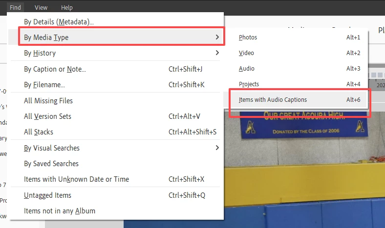

And if you want to find all of your photos with (unwanted) Audio Captions, go to Find>By Media Type>Items with Audio Captions (or press Alt+6).

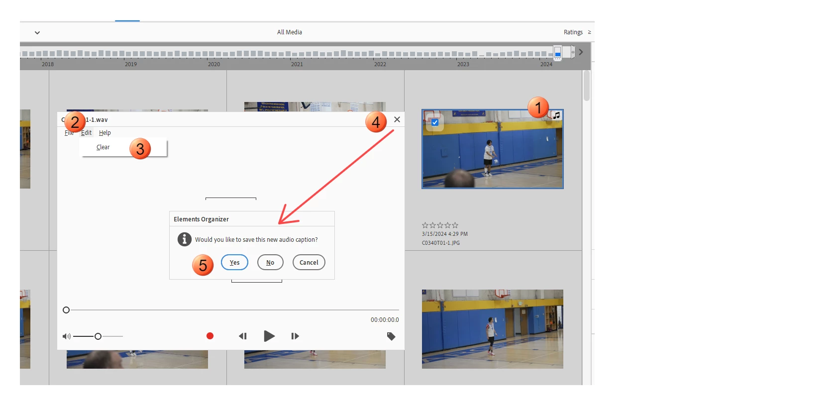

RIght now, I can only tell you how to remove one audio caption at a time:
  1. Click on the audio caption icon in the top right of the photo thumbnail (a dialog will appear)
  2. Click on the Edit menu
  3. Select Clear
  4. Click on the Close Window X  (another dialog will appear)
  5. Select Yes
I seem to recall that I once found a method to clear the audio captions from multiple images at a time.  I will see if I can find that option.  (I may be wrong about that.)
