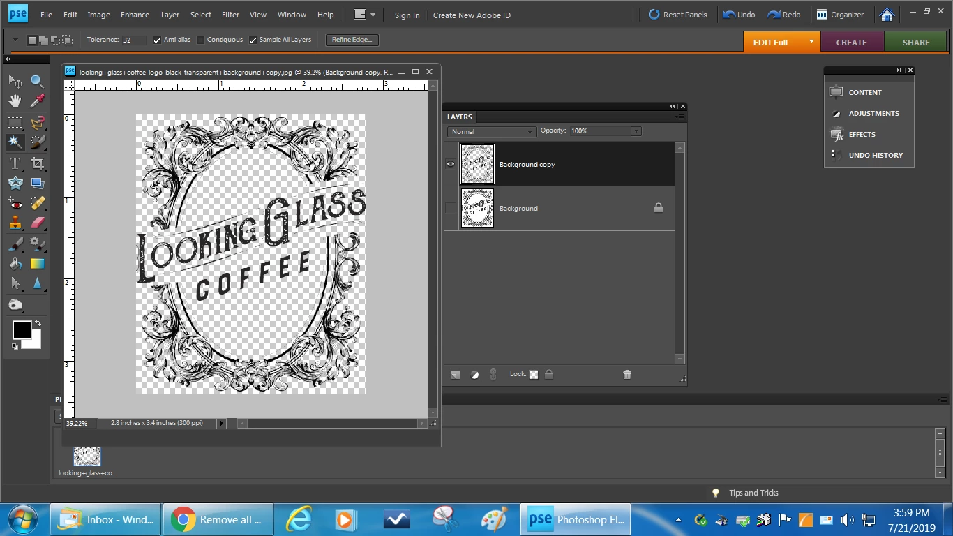

    1. Open the picture file
    2. Duplicate the background layer and shut off the visibility of the background layer. Work on the background copy layer
    3. Activate the Magic wand tool, set tolerance to 32  (default), and uncheck "Contiguous." Left click on a white area and hit Delete on the keyboard.
    4. Press CTRL+D to get of of the marching ants.

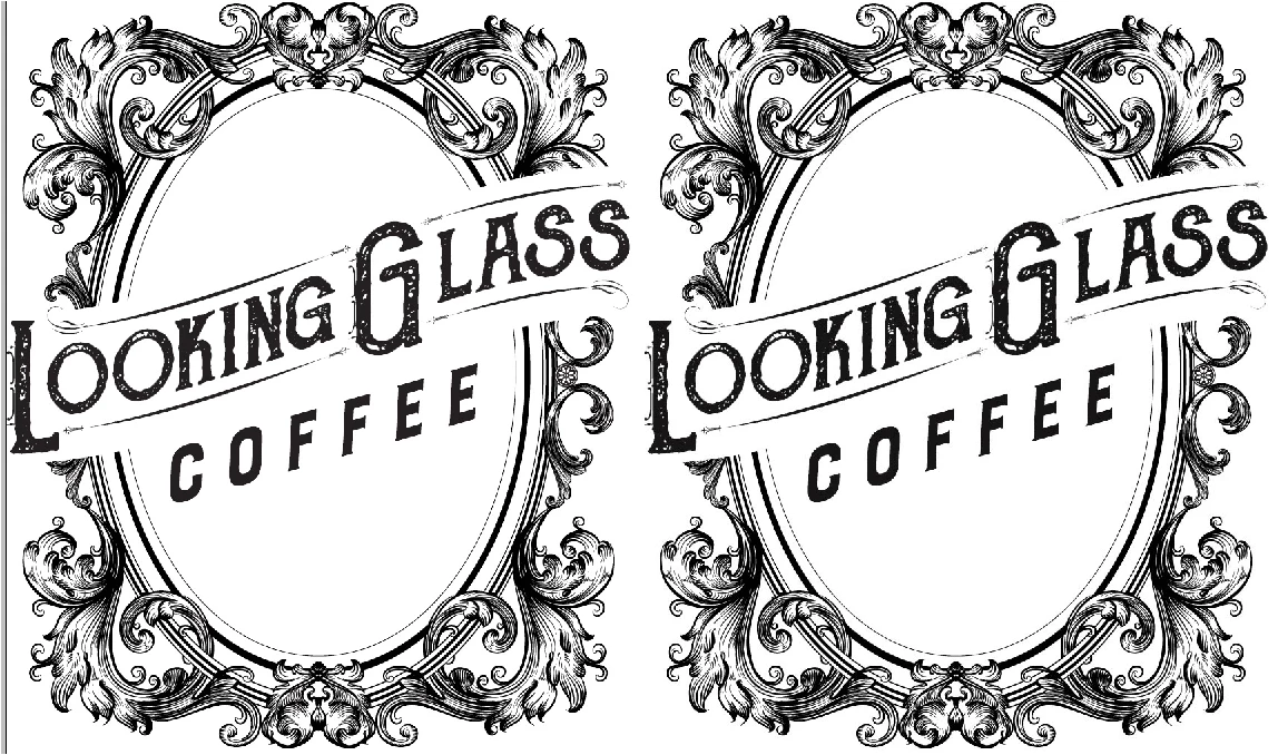

    lgclaura, for an extremely detailed logo like your example, using the Magic Wand can fail to pick up all the white or even remove some of the logo.  Here is the before-after using the Magic Wand. You can see how some of the fine black lines in the logo have disappeared.
    There is a free PSE add-on KillWhite which does just that: replace white with transparency.
    KillWhite | Mike's Extra
    Here is before-after.  Nary a change!
    lgclauraAuthor
    July 24, 2019
    Holey moley, you're right! The one on the left was made with the magic wand tool while the one on the right is the kill white filter. It's much denser. This filter is awesome - thank you!!

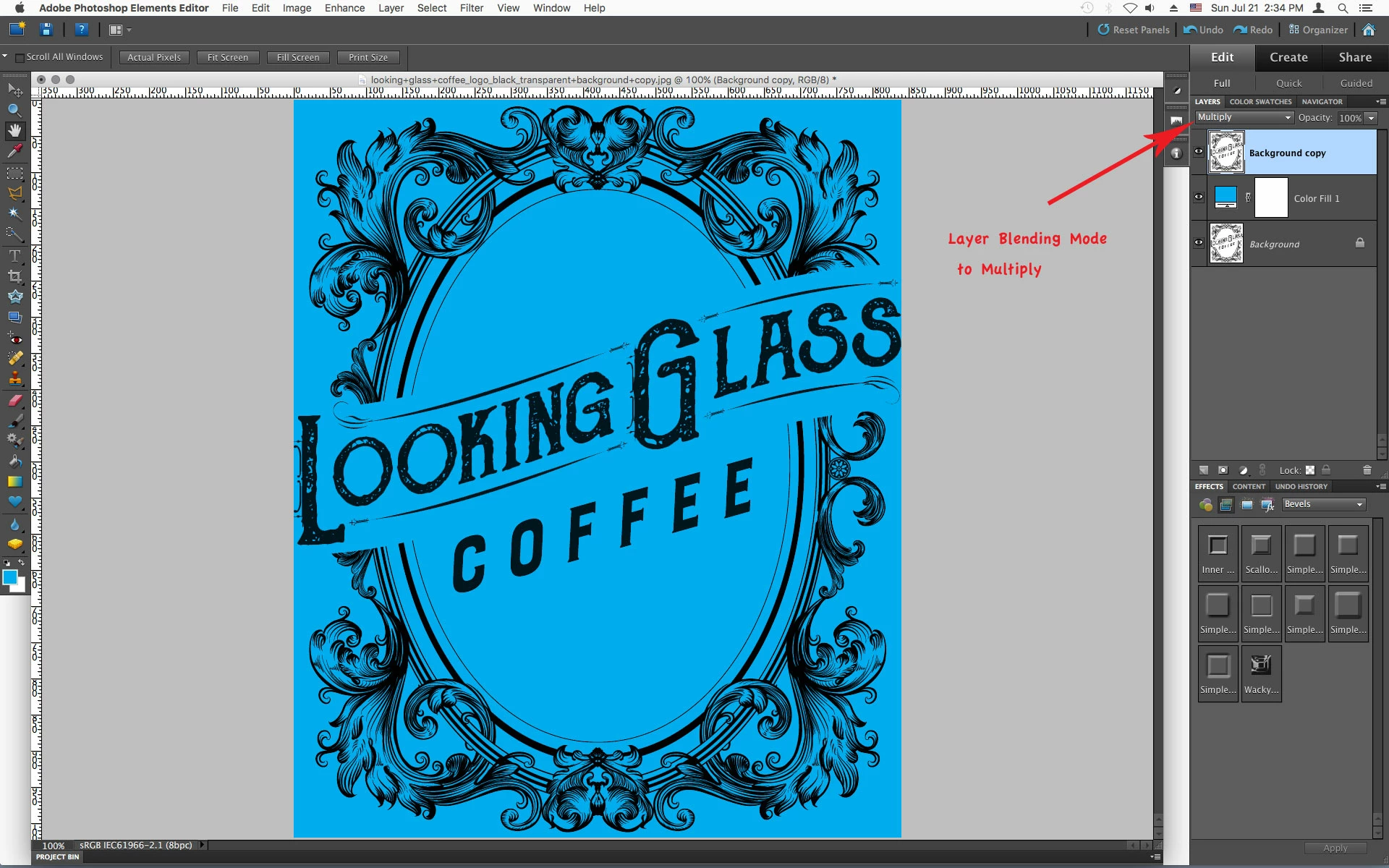

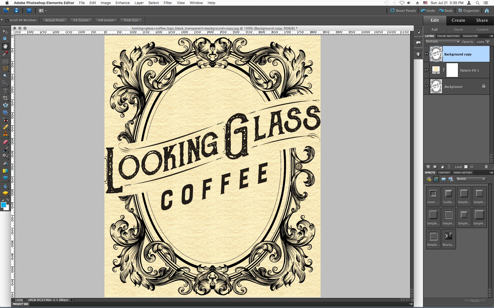

    If you want to put your image on a background other than white you can change the Layer Bending Mode to Multiply.

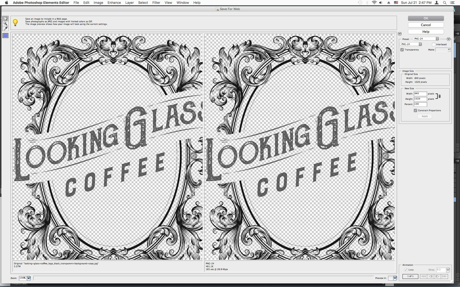

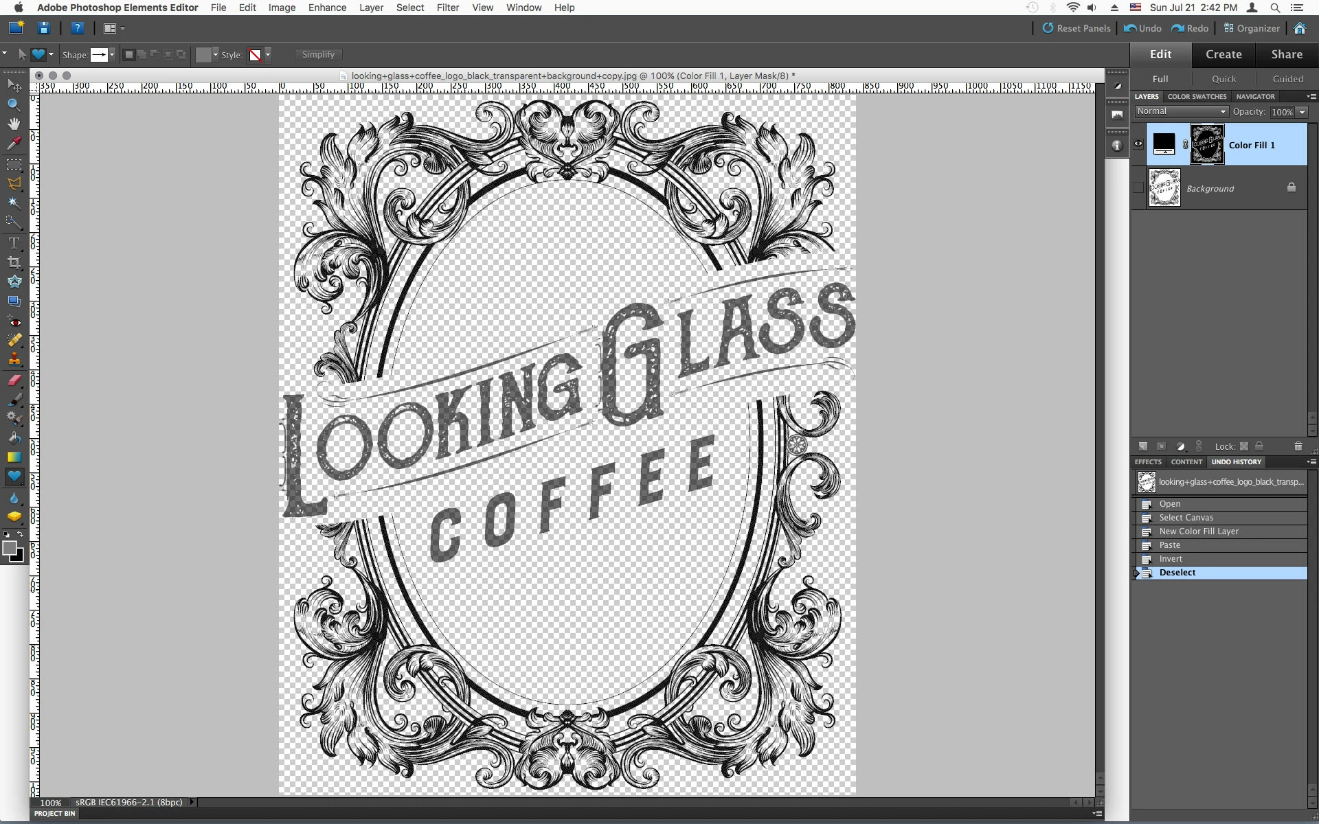

    If you want actually remove the white background, follow these steps
    1. Go to Select>All
    2. Edit>Copy
    3. Go to Layer>New Fill Layer>Solid Color and set the color to Black
    4. Alt or Option click on the layer mask and go to Edit>Paste
    5. Click Command+i or Ctrl+i to invert the layer mask.
    6. Click on the Eye to turn off visibility of the Background Layer to see the transparency.
    Then you can use File>Save for Web and use PNG-24 to save your transparent image.
