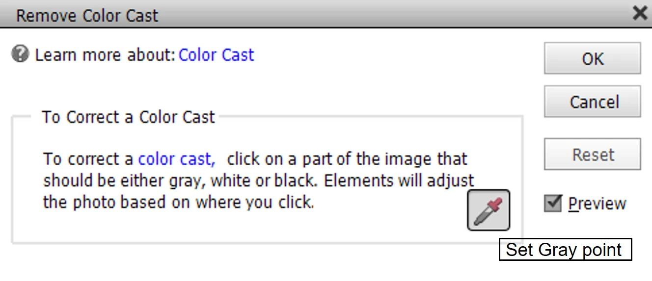

Remove color cast
I recently acquired PE 2021 and everything in the "Photo Editor" zone works normally except that "Remove color cast" doesn't work at all.  I have opened a number of  JPEGs with a distinct color cast and clicked on an area that should be white and nothing changes at all. All other "Enhance" functions (brightness/contrast/hue/saturation/color curves etc) make changes to the image as expected. Am I missing some step? Holding down "Alt" or "Ctrl" while clicking on the desired area makes no difference.
My PE was downloaded from Adobe and properly registered. Any suggestions? Is this a known problem?

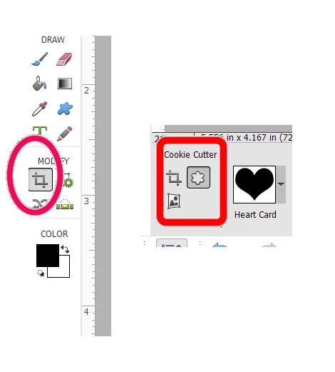

As for the Crop tool, it is in the same place it has always been.  Perhaps, you have used one of the related tools and the icon showing in the tool bar has changed to e.g. the Cookie cutter tool.

I tried re-setting "preferences" as someone suggested, although I don't quite understand why there should be a "preference" setting that says "I don't want this tool to work when I click it". Anyway, it made no difference, the color cast tool still does nothing on any image I've tried and I noticed that when I click the eyedropper icon on the "remove color cast" pop-up notice, a "Set grey point" message appears briefly and can't be cycled through "set white point" or "set black point".

You haven't told us exactly how you are using the Remove Color Cast tool.  If the eyedropper tool is indeed doing absolutely nothing, then it may need to be reset.  (I'm guessing that when you reinstalled the program, you chose not to delete the preferences file when you uninstalled the program.)  Go to Edit>Preferences>General tab and click the Reset Preferences on next launch button.  Close and open the program again and see if that makes a difference to the operation of the tool.

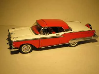

As you already know, the tool tells you to click the eyedropper on a part of the image that is either black, white or grey.  I think this is slightly misleading because you really need to click on a pixel that should be black, white or grey.  On a low resolution image, this is not as easy as it sounds.  So, I suggest zooming into pixel level to get the best match.  Here is a portion of the hood/bonnet of the car that I'm assuming should be white.  It obviously has a yellow cast to it.  But you will also see that there are various shades of yellow. It is necessary to find the lightest shade to get as close as you can to a true white.
Clicking on the darker shades of yellow will give an inaccurate result.  The same is true for the darker/black shades of the image:
Even though you may think you are clicking on a black area of the image, you may be clicking on pixels that are much lighter than true black.

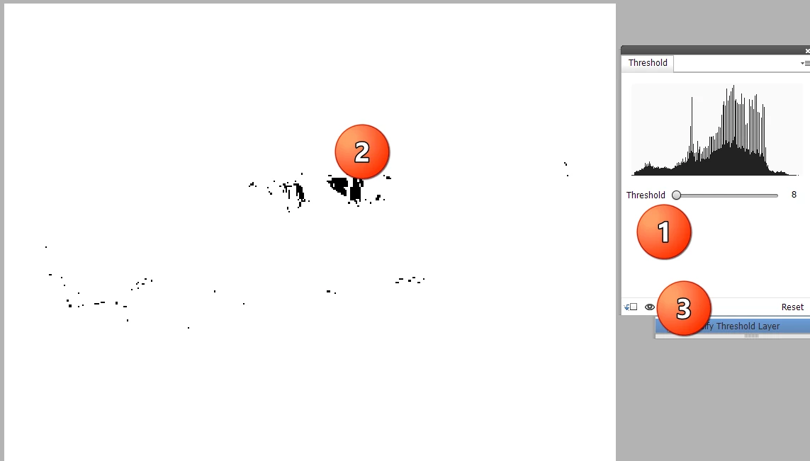

Here is another tip for finding the blacks and whites in an image.  Go to Layer>New Adjustment Layer>Threshold and click OK.
        1.    In the dialog that opens, move the slider all the way to the left and the image will turn completely white.
        2.     Move the slider to the right gradually and the blackest areas of the photo will appear.
        3.     Click on the preview eyeball to see the photo image in color.  This will help you find the blackest areas of the photo and you can then delete the threshold layer.
You can do the same with the whitest areas of the photo by moving the slider all the way to the right and gradually moving it left.

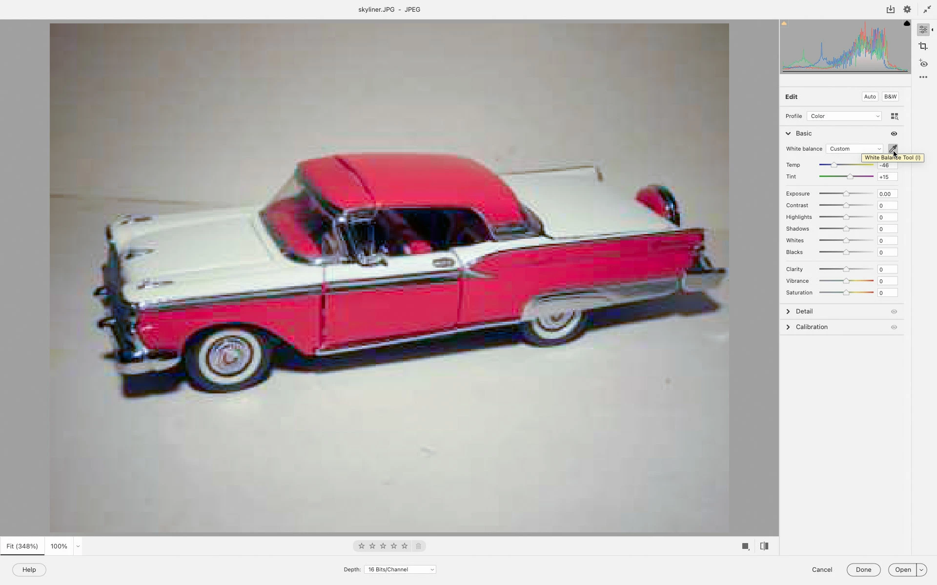

Jul 23, 2022 7:45 PM UTC
Another option is to open the image in camera raw and use the White Balance Tool
(File>Open in Camera Raw)

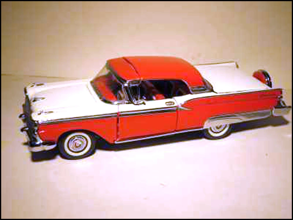

Oh dear. Yes, I am back. As advised by Adobe I uninstalled Elements and dowloaded and activated a new version. Photo Editor is now working normally - but the color cast removal eyedropper still does absolutely nothing.
Someone asked to see a specimen image. Here is the image that caused the trouble. Normally I would click on a whitewall tyre and the image would be instantly transformed but in this case it had no effect. I opened several other random full-res images of models and deliberately adjusted the hue to give a colour cast, to see if Elements could correct it, but again no luck. The function is simply dead and I can't imagine I've downloaded two copies of Elements with the same unique defect? Bizarre.

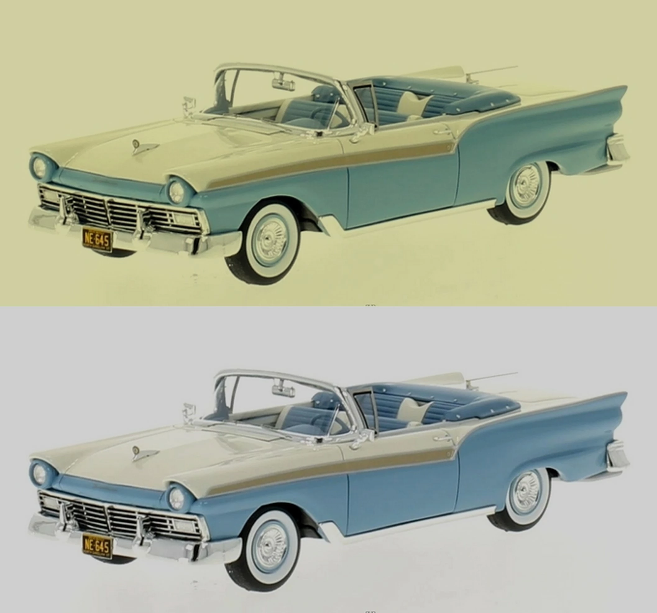

Also attached is a "before and after" shot of a similar image which I successfully corrected just a few weeks ago (so I do know what I'm doing!)
