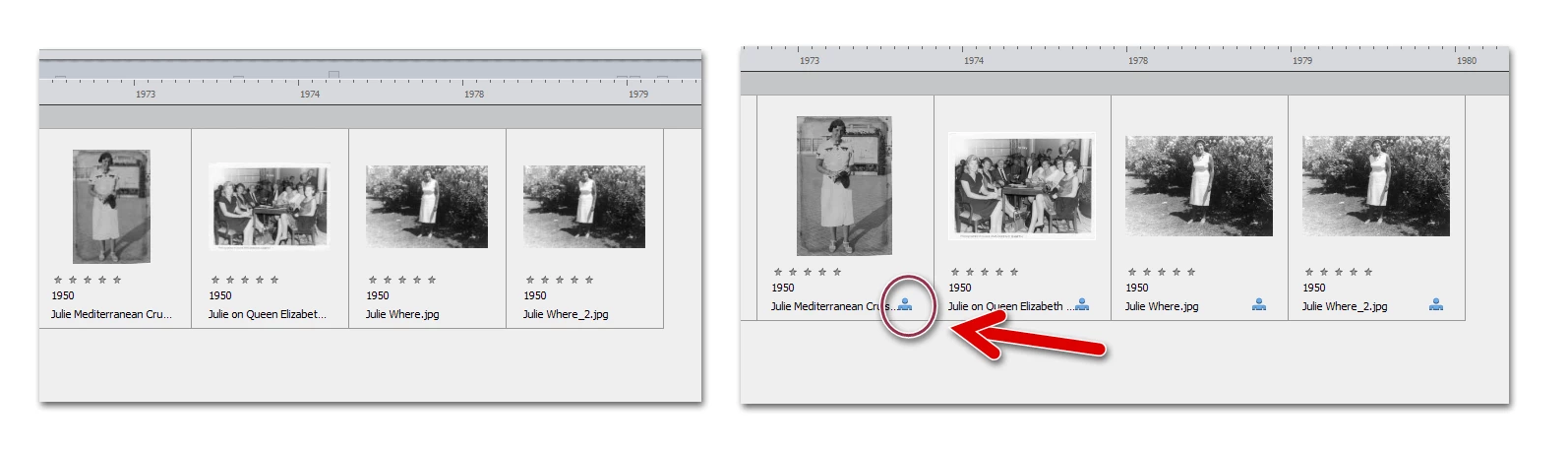

You also have to be zoomed into the grid sufficiently for the People icons to appear in the Details view:

Hi Casey,
Try this:
1. Make sure the View > Details option is turned on.
2. Select the multiple images you want to remove a People tag from.
3. Right-click the People icon on the right-hand side of the details section under one of the images, and click the Remove from name person option that pops-up.
That should remove the People tag from all of the selected images.
Phil Pickering
February 21, 2021
And the same process will work for Events too as I know you were interested in that as well 🙂
