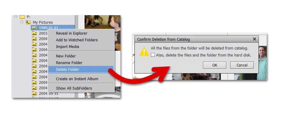

Once you delete all the files from the folder in the catalog, the folder should not appear in the folder list.  Is that what you are trying to accomplish?

Greg, Michael,
Thank you both!  I had done a right-click on the folder, but somehow I just did not see the Delete Folder option.  I appreciate your pointing me back there again.

I was hoping to delete the entire folder, since all its files are displayed with a "?".  The icon next to the folder name is faint.

And while I am here - is there a way to delete folders from the catalog?  That is, I'd like to use folder view on the left to select a folder and say, "Delete from catalog all files in this folder."  (and preferably, all files in this folder and all sub-folders).  Or must I open each folder, select all the files therein and do a delete from catalog?
If you right-click on a folder in the Folders Panel, there is an option to Delete Folder.  I don't think this deletes files from sub-folders.  So, you have to delete each folder and sub-folder separately.
