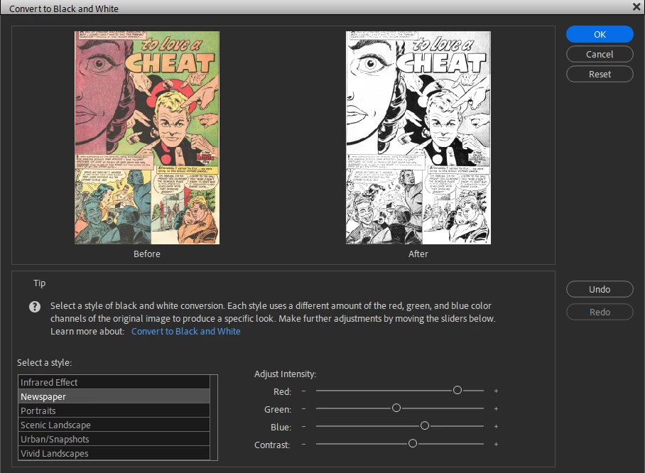

If you just want to create a line art page with your sample, I think the best option is to use the Enhance>Convert to Black and White tool.  Using the Newspaper style option and making a few adjustments with the sliders, here is what I achieved:
But I'm not sure that is the best way to replace the colors since you will no longer have a color to replace.

Thanks. I did try the infrared choice achieved a sort of result I liked. I will also try newspapers as you did. My next step will be to save the result as not a psd but a jpg. And then bring it back into Elements. A friend shared with me a how to video using full photoshop. I did review the video you linked. I am not sure color replacement is as simple as this video that is also out there. This is quite deceptive in termd of it's simplicity.
