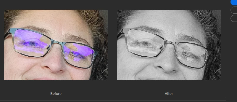

  • First, I converted the image to black & white, using the Enhance>Convert to Black and White dialog:

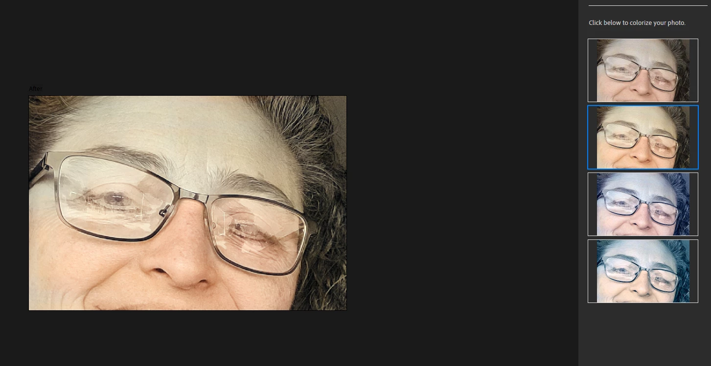

  • Next, I used the Enhance>Colorize Photo menu to restore the color:

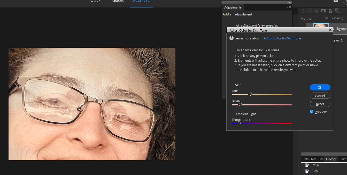

  • Finally, I used the Enhance>Adjust Color>Adjust Color for Skin Tone dialog to even out the different shades of skin and make the forehead more natural:
Hope this helps.
