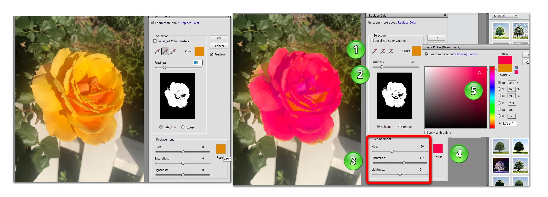

First, make sure that your duplicate layer is selected before opening the replace color tool. Then:
  1. Use the eyedropper tools to select the color you want to change (yellow).
  2. Use the fuzziness slider to adjust the selection.
  3. Use the Hue, Saturation and Lightness sliders to change the color; OR
  4. Use the Color Picker box and
  5. Find the right color.
maryh32992214
June 8, 2020
Greg, your answer did not solve my problem.  I had done everything precisely as you described, but all I could do was use hue (and I got orange roses), picker did not work to change the yellow rose color at all, to any color.  I need red or pink.
