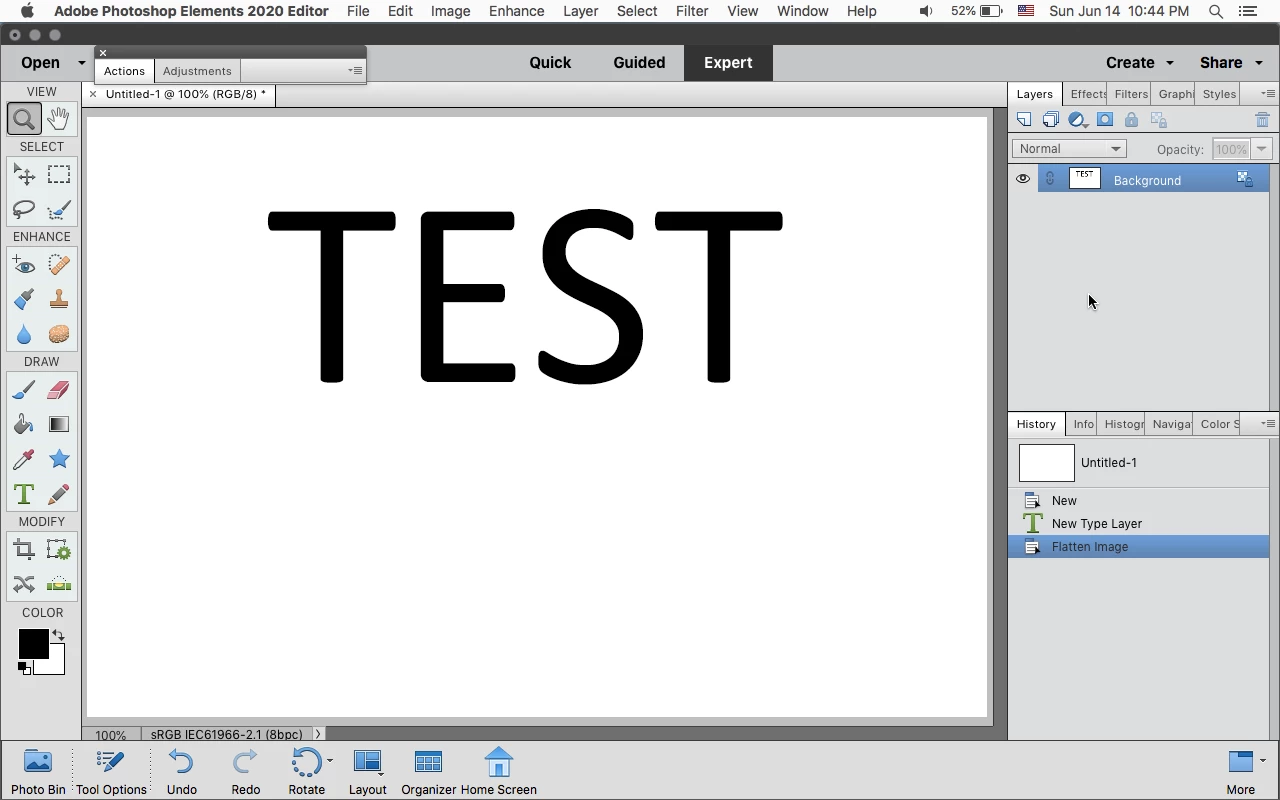

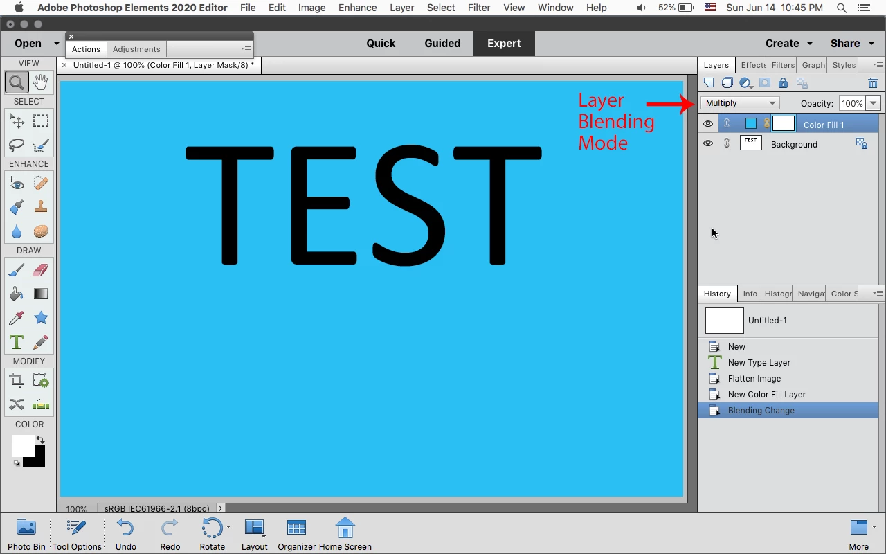

Jeff Arola
Jun 15, 2020 2:59 AM UTC
An easier way would be to put a Layer>New Fill Layer>Solid Color above the text and change the layer blend mode to Multiply.

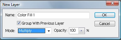

4. Then Layer>New Fill Layer>Solid Color and in the dialog
    choose group with previous and multiply for the blend mode.
5. Pick your color from the color picker and click ok.

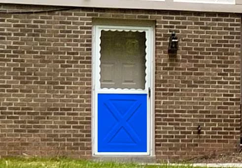

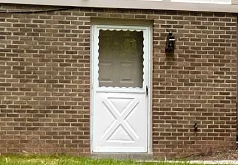

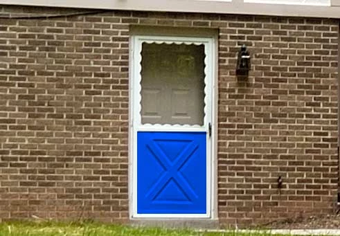

Before
After
