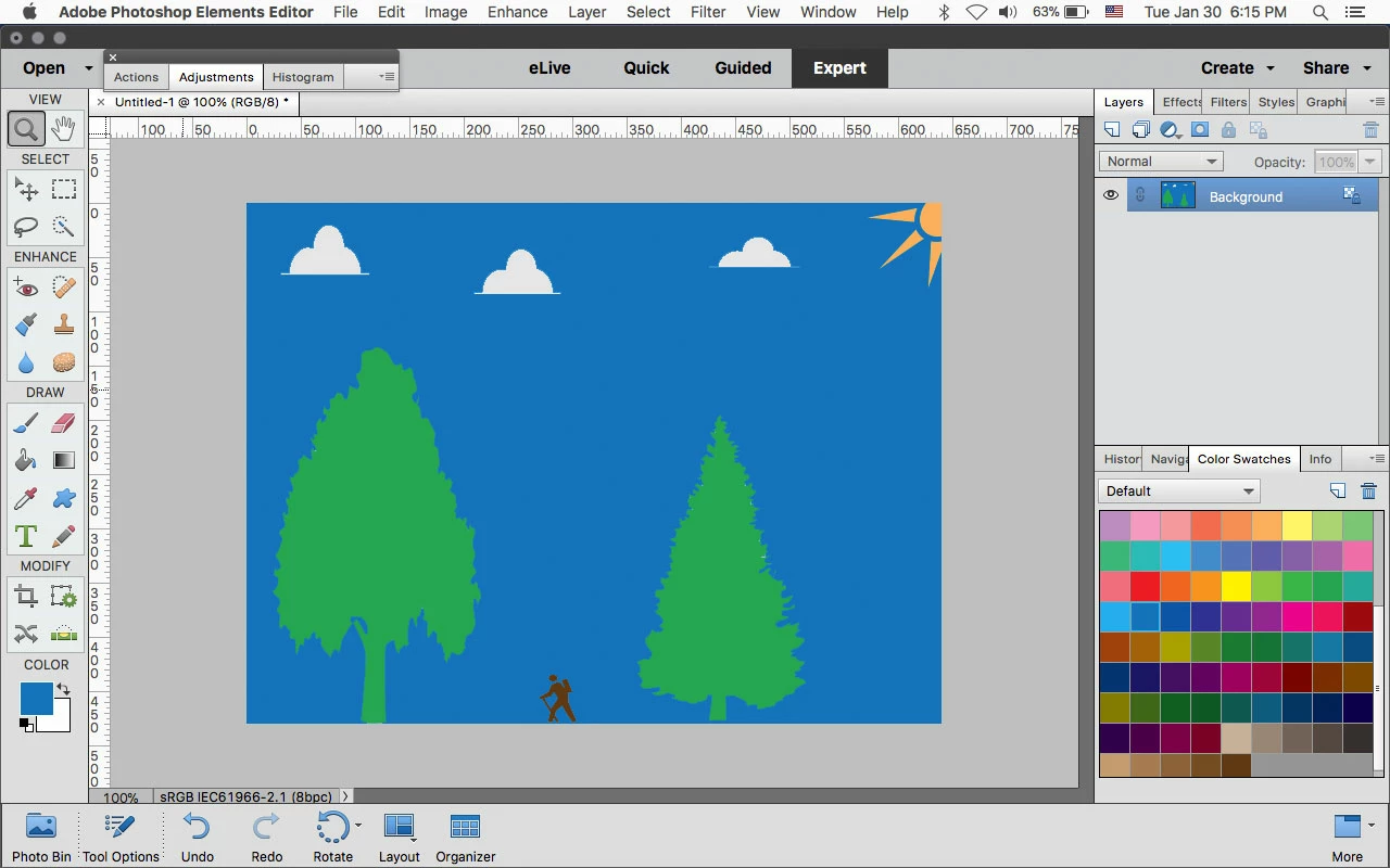

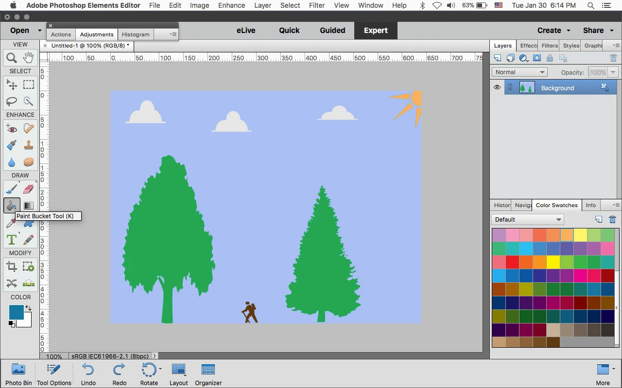

    Maybe what your looking for is called the Paint Bucket Tool in pse 15.
    In the Expert mode you'll see the Paint Bucket Tool in the tools panel.
    before
    after
    https://helpx.adobe.com/photoshop-elements/using/fills-strokes.html
    https://helpx.adobe.com/photoshop-elements/using/tools.html
