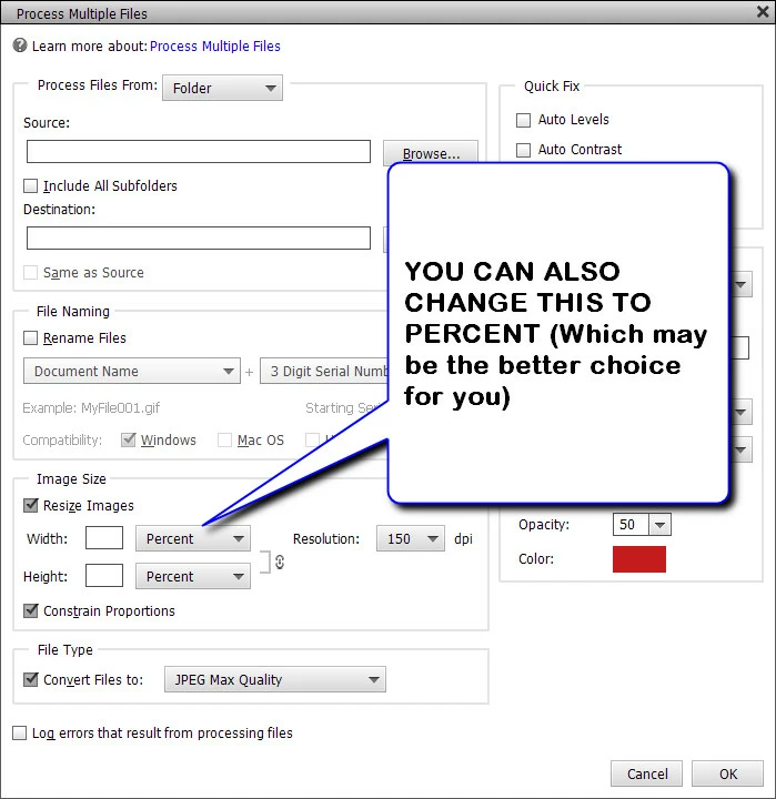

ElaineNewYork
November 5, 2021
Thank you so much for the thorough responses, and especially the illustrations. That was really helpful. Regarding the Image Size option and the second illustrated image (using percent instead of resolution), how do I know what percent to set? What is the ideal setting to keep the file sharp but under 1 MB in size, which is what WordPress says I have to keep the file size under to load quickly. Thanks again!

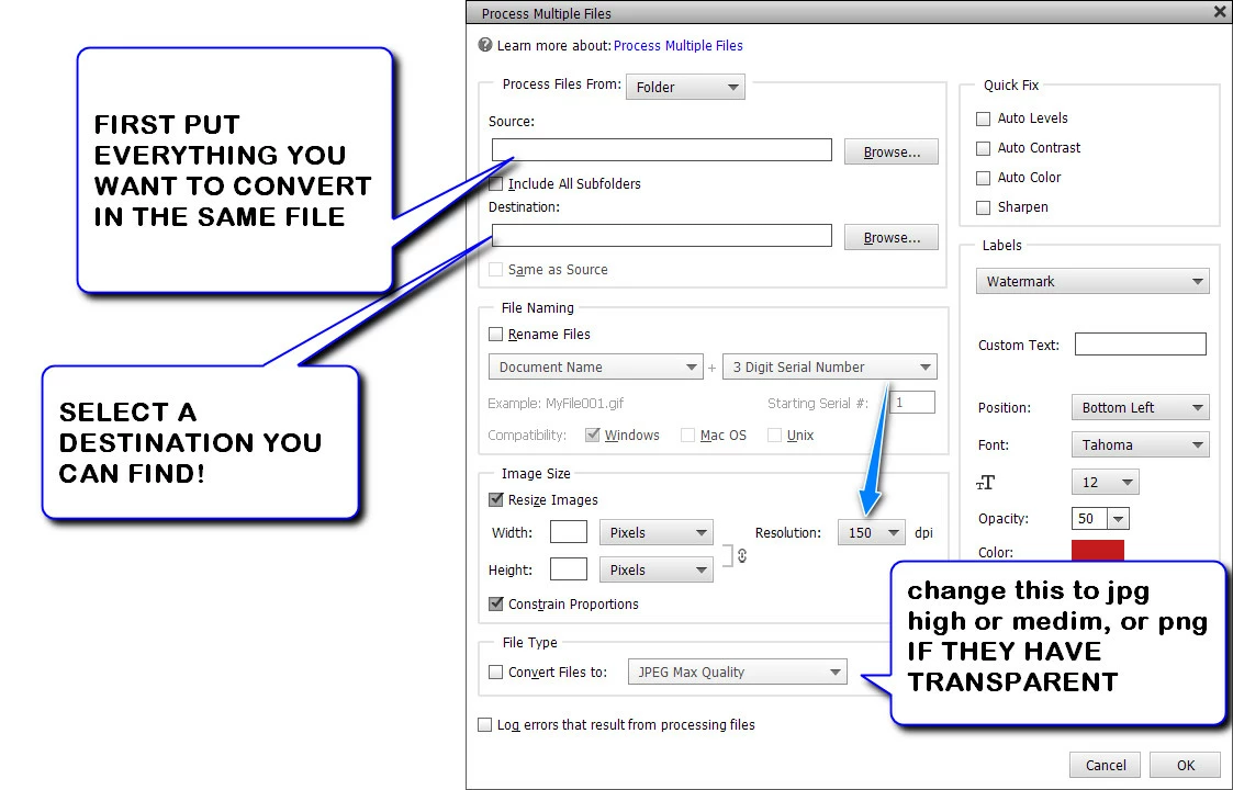

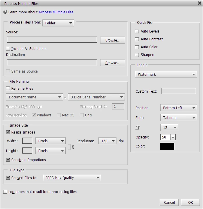

Elaine,
The PSE 2020 Process Multiple Files window is identical to what Glenn shows in his PSE 2022 example. Just try it on a few files first to see if the result is what you need!

Glenn 8675309
October 12, 2021
I used to resize thousands of images, using the batch processing.  The following is from PSE 2022.
Changing the size: Yes select  the size of output you want, all the files will be that size once converted- but more importantly drop the ppi to either 72 or 96 ppi, and save using a medium quality (or higher).  Anything above 90 ppi for online use is overkill.
IN YOUR CASE:  LOOK AT THE SECOND IMAGE FIRST!
