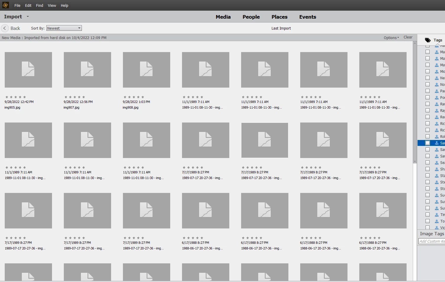

Scanned images won't import to PE Organizer
After scanning slides to JPEGS, Organizer imports the images as broken links. Other scanned prints import normally. All files are JPEGS; why won't scanned slides import?

The resolution of your images probably exceeds the maximum size to display thumbnails in the Organizer.  If you are comfortable editing the registry, there are instructions in the linked article to fix this problem.
The files may open OK in the Editor if they do not exceed 30k px on either side.  You can then resize them.  Or you can use the Editor's File>Process Multiple Files dialog to batch resize the files.

Exactly what I needed to know - Thank You!
I'm always a little nervous editing the registry - though I don't often
need to do it - but I can, and I will.
