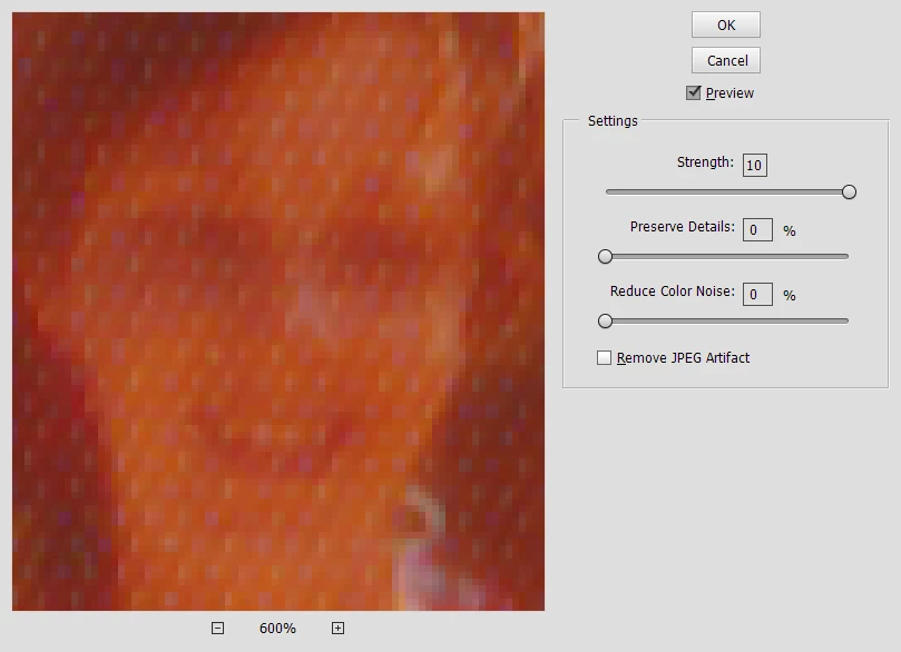

I have scanned some 1970s photos whoich were printed on a "satin finish" paper. The texture shows up as a tiny repeat pattern all over the image. Is htere any technique I could try to remove this?  I can reduce it a bit with the noise filter but this also ermoves much of hte detail. I would like to get rid of more if at all possible without losing the actual detail.

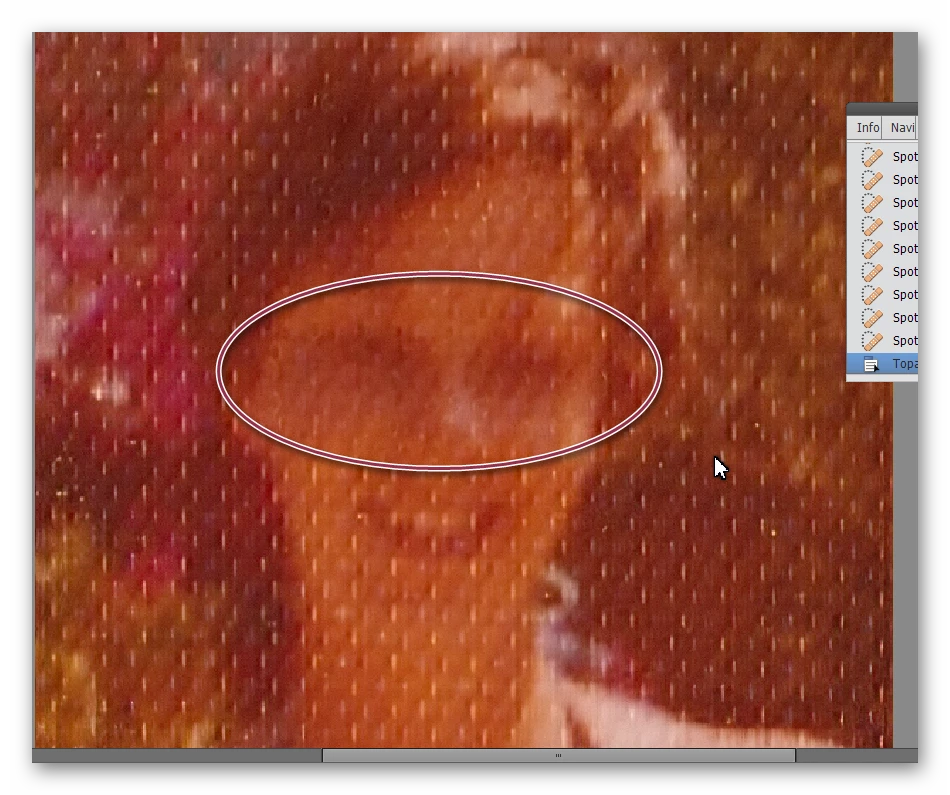

Your sample is such a low resolution with very little detail that I don't think there is much you can do with it.  I tried a painstaking task of using the spot healing tool to remove the light dots around the eyes and came up with the following result. Obviously, you are going to lose some more resolution even using a sharpening tool.  (I used a plug-in to try to sharpen the photo, but there is so little detail to begin with that there is not much improvement.  And because I only removed some of the texture, the remaining portion was sharpened and made more visible.) It would take a long time to do each photo methodically.  Do you still have the negatives for the photos?  You would be better off using a negative scanner.
